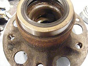

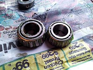

Well I ordered replacement wheel bearings from FCPeuro for a front wheel and both bearings, and even the grease seal are undersized! The old raceways had to be hammered out but the new ones just dropped in and clearly were too small. I don't get how the OD of everything is about 1-2 mm too small yet the ID fits the shaft fine. I went to another supplier down the street and they also gave me undersized bearings. How can my wheel hub be larger then all these bearings?
Anyone have any ideas whats wrong before I throw in the towel and just buy a new hub with bearings installed?
Attached Thumbnails help, front wheel bearings all too small!-20130801_194425small.jpg

Yes this is what is so odd. inner bearings, outer bearings, even the wheel seal are too small. I don't know if the coupe has different bearings, maybe I should have just ordered the dealer supplied parts.

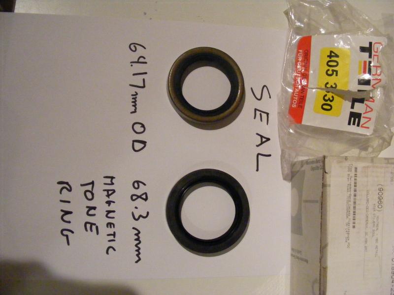

happened to me too! Your parts supplier clearly made an error. I took photos and measurements of mine and sent it to parts supplier. He did apologise amd refund me and did not even ask for them back. I needed get the car back on the road so I got the bearing from the dealer.
this is what I sent the supplier
I would like to inform you of incorrect parts#405-330 ordered via your site for my 2005 C240 base sedan.
The bearing kit is incorrect and does not fit.
1: the outer bearing measures 21.4mm ID while the shaft and old bearing is 22mm
2: the inner seal as you can see from the picture is also incorrect and is also missing the magnetic ABS ring to activate the sensor.
Please advise.. I do wish to return for refund. Do you have the correct parts?
I believe it may be: W0133-1716783
Attached Thumbnails help, front wheel bearings all too small!-c240-front-brg-old-vs-new.jpg   help, front wheel bearings all too small!-bearings-40533-vs-mboem.jpg   help, front wheel bearings all too small!-seals-405330-vs-mboem.jpg

Man! you just described exactly what happened to me. Where do they get their information that this stuff is just almost universal. I couldn't believe that the wheel seal and probabley tone ring was also way too small.

Guys, let's get this one right. PM me or email me your VIN so I can get this corrected. It goes without saying that I will take the incorrect part back and help you get the right one. My email is kyleb@fcpeuro.com

SKF BR17 & BR12 were previously listed as a fit for a number of Mercedes chassis. I've removed those chassis from our fitment guides as they are likely incorrect. The best option is the Mercedes kit which is very complete, inexpensive and pictured below.
