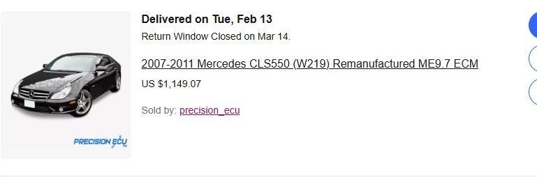

Originally Posted by StevenG214
Where you able to get a pcm rebuild or replacement? Where the codes ever cleared?
Yes, I was able to purchase a remanufactured replacement one in 2024. I got it off ebay for $1,150 from a seller named precision_ecu. So far, it's working great. All error codes are gone and it runs well. When I click the product link in my order on ebay, the product page is missing for the price I paid. Looks like you can now find it here:
2007-2011 Mercedes CLS63 AMG (W219) Remanufactured ME9.7 ECM | eBay
The seller still has a presence. Try contacting them. Good luck
