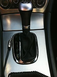

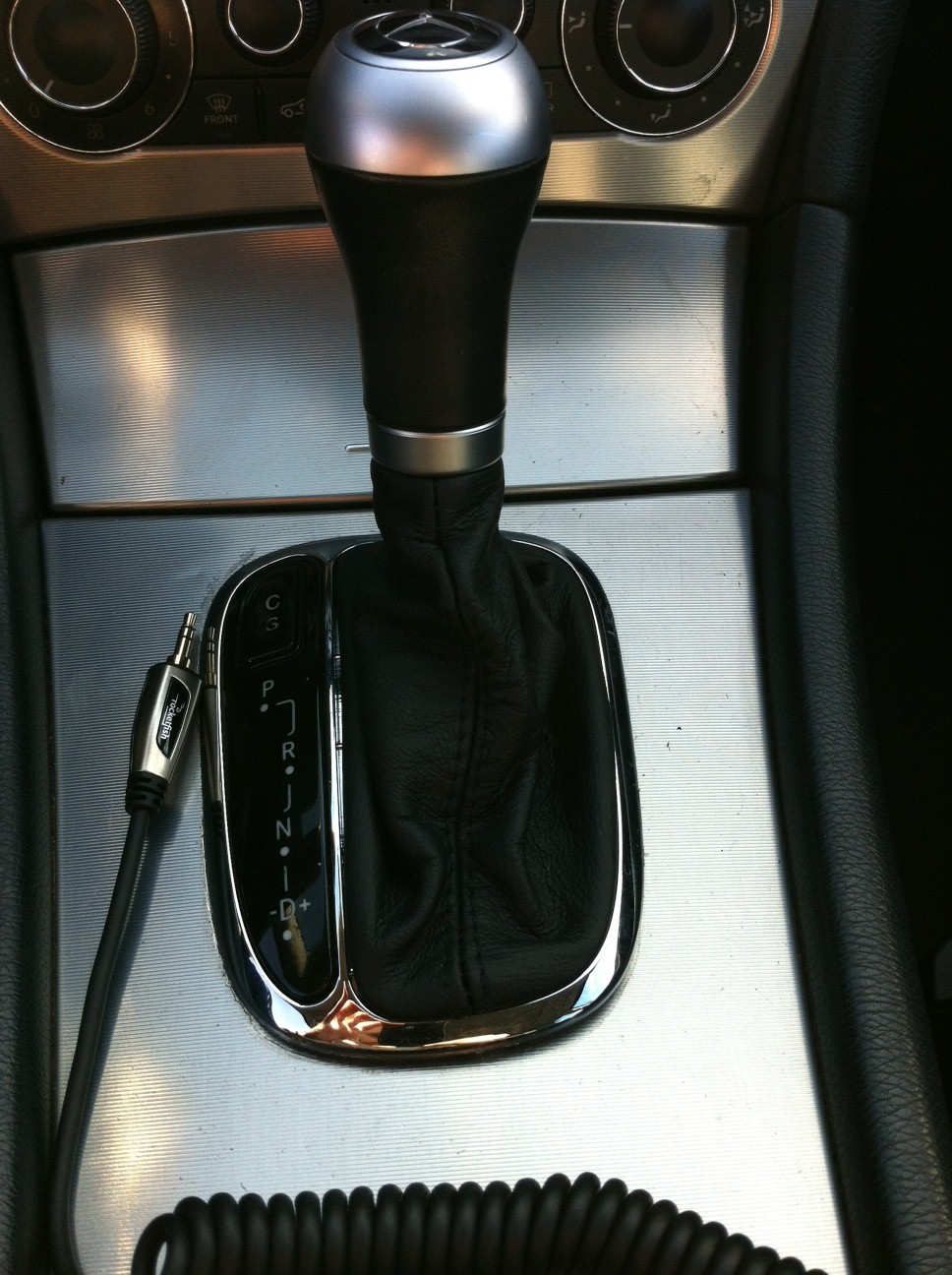

2 DYI's with two stones, actually more like twenty. It's amazing how much IMPORTANT information people leave off when explaining this stuff. I'm going to tell you the stuff no one told me, but I wish they would have b/c it would have saved me HOURS.
1) Replaced the leather boot on the gear shift. You can get a genuine leather, perfect fit for $13 on ebay shipped from the UK. Trick is getting the non-twisting black plastic part off under the silver knob. Pro tip: Go to an automotive shop and get help, if you break it, you're SCREWED. Second tip: You can lift the whole lower console off simply by opening the ashtray cover and pulling the snaps off from there by pinching it firmly and gently lifting it straight up. You do NOT need to disconnect the battery or even unplug the wires for this.
2) Aux. input. I ran it under the passenger floor mat and around the passenger seat. Now I have the option of putting it in the center console or letting it chill on the cup holder. The trick with this one is finding a good male:male audio connector to your $50 OEM cable b/c it effects sound quality- I know b/c I tried 4 diff. ones till I got it right. If you run your cable the same way I did you'll have about one foot left to get to the center console so keep this in mind when getting an audio connector. 6 foot cable is OVERKILL which I of course found out first hand.
