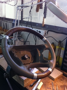

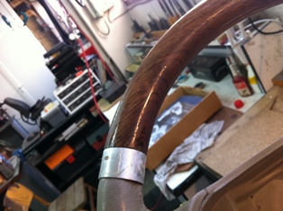

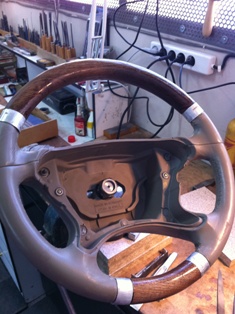

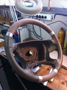

You can do it as a DIY. I have make a wood/leather steering wheel for my W209. It tooks me5 days. First you have to take off the leather and the soft material from where you want to replace with wood. Inside there is a cross shape aluminium cycle. Between the leather and the wood I plece four round pieces from aluminium and I will wrap ther with 3M carbon. The most difficult part was the fabrication of the four wood pieces. I make the 80% of the round shape on a millI and the rest by hand. You must work with no rush at all. I didn't finished it yet because I have no time. Now that you remined it to me I will start again. If I start it now I would have made it flat bottom. More easy and sporty. You can check the only pics I found. If you need any info let me know.

My friend sorry for the spelling. I mean leather. I fabricate the four round wooden pieces from real brul wood. I found an old piece of wood and cut it inorder to make the pieces I need. The feeling of the real wood is fantastic. If you have a friend who is working as a carpenter he will help you.
If you like DIY give it a try.

So did you cut the aluminum core from the steering wheel and then attach the wooden pieces to the core using those cylinders?
Do I understand right that there is no metal reinforcement inside the wooden pieces? (I guess this is probably how OEM wheels are done anyway)

I kept the aluminium OEM cross shape structure and on it i glue the wooden pieces. Nothing has been changed to the inner structure regarding the safety. I only remove the leather section with the soft material that I wanted to replace with wood. With the epoxy glue that I use the pieces had stuck together in one piece. This is the way how all the steering wheel that has real wood are made. Unfortunatly the project has been done one year ago and I didn't keep any other pics. Now I will give it to a pro inorder to lack it. Only on flat bottom steering wheel you have to cut the inner structure.
I found a wooden/leather steering wheel fot 250€, but I wanted to make my custom one the way I like it.
Everything can be done, if you wanted to do it. All you need is time and in some cases money.
