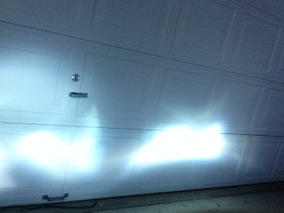

Can anyone give me some ideas on why my newly installed HID lights are uneven? Here's a picture.

Because you don't have projector headlights, like I've posted 3 times now on your threads.

Wouldn't both headlights be like that if I didn't have projectors?

Like he said it is because you don't have projection headlights. I have the same uneven pattern as your pic with just the standard lens.

If you have projector headlights then something is seriously wrong. First, you wouldn't have needed an HID kit. Second, that looks like HID bulbs inside regular halogen housing. Which projectors do you have?

HID bulbs in halogen housing are actually worse than the stock headlights, both for the driver and oncoming traffic. Because halogen housing is reflecting light, putting in an HID bulb will refract all over the place, blinding oncoming drivers. Blind drivers=crashing into you or someone else. Plus, you won't be able to see as far as the light isn't focused straight ahead.
Projectors take the light from the HID bulb and literally project it forward, In a focused point.
