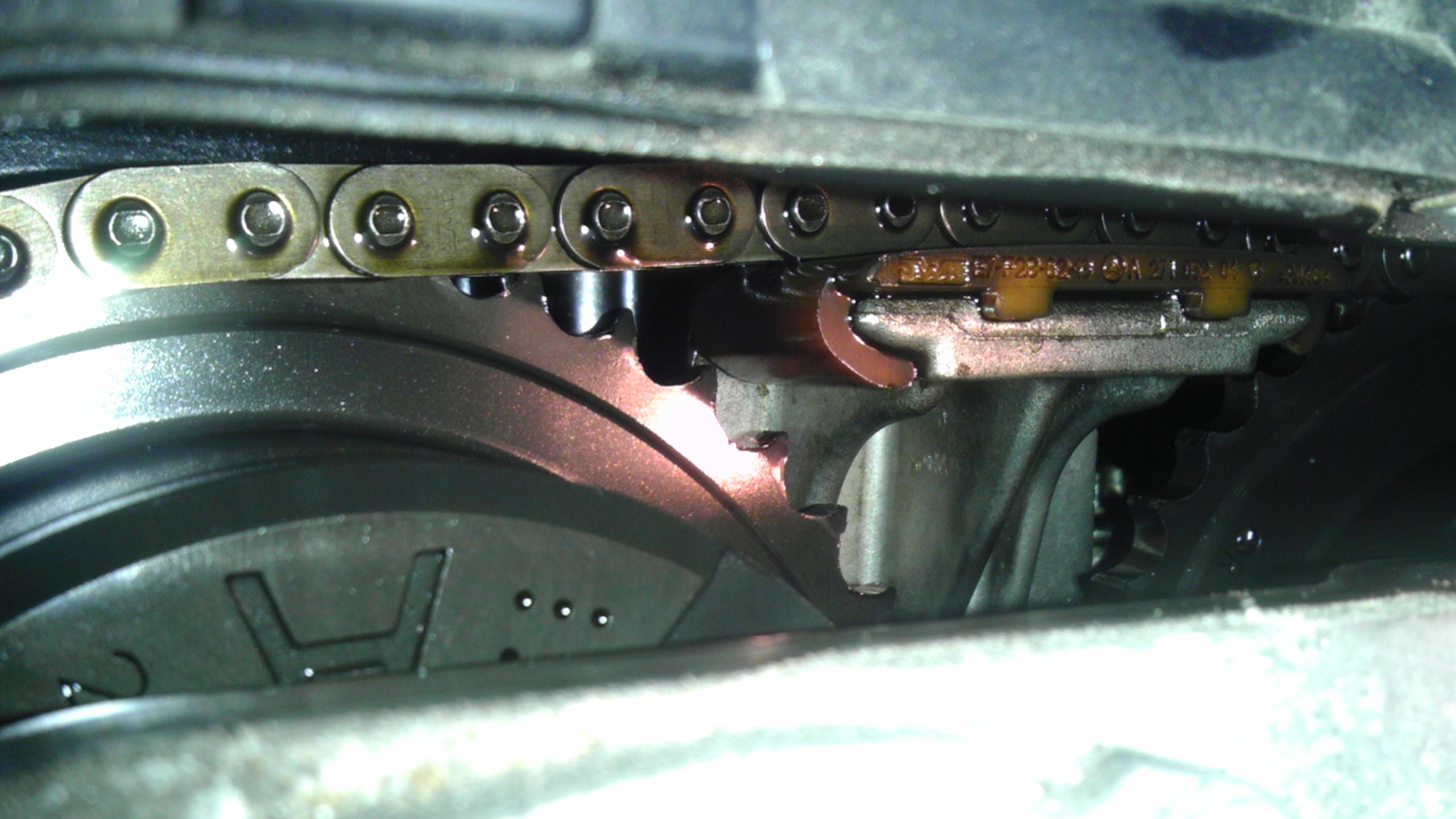

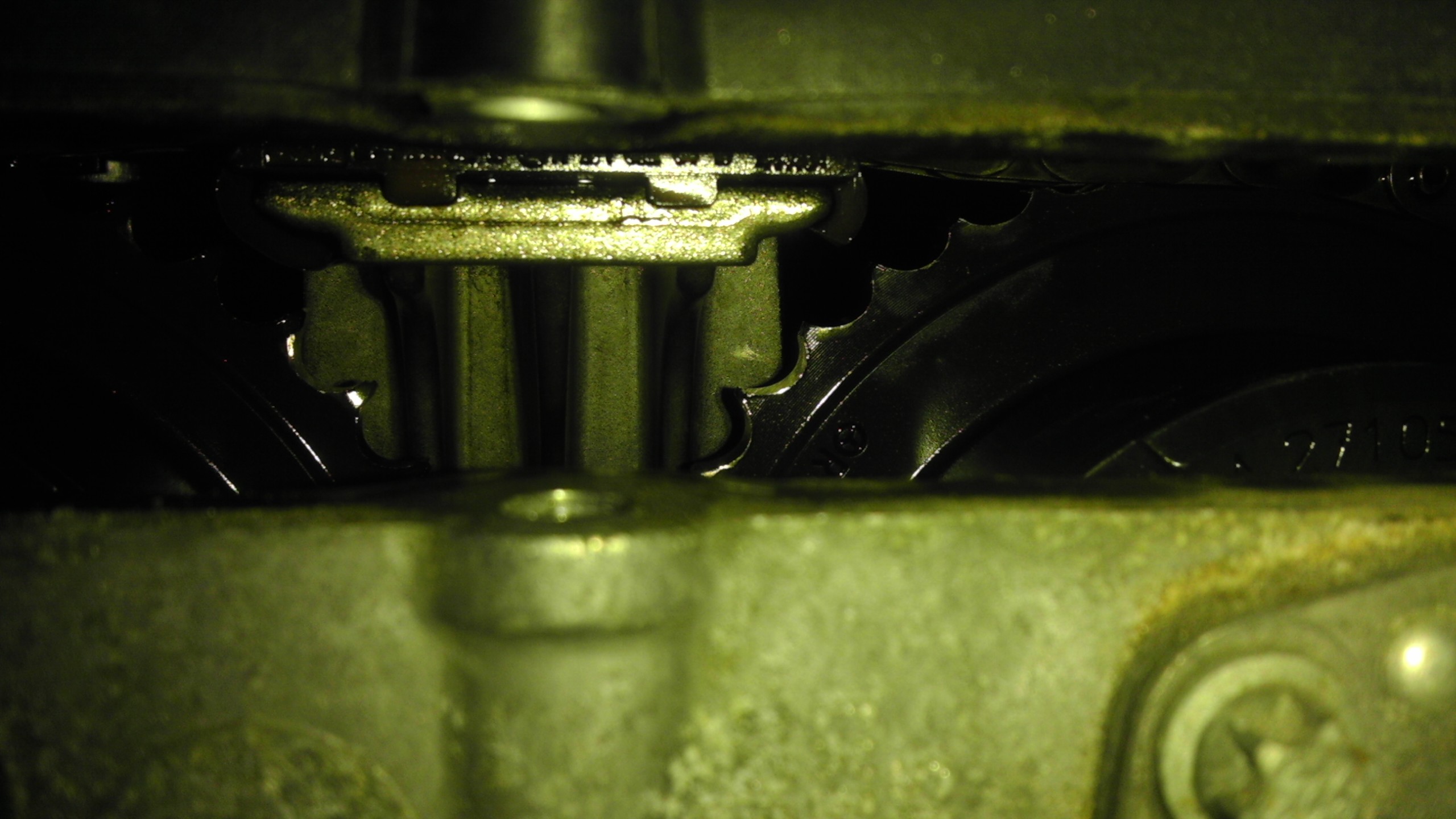

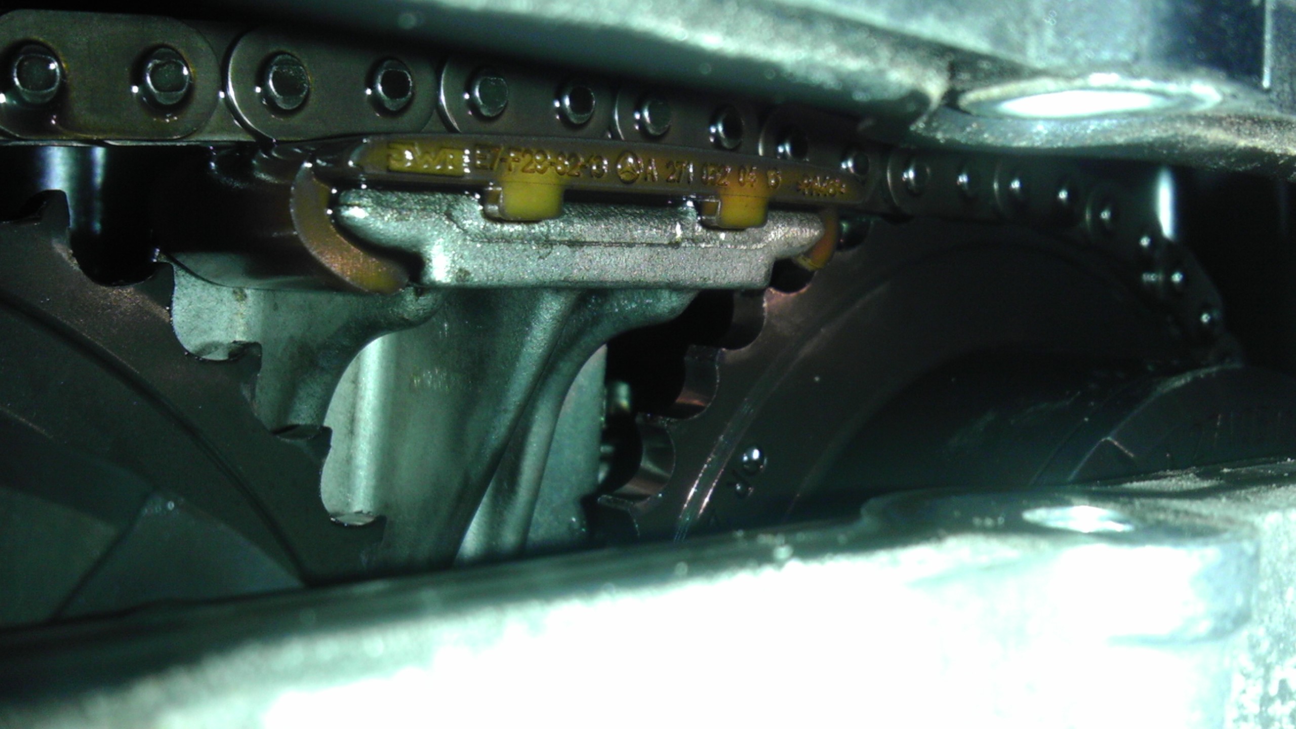

Prior to getting the car towed again, I ended up partially removing the valve cover to get a peek at the timing chain and cam adjuster sprockets. To my surprise, the chain looked fairly tight with no noticeable sag. But then again, it could just be the angle I was looking at it.
What was definitely noticeable, and proof of what the culprit was, turned out to be the cam adjuster sprockets. Specifically, on the intake side. I was
at how badly worn some of the sprockets were!! Definitely noticeable. And some of them were worn down to mere nubs !! I took some pictures, and have included them here, but it looks worse in person.
The sprockets on the exhaust side look perfect however. So just the intake side is in horrendous shape. I think the only way these could get worn so badly would be due to a loose chain. So, despite not noticing any sag on the chain, it definitely has to be there for it to cause as much wearing on the intake sprockets as I noticed.
The car was towed last Thursday (8/14/14). I haven't spoken with the shop yet, but my understanding is that he does take his time.
He did mention that he's going to give the donor engine a good once over. But I'm not sure if there's anything specific I should mention that he should be on the lookout for that should be checked out. He did say that he can't really replace parts because this will void the warranty that's on the engine from the bone yard he purchased it from. I guess the 1 year warranty gives me some comfort there if anything should go wrong.
Enjoy the pictures.
- First pic - note the lack of any sag in the chain. I wasn't able to lift on the chain so there is likely some significant looseness in it.
- Remaining pics - note how worn the sprockets are on the intake side, but on the exhaust side they look sharp and pointy.
Any comments are definitely welcome.

Ok, so my speculation about the sprockets was kind of right.
And to see the chain stretch you need to feel it on the tensioner side, because on top it's always tight like that afaik.
I think you made the right decision with the new engine. That sprocket itself is like $1k.
However, the new one might be a bomb with partially-worn chain/sprockets.
You're probably ok if you want to sell it before the warranty on the engine is up...
BTW, see your original CEL code - intake cam sensor. The teeth sheared, the chain skipped some teeth but [maybe] remained in tension, so you might only have the intake valves bent actually...

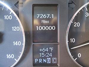

The nearly 4 month ordeal is finally over...I was able to pick up my car 2 days ago, and everything is finally all set. The headlight issue was again the inclination sensor on the front that went bad. He ended up replacing it for me.
All-in-all, a torturous experience I hope to never again go thru with any of my cars, now and in the future.
On a good note I reached a nice milestone yesterday afternoon....Took 4 months longer and about USD $3700.00 in order to reach it, but nonetheless....
Enjoy
