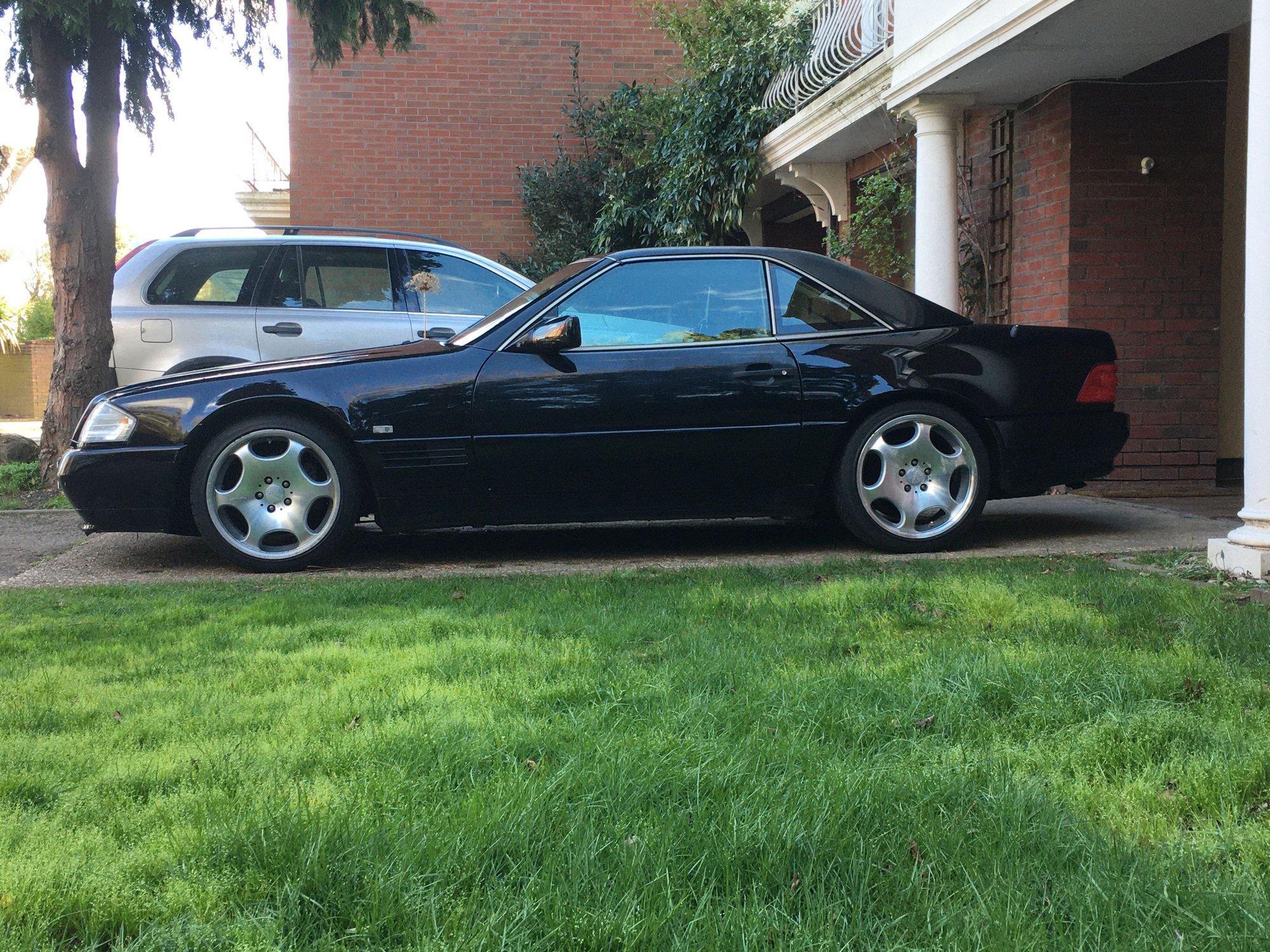

Hi all,
Carlsson 1/6 Diamond Ed. in ET40 (8,5x18)
Here with 20mm & 25mm H&R
PS: my 1st post here so thanks to all on this forum.
C.
