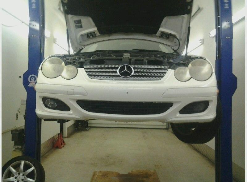

Hi Ya'll, this little marshmallow is in need of some TLC. I picked him up this weekend, in the dark no less, and decided that if he gave me too much trouble, he might bring more than the $3300 I gave for him. He's having his rotors turned and a pad check now, but then we must get him some vision help. What would you do with these headlights? Has anyone had any luck having them polished? Thanks!

Personally would try myself to polish as others here have done. Try the search function.
But you could try a detailing shop or good auto body shop and inquire about getting your lights buffed.
FYI, turning rotors is not the best idea as it removes mass from the rotor used to bleed off heat. If this was just to remove rust from the surface then you should be okay.
New rotors for your car would not be that expensive, here in Canada they want about 20 bucks a rotor to turn, aftermarkets are fine also and will work just the same.
Enjoy the new car.

I periodically polish them with 1200 grit emery cloth,
and then buff with Plast-X.
They sell kits too...basically contain the same stuff.

It could be the fin,, but the check up went BADLY!
Oh boy guyz, now I need a mechanic boyfriend...the estimate today was
l a r g e....yes I paid little for the car, so I knew I would have to dump the wallet, but there sure are discrepancies between mechanics.
Today I was delivered this:
Right Front control arm, right front outer tie rod and alignment- $940.10
(The mechanic Saturday said I needed a left front outer tie rod and alignment)
Then...
Front Brakes(Replacing Rotors, pads and sensors)- $689.20
(The mechanic Saturday turned all four rotors and said the were good, and also said my brake pads were good, and that I just needed a right front sensor)
Dipstick tube seal and transmission connector- $492.72
(To be done with Oil Change- $117.58)
And they want to charge me $153.o2 to Check engine light code for EGR flow, diagnostic needed. The light was on yesterday, but I've run through half a tank of premium, and the light is no longer on. I only told them about.
Saturdays mechanic was a backyard shop, today's was the city Euro shop.
Alrighty experienced Benzo's, is this in line with reality?

Brakes I would wait and see if any wobble develops, then replace (high chance that they are ok and don't need to be replaced at this point). Depends on how well you trust the word of the shady tree mechanic. Though there's no point for him to tell you it's fine when he could have told you to replace the parts IMHO.
But, 2 rotors will run about 300 at a euro shop, plus pads 50-100, so seems like a fair price (you could save by buying your own parts if they allow that).
Since they are not sure about control arms, better to replace both Parts will be ~300 for two control arms at a euro shop(updated this pricing), cheaper if you buy yourself (buy Lemfoerder).
Outer tie rods are something like $50 apiece.
Alignment should cost around 150.
I'd have the backyard mechanic install the parts then have the euro shop perform alignment.
Remind the mechanic that control arm bushing bolts _must_ be tightened with the car at its normal ride height, otherwise the bushings will break pronto.
Not sure about transmission - if they are doing the tranny fluid flush $500 with replacing the connector is about right, if a bit high.
No more CEL - don't waste money on diagnostics.
Good luck.
Even with all this, still not a bad deal for the car

Geez, those be high prices...
Like what we'd pay in San Jose, one of the most expensive places in the country.
I never heard of someone turning their rotors and not replacing the pads.
Huh? Why would anyone do that?
If you get a CEL (check engine light) that goes out, fuggetaboutit!
How can they know you need a $150 diagnostic if they can't even read what the code was?
And front rotors are not $250 for your car, the 2005 coupe didn't have the big brakes of the sedan, unless you added them.
They are probably about 70 each. Stick with the oem ones. Order from http://www.oediscountparts.com
which is actually a dealership in Ashville NC. Tracy, the internet parts person, is real big help with sourcing the right parts. They give a 20-25% discount of msrp on parts.
Most dealers charge over the msrp on parts.
And of course Akebono ceramic pads. Also probably about 60-70 for a set that will last you a 100K miles. So total for parts would be about $200 and labor is about an hour total per axle.
Just checked the price of genuine mercedes rotors on eoparts...link I gave you....
50 bucks each. Free shipping! $800 ? Only if they charge $600 an hour for labor!
With power tools, and a car on a lift I could do the front and rear in about 1 hour.
2034210312 - ROTOR C230
MSRP Core ? Online Price $66.00 $0.00 $49.50
Akebono ceramics are only about $50 too and comes with the sensor.
Total cost would be about $150-160 for parts. Maybe buy the parts and hand them to the shade tree guy, and don't authorize more than a couple hours. Really should be an hour max.
Keep looking around for an honest mechanic, and make sure they have a "Star Diagnostic" computer, which is the special computer for reading errors on mercedes.
Lots of shops who claim to work on MB don't have it, and then they can only guess.
A control rod, tie rod and alignment for a Grand? Wtf are they smoking?
Without even checking the parts prices that can't be more than a few hundred total.
And FYI, the only adjustment they can make on the front end is toe.
It's possible to adjust the camber but no one does it, because it's too much of a hassle.
Any tire shop can do a alignment. In fact maybe get a quote from like the local firestone shop on replacing those suspension components, if they even turn out to be bad.
Mechanics love to take advantage of women. Even if you don't have a guy who will work on
your car, try to find a friend to talk to the mechanic and have them show him what and why it needs replacing. When someone with a little car knowledge starts asking the right questions, the prices for repairs will go down.
Print out parts prices from the website i gave you and show them what they parts should cost.
I did that recently and the mechanic dropped the prices on the parts on my GF's ML.
Oh and a brake sensor costs 5 bucks.
Why would it need replacing? Does the dash say you need brakes?
It grinds down with the pads and eventually makes contact with the rotor
and make the light go on. There's only one sensor on one pad on one side of the front.
No sensor for the rear brakes. Even when it goes usually you still have at least a thousand miles to go.
Sorry sounds like both the mechanics you've found so far are idiots.
No one turns rotors and keeps the original pads?
And how much did you pay for this?
Sorry, that was a total waste of money.
I empathize with you, not meaning to sound critical, just pisses me off
when I hear of mechanics doing crap like this.
Rattle around hatch can either be the plastic trim pieces, or the hatch itself.
Hatch itself is easily adjusted, but moving the hasp or the latch by loosening and adjusting the alignment. If it's the plastic trim pieces, for me, I removed them and put stick on felt i got from a lamp shop. Though perhaps some silicone spray might help. Spray around the joints, and wipe off the excess.
Connector on the trans is a $15 part.
Trans fluid change is usually about $200-300.
MAKE SURE they use the correct fluid, which is Mercedes ATF134.
Anything else and you'll be back in the shop for a new trans.
Assuming this is an auto.
Dipstick seal? Like on the dipstick or the tube?
Never heard of that being an issue, though I replaced the one on my dipstick.

Hi guys,
I've interviewed two mechanics in my little town, one has worked on my cars for ten years, and he is going to do my suspension work and alignment for labor only, letting me supply the parts. The other has the star diagnostic computer and much MB experience, and he will handle the big stuff.
A new lower left control arm goes in tomorrow, I found it for $50 less than the mechanic, and we'll go from there. He thinks the Euro Shop was trying to wring me out... his guys polished my headlights yesterday and they did an amazing job! Check it out!...

Good job, Can you imagine how much the previous owner would have wanted if it looked this good.

I've turned the corner... I'm in love with the marshmallow. The replacement of the control arm and the alignment changed my whole driving experience. ($140) Now he's getting really fun! So my mechanic said there was no problem with my tie rods! And he thought the rotors and brakes were fine. He drove it as well. Truly these mechanics have vast differences in experience... He stuffed a rubber hose part between the plastic under the fin where it meets the hatchback and stopped the chatter. Next week, oily parts. I have a periodic oil smell coming into the cab. I saw a leak around a screw when it was on the lift, but this will be done by the star diagnostic guy. I may just do the tranny work at the same time and get it over with. Because then I can get on to the interior!
He seemed to think that I didn't need shocks or struts... it's a rougher ride than my Ford Explorer.. and he told me that its because its a different animal. I thought it would be smooth by the nature of it being a Mercedes. How's the ride for you guys?
