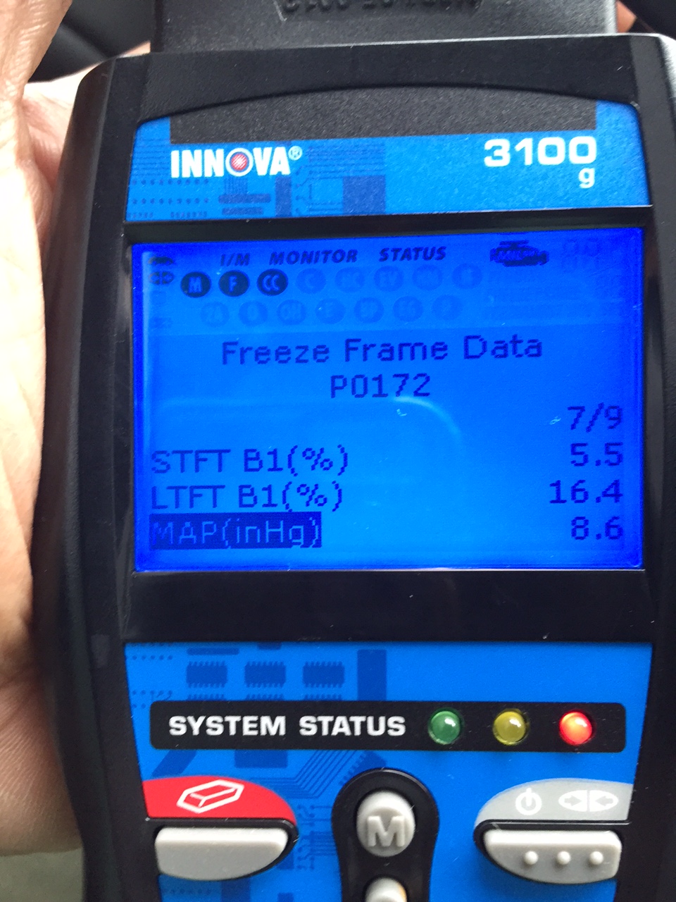

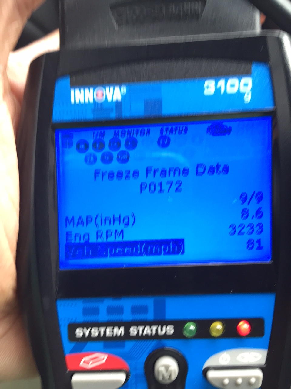

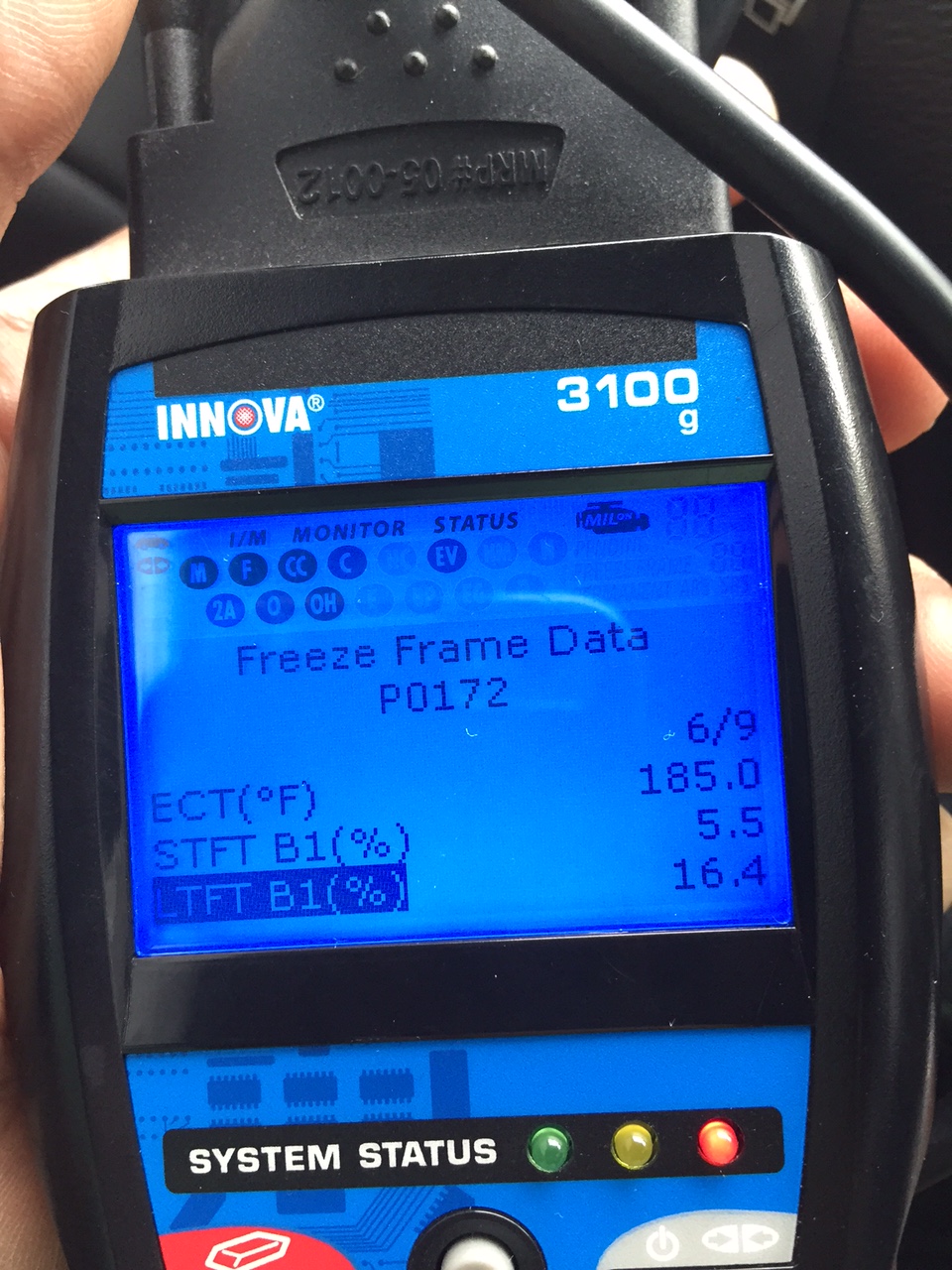

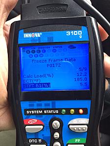

I took my 03 m271 to the dealer for a diagnostic on a check engine light.
Had the p0172 code before and tried a few things to rectify the issue. I cleaned the MAF with the maf spray, cleaned the various electrical connections on the engine with electrical spray, changed spark plugs and valve cover gasket, visually inspected the vac hose in engine bay (no tears)and replaced the O2 sensor (upstream).
They said the "cause" with a leaking intercooler hose(passenger side) so we replaced it few days ago even though we noticed no tears, reset the ecu as instructed and drove about 70 miles. Today, the same p0172 code came back with the check engine light. So I figured this is somehow fuel related and dumped a BG44K fuel injector cleaner in tank, reset ecu, and then drove about 35 miles.
The check engine light returned with the code only after a few miles of driving. The dealer now assumes the O2 sensor but it can't be since it is new (2 weeks old). Attached are the pics of the obd scanner fuel trim readings. It drive fine otherwise. I don't know what to do. DMV inspection due.
PLEASE HELP. thanks guys
