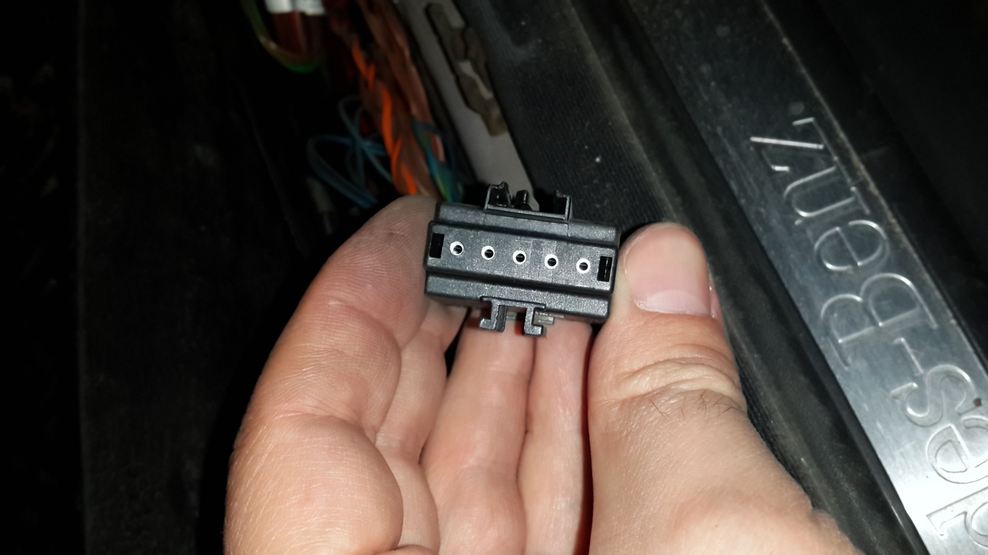

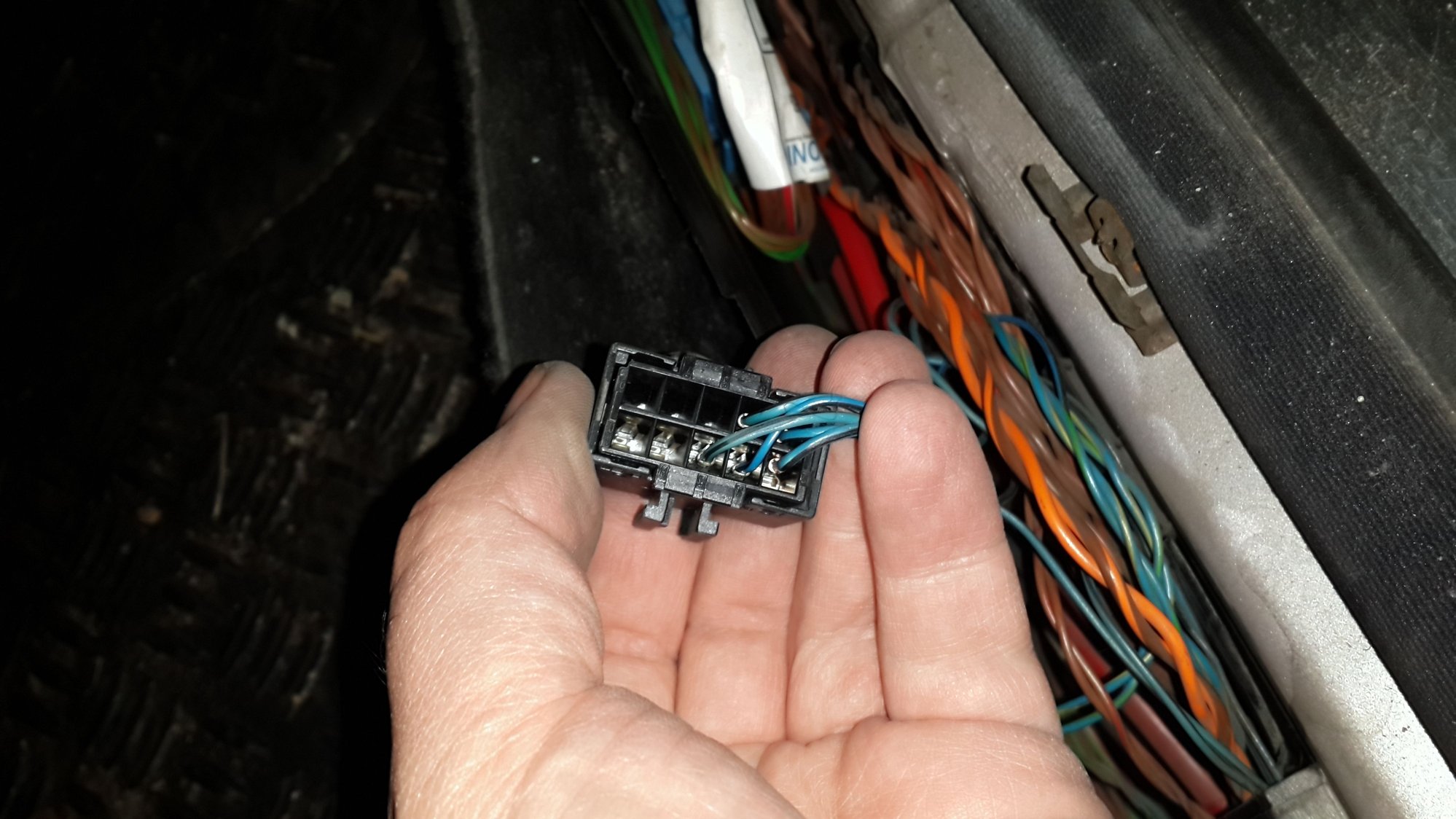

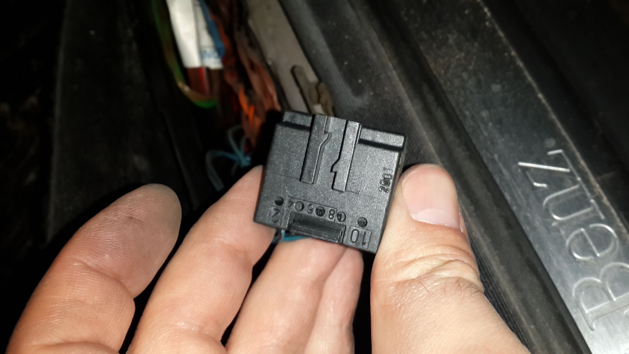

Hello,
Please help to identify what is this?
I have found it at the down of right front door....
Little history: I want to connect my handset/mp3 player to the car in order to listen music via them, so I started to search smth like AUX port...
Mercedes Benz C240 W203 2001
VIN: WDBRF61J62F180129
Thank you.

In case anyone is still interested in know what the plug is,
It's the d2b wake up wire distribution block. Connects the d2b wakeup from the back of the head unit to all the d2b equipment ie. cd changer, bose amp etc.
