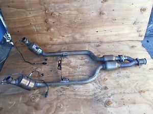

your secondary cats are bad and have come apart.
I just went through this procedure - bought the parts from my local steelership and bolted right up.
the cats come all together with the pipes and it is all bolt on. I had looked around and the local muffler shop wanted 400 to replace just the one bad cat. the steelership charged me 600 for everything but you have to leave a core deposit which brought up the total to $1100. took me about 4 hours to get everything off and on but i did it on my driveway and working on the floor is a PITA.

when replacing you can just remove the sensors from the old to the new.
My car was doing the same exact thing and about 7-10 days of driving like this, the check engine light came on.

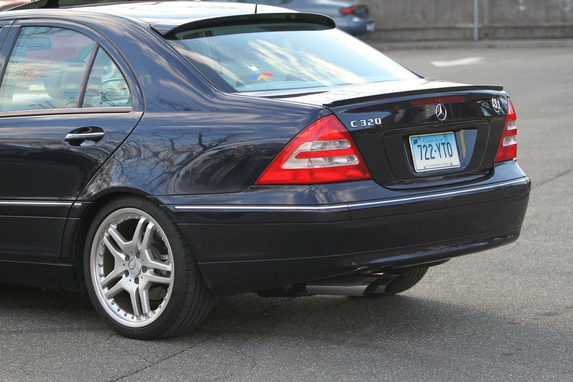

Wow Thank you for the help! I will definitely look into that! Would you recommend replacing them with some aftermarket "High Flow" Cats? Cut corners save a couple dollars? I don't mind the extra labor time. I usually do my own work.. Not sure if you can see my pictures but I added on that muffler which was a hassle because I was dumb and bought a center inlet instead of an offset. Long story short I bought a U pipe cut it up and welded. Thank you for the help! Will waiting for your response!
