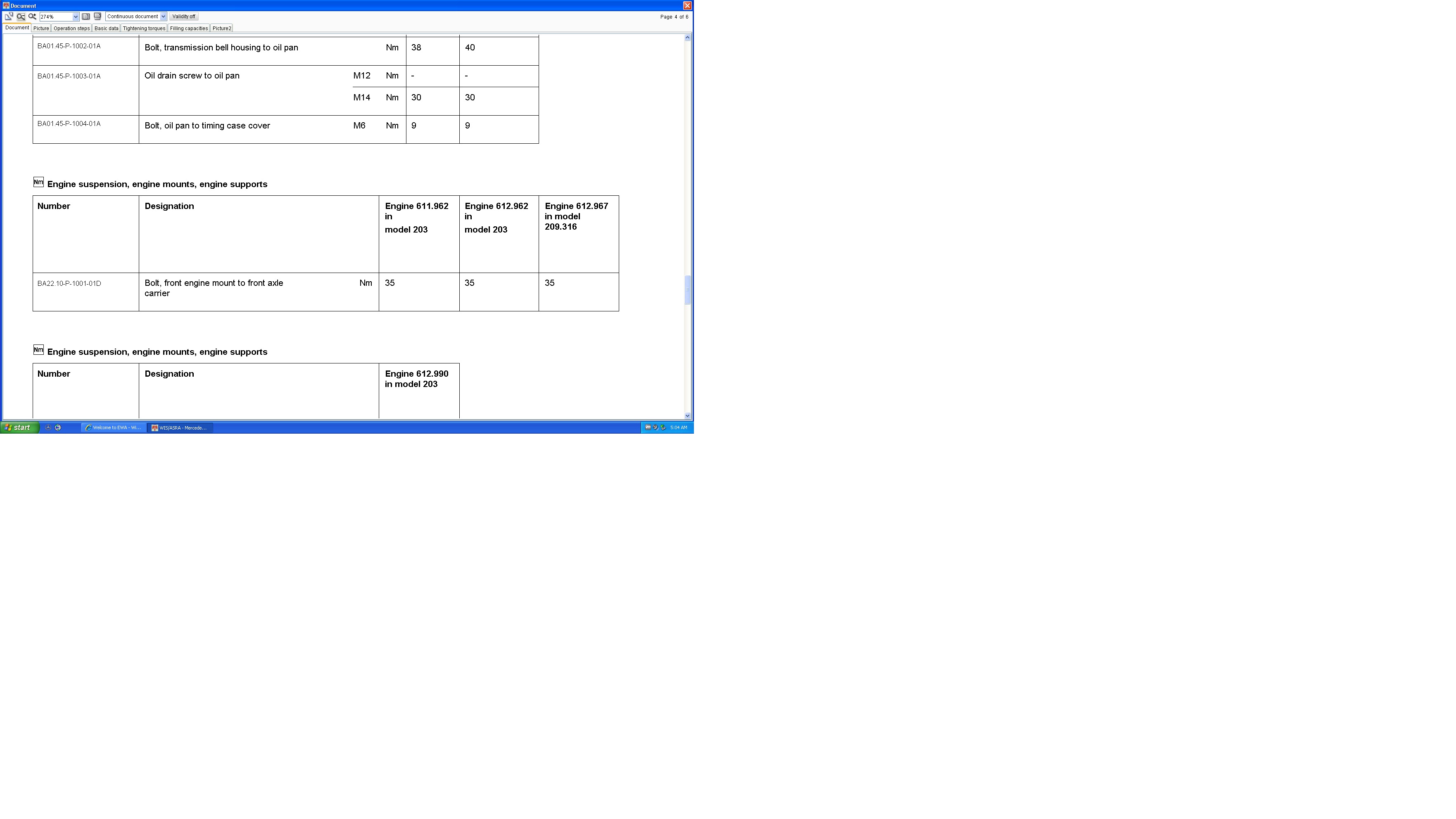

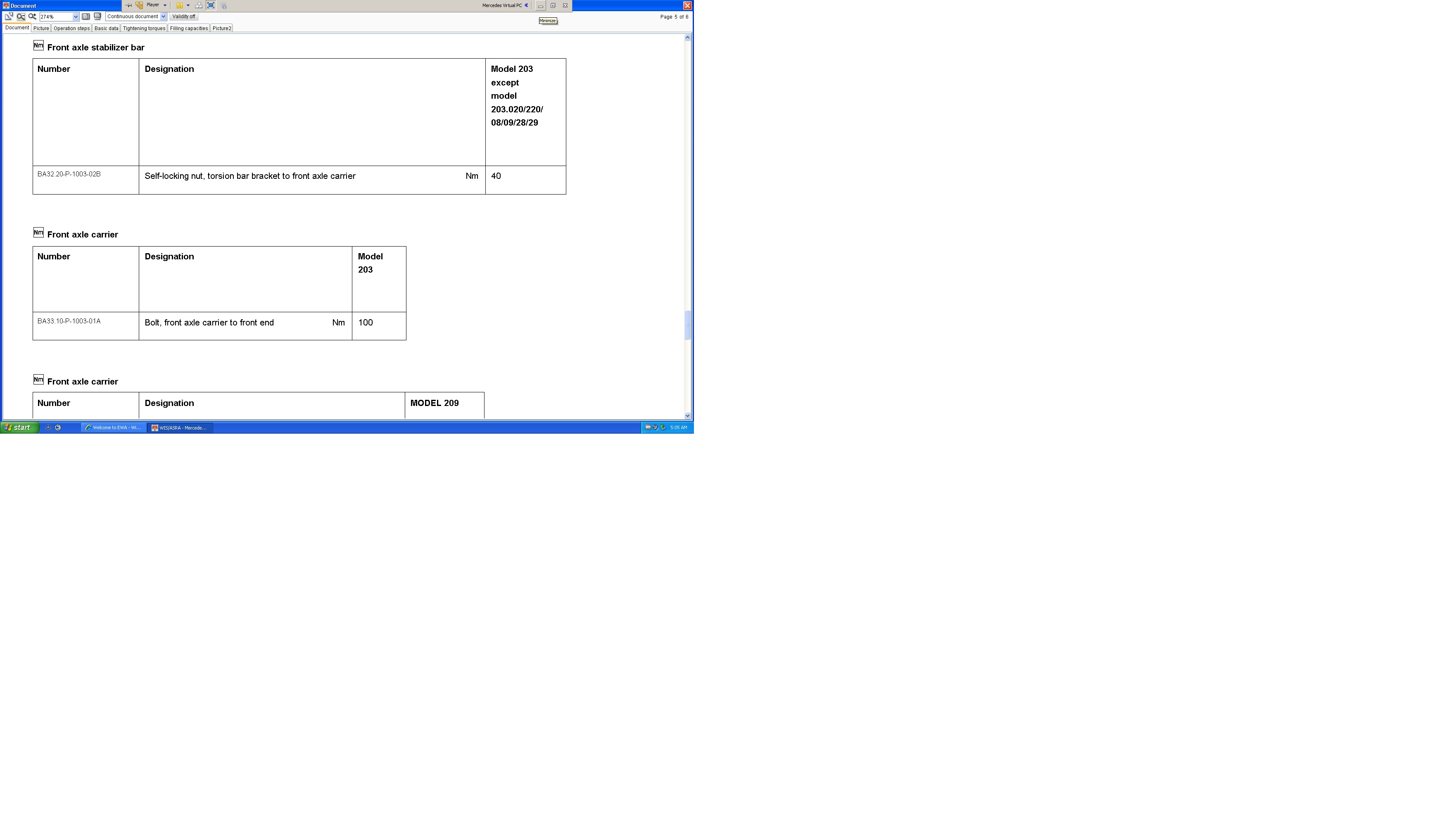

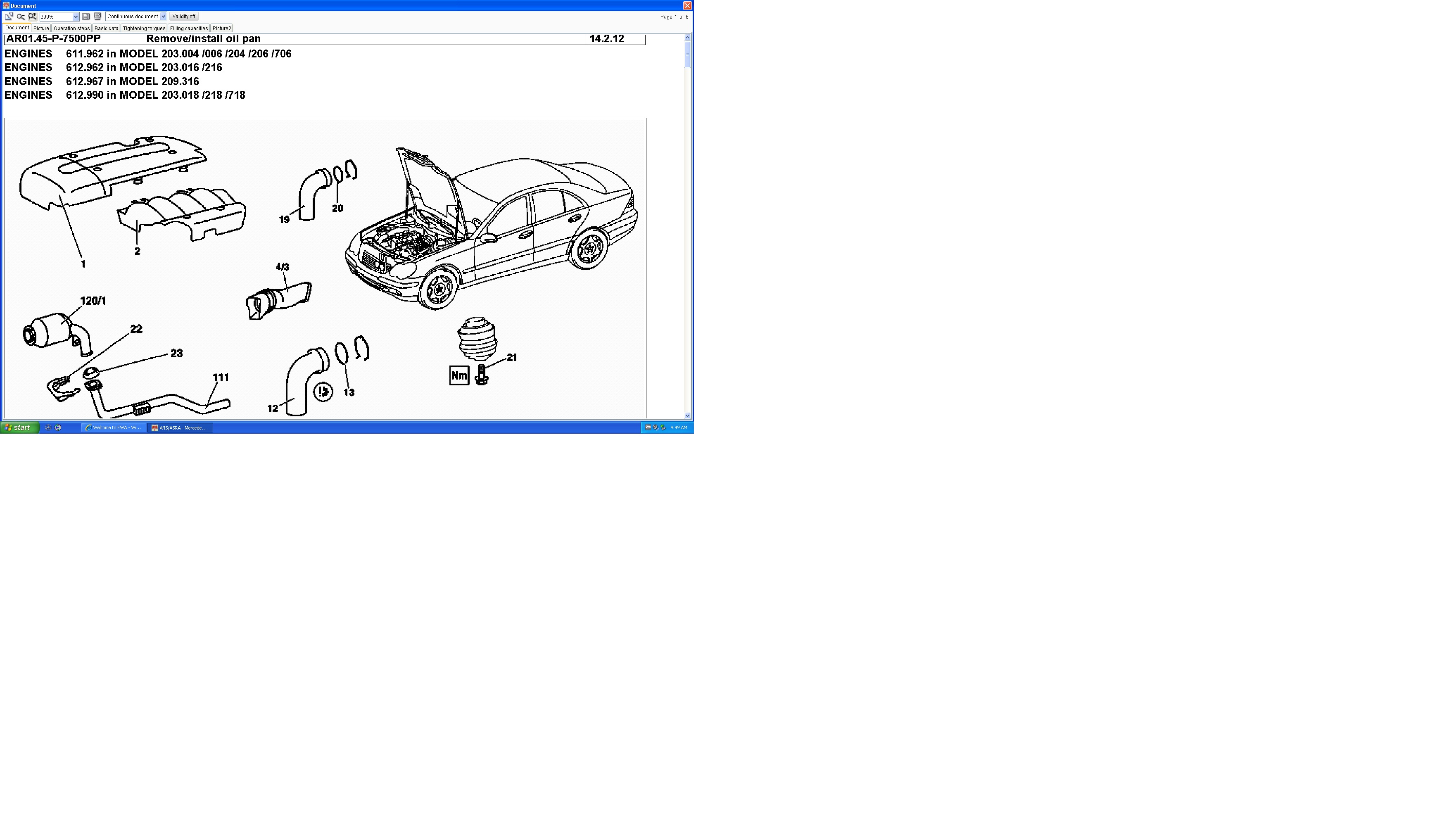

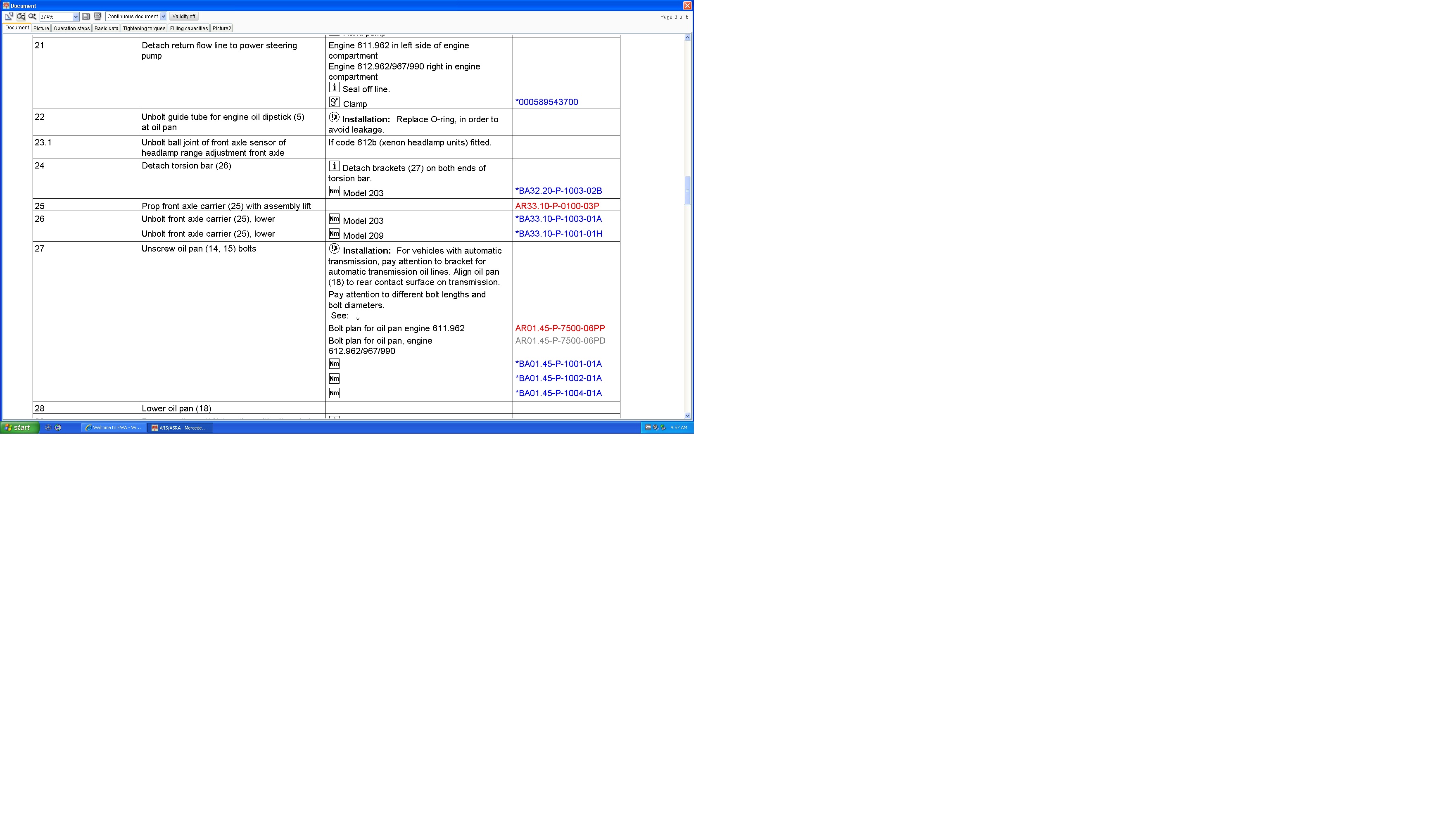

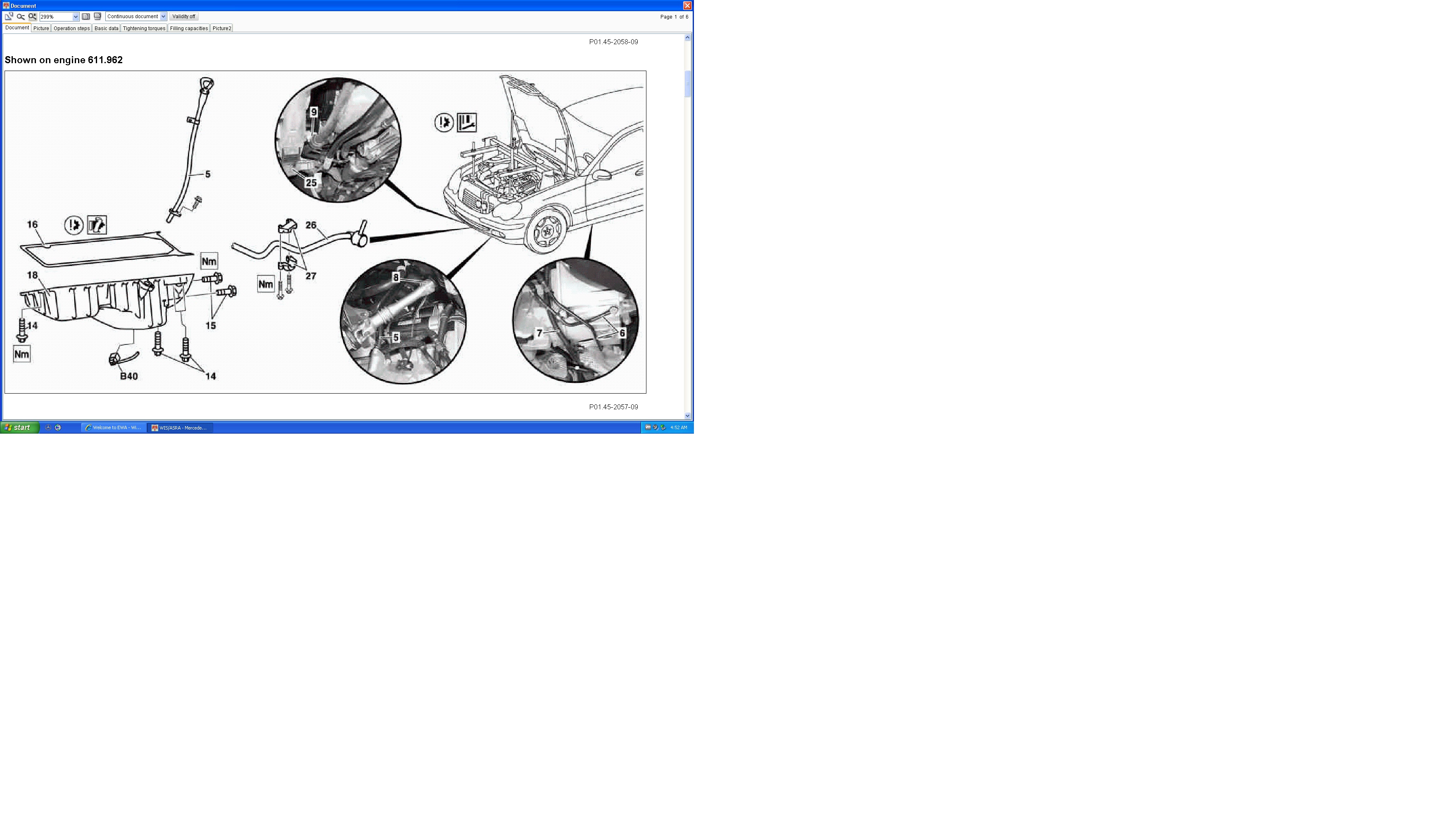

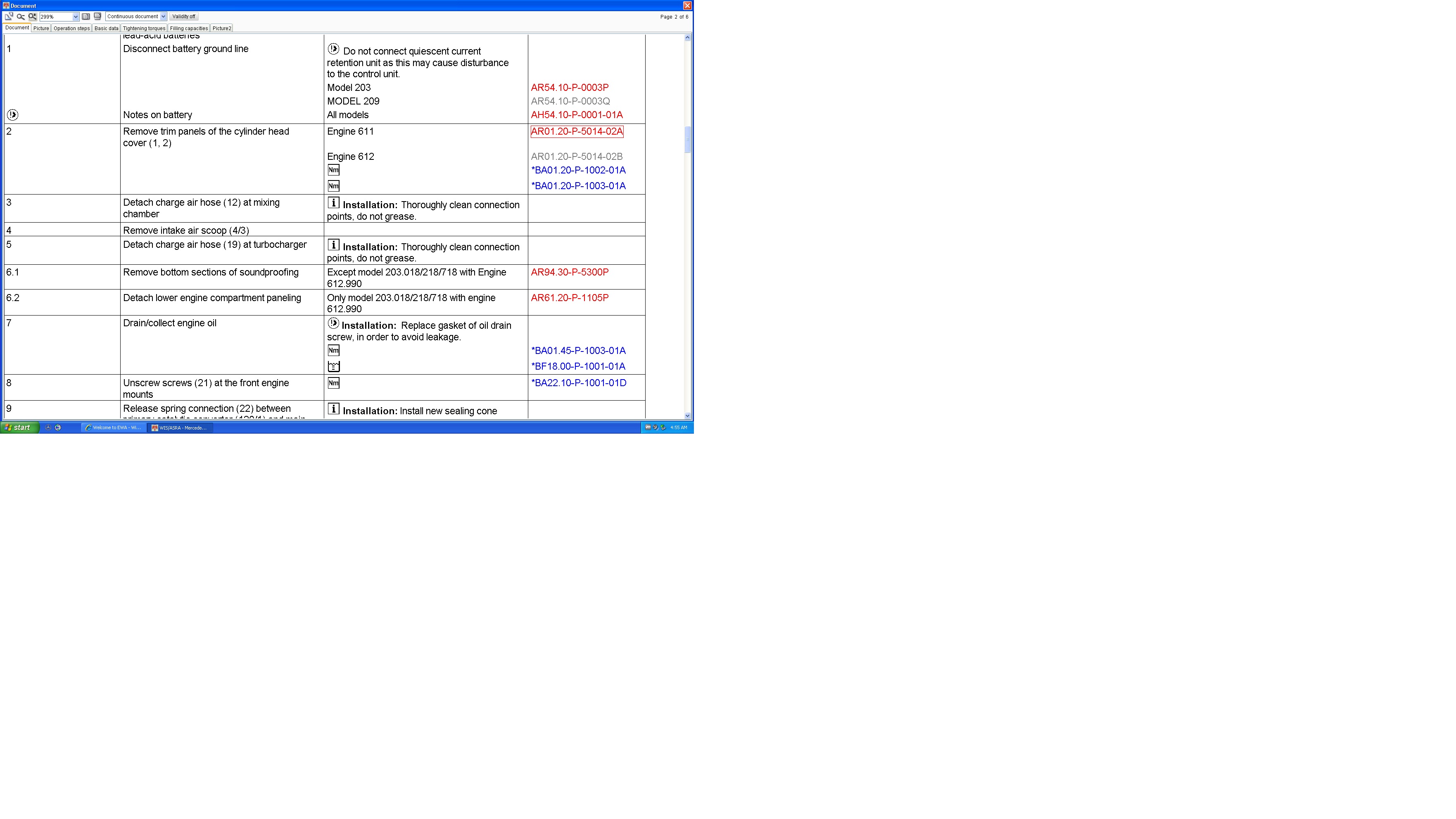

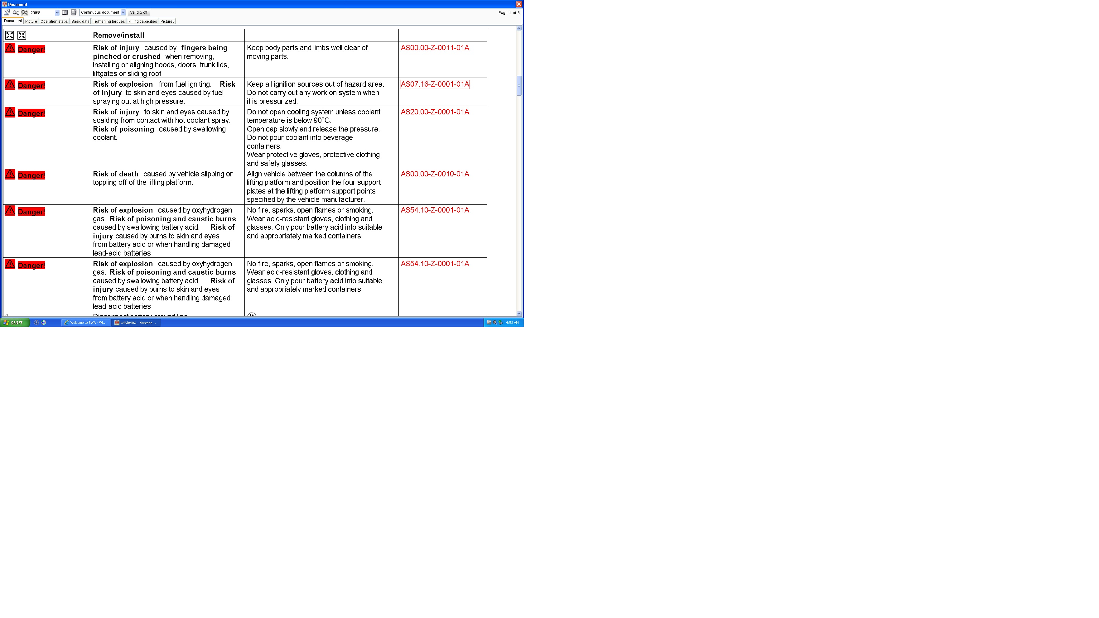

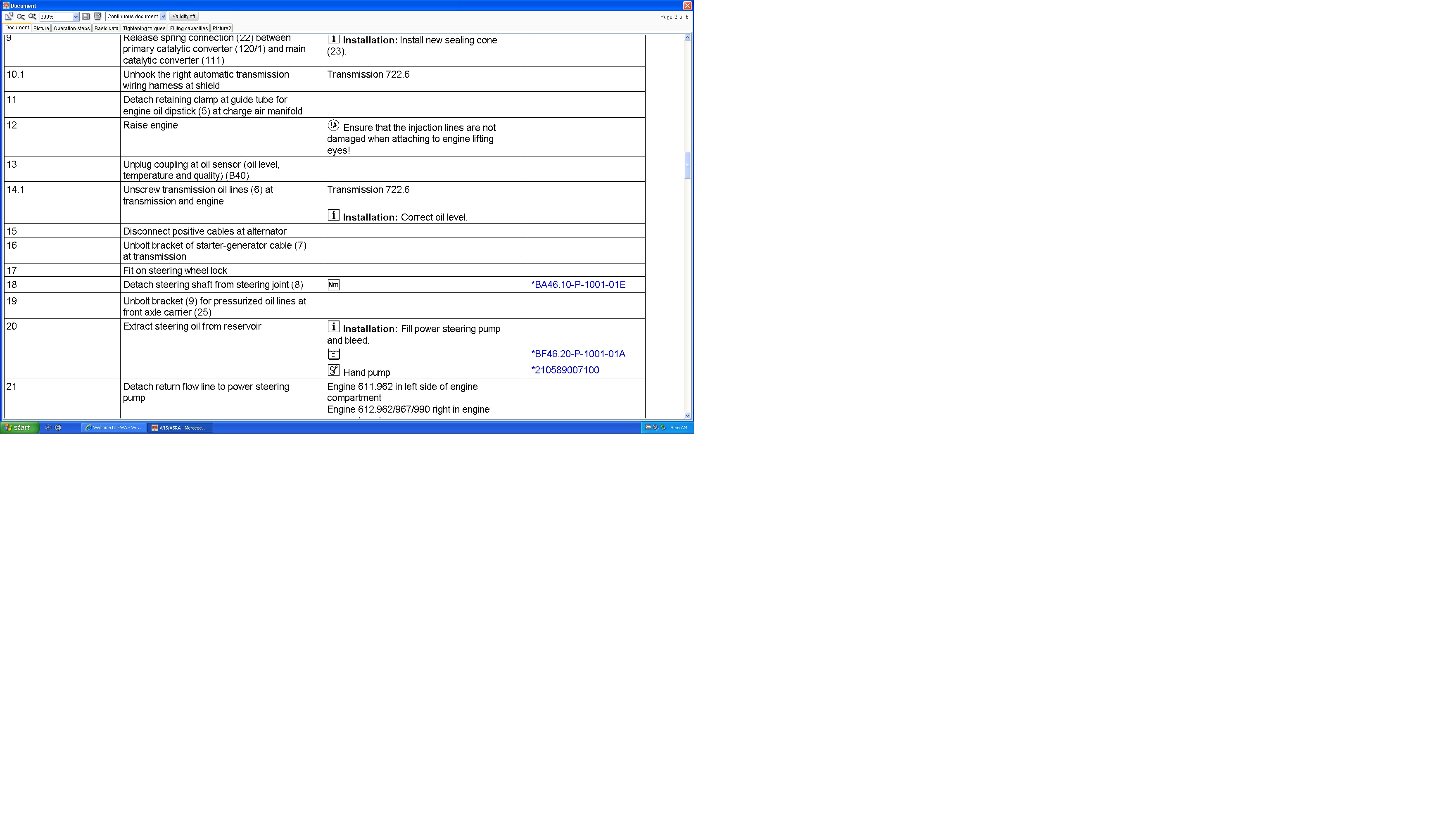

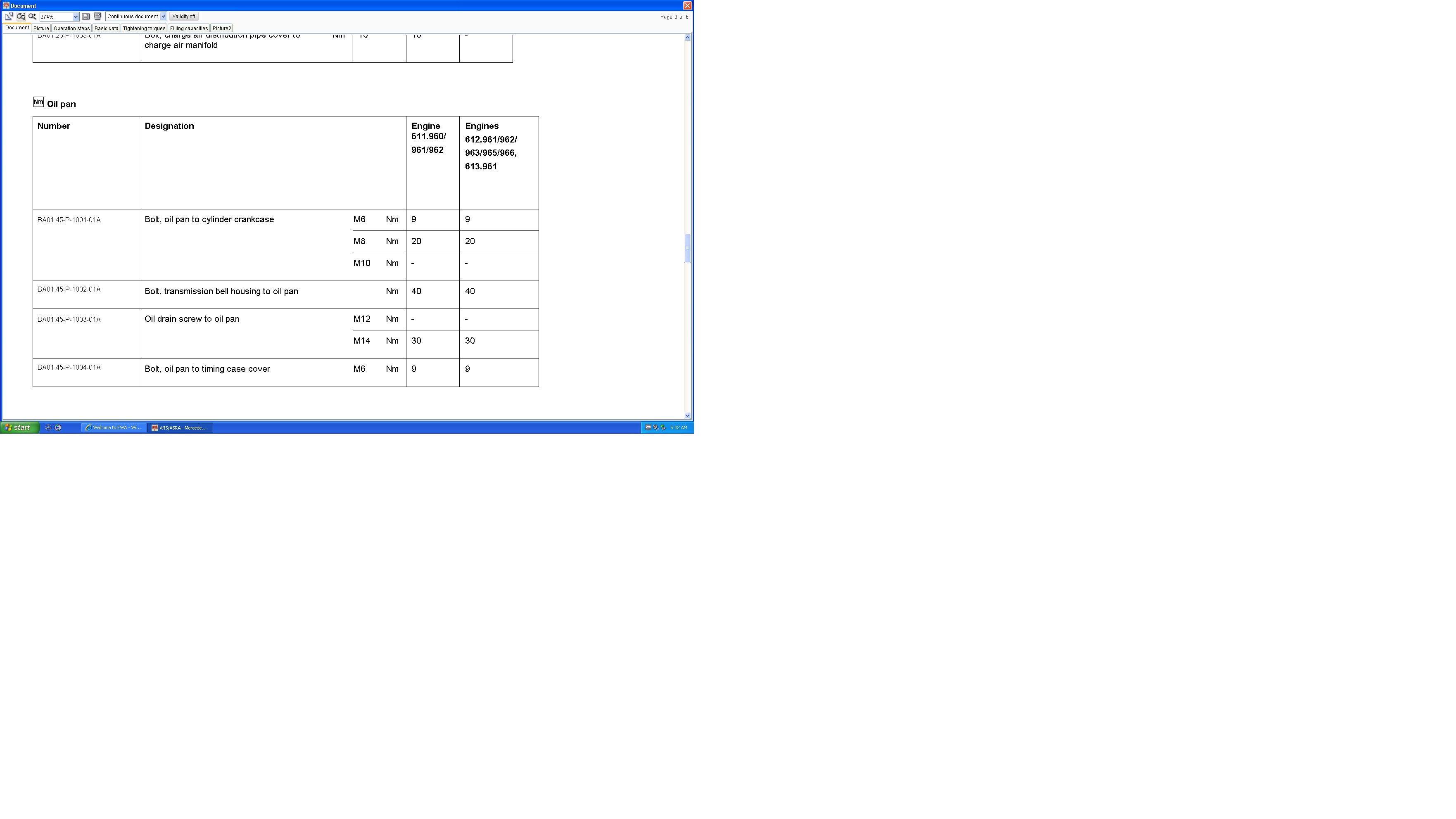

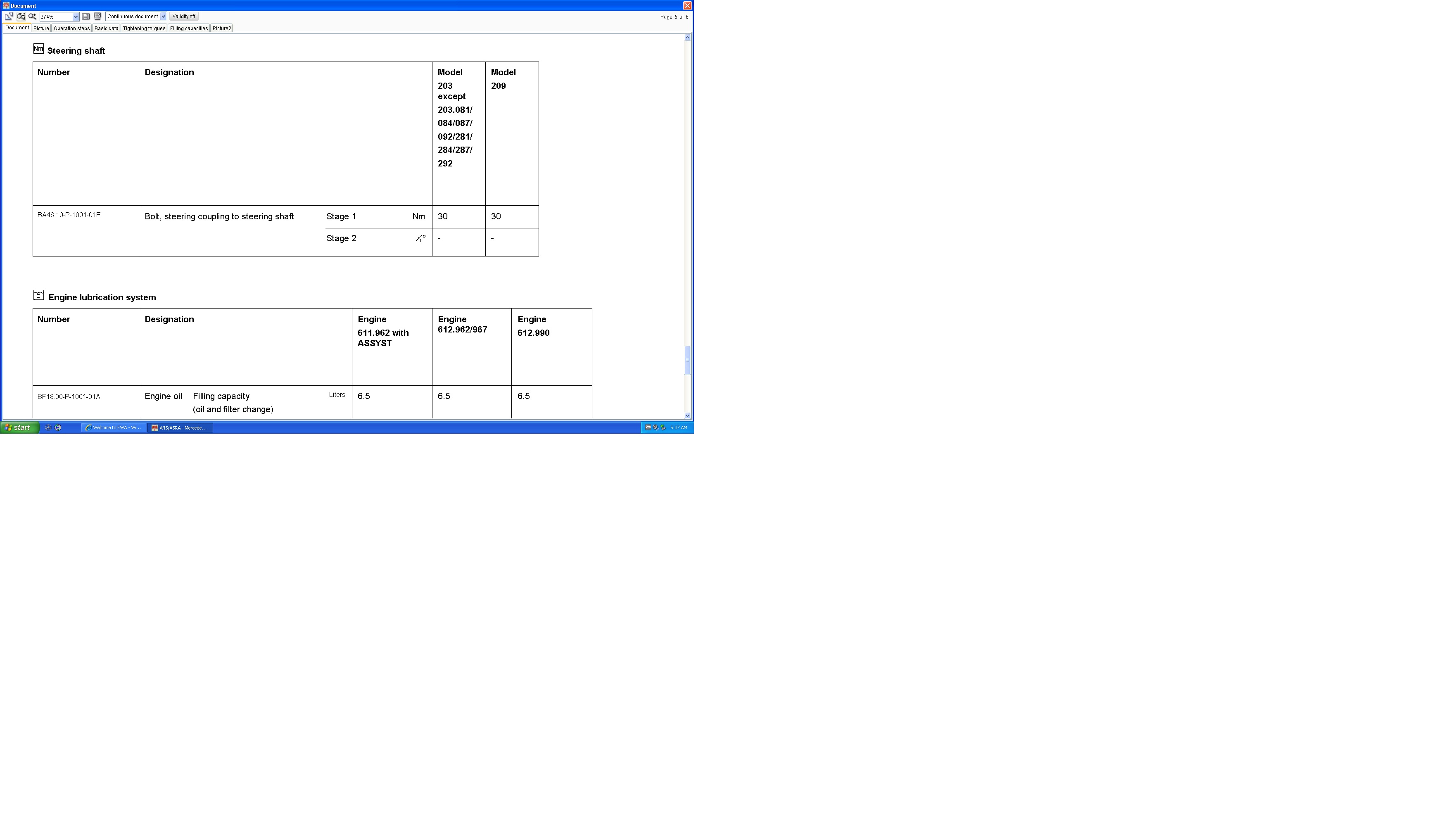

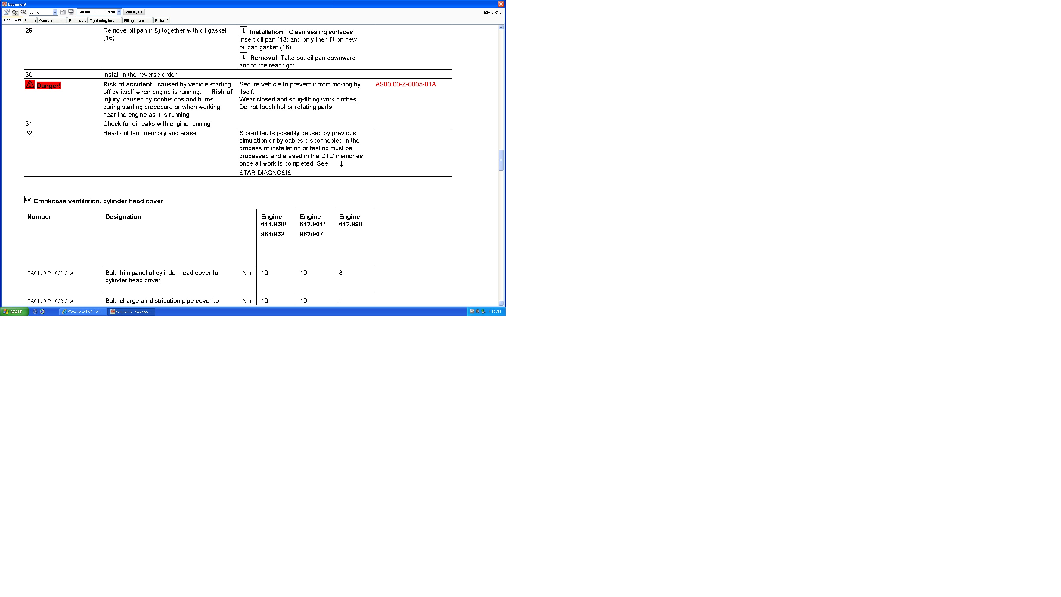

hope this helps
Attached Thumbnails How to remove the sump-1.jpg   How to remove the sump-2.jpg   How to remove the sump-3.jpg   How to remove the sump-4.jpg   How to remove the sump-5.jpg
How to remove the sump-6.jpg   How to remove the sump-7.jpg   How to remove the sump-8.jpg   How to remove the sump-9.jpg   How to remove the sump-10.jpg
