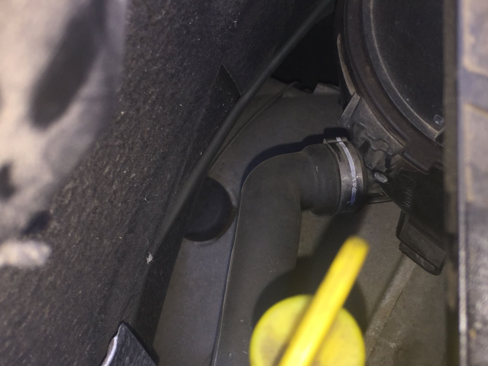

So as suspected I did not completely engage the top radiator hose (which is now installed correctly) and the top ATF line did pop off (also now installed correctly). As for the hood, the cable came out of its slot now onto the immediate problem, The car will not engage the tranny and needs fluid, after lots of searching there are many threads indicating a fill tube with a red pin that can be located in the rear, left side of the engine bay. I find this to be non-existent on mine and understand this will only be found on 722.6 transmissions and not my 722.9. I did see a cap located directly on top of the tranny (see pic below) and was wondering if this may be utilized to add tranny fluid? Or is pumping in fluid utilizing the adapter the only way to add fluid? Mindful I am not yet due for a tranny service and would just like to get the car back on the road for the time being.

That cap on the pic is just a breather. In order to add fluid to the 722.9 there's a method to do it through the pan.

Thank you so much for the info and video. This should be fun and interesting without a lift. Is this something I can do using my Mityvac pump?
