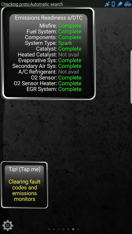

Hey guys I went to check out this 2002 C240 60k miles.
For the year the car is in relatively good condition, smooth engine and shifting. Connected an ELM237/Torque app and it returned codes P0300, P0302, P0303 see screenshots below
2 things I noticed,
1-
When you shift between R or D there is a slight kling noise from the bottom of the transmission that sounds like a loose plate oe something that's come-a-loose. It doesn't affect the car shifting but since I am **** about noises I noticed it. Their MB certified tech says it's a small loose plate or ring that needs to be tightened but to get to it he would estimate about 300 bux simply because of what he has to remove around the tranns, to tighten it. He says that it's just not worth it and it has no progression to become worse, nor is anything dependent on it, that it might go bad. Are you guys familiar with what would make such a slight noise? Should I buy what the tech is selling?
2-
Torque threw the below errors. Also when you turn the key off this message pops on the dash "1 Malfunction." Are these serious/costly? Can you guys point me to their fixes?
