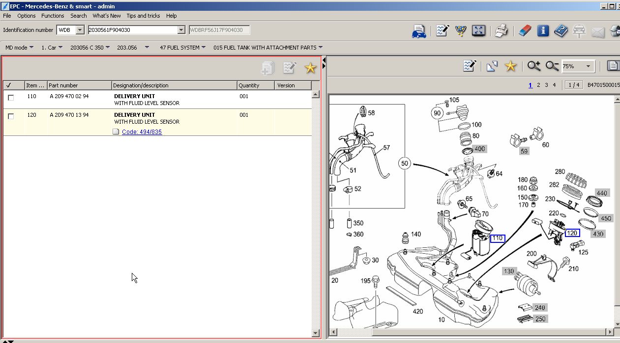

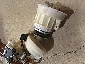

For the rest of you that want to learn about what is in your 2007 W203s here is some supporting data including a photo of what I removed and the housing disassembled. Obviously Mercedes intended for the assembly to be replaced whole, so it is very difficult to get apart. After doing a little research I determined that the filter inside the housing is a Febi 39831. Hard to find.
Attached is the Mercedes workshop instructions showing the removal of the filter from the tank. Pretty sure Mercedes knows where the filter is located. Also, the EPC screen for my VIN showing the part number for the filter, item 120. You will see the traditional filter item 130 is grayed out since it is not applicable to my VIN. Then there is the ECS Tuning listing for the filter part number 2094701394.Hope this helps those that need it.

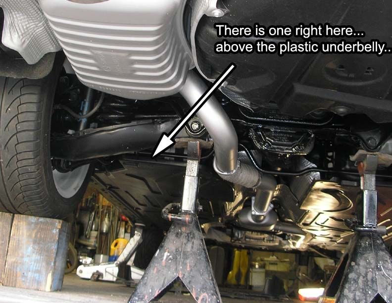

LOL NOPE you're still wrong. The thing in your picture is fuel screen that protects your fuel pump from ingesting the larger chunks of garbage that might end up in the bottom of your fuel tank. All W203s have one, not just the M272s. The fuel filter is after the pump mounted behind the left side of the fuel tank. Its item #130 in your screen shot. Pull down the plastic cover and you'll see it. The fuel filter protects the injectors from much finer particles and it also doubles as a fuel pressure regulator. It's there, you just have to use your eyes and look.

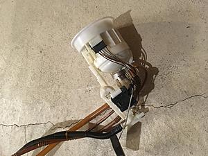

Nothing there dude. 07s don't have that filter. Not sure if you have used EPC before, but where there is a gray box about the item number, it means its not available for that VIN. Hopefully the facts and data I have presented helps the OP with his issue. Opinions and snarkyness not helping anyone. Here is the pump and the sock on the inlet of the pump which is on the right side of tank.

C320
If you think Mercedes parts diagrams and part numbers are wrong, feel free to send them a strongly worded letter. I'm sure they'd love to hear from you. Your fuel filter is PN 002-477-30-01 mounted outside the fuel tank.
