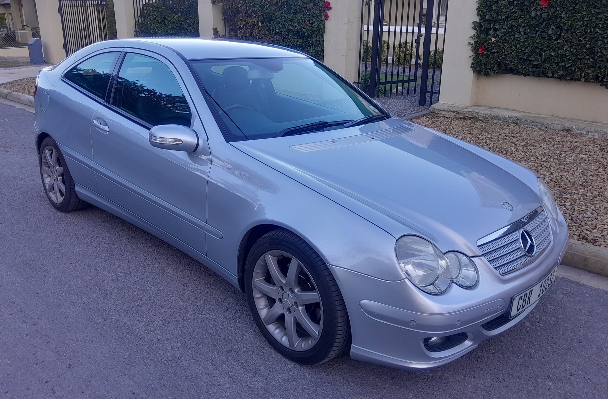

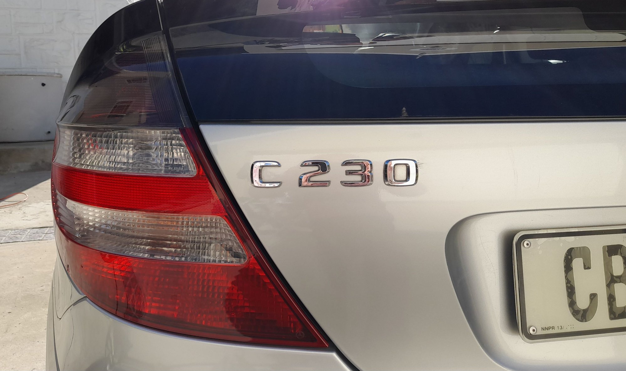

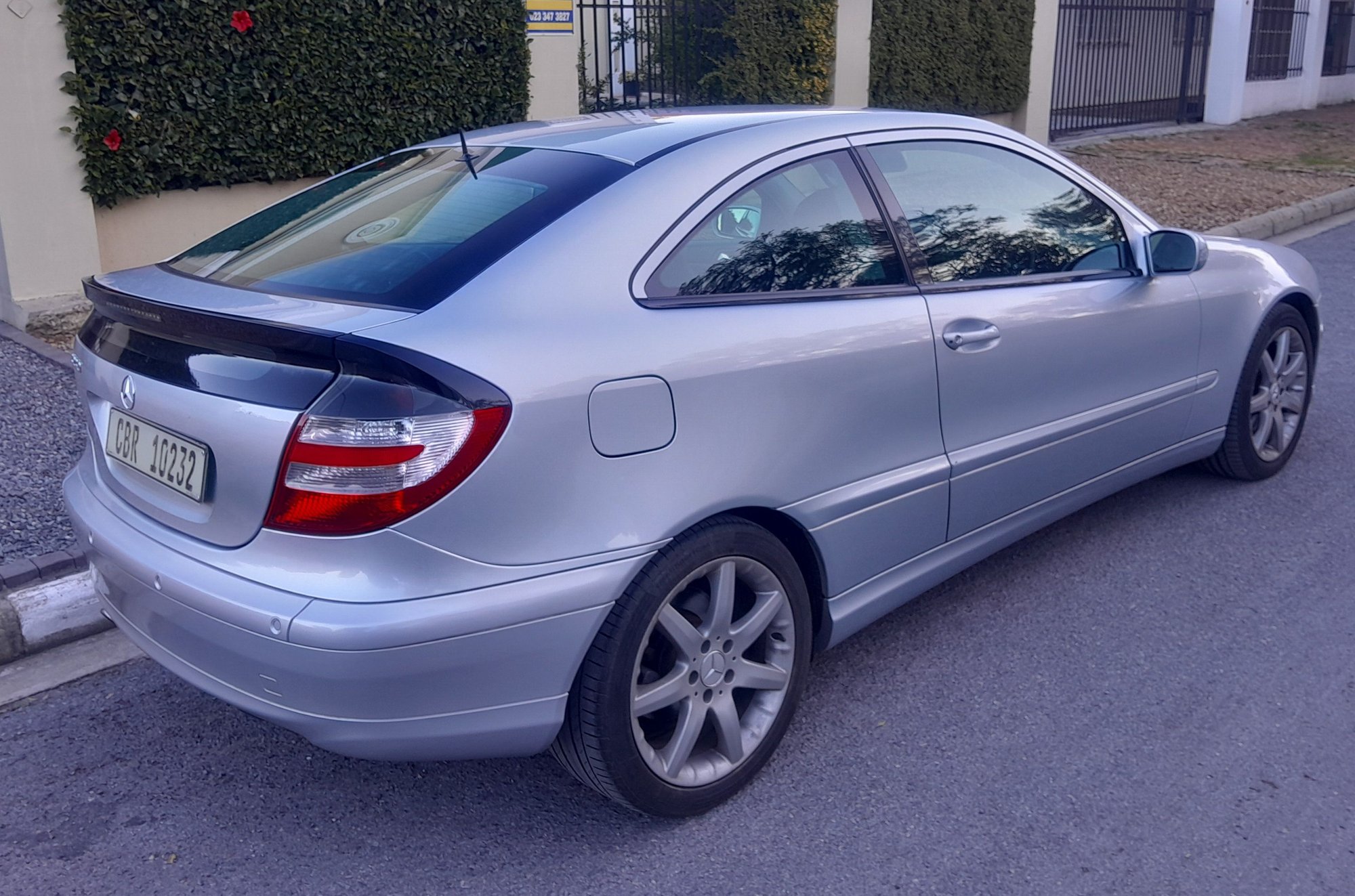

Many thanks Dave, Pete. I do have the M-B part number on the quote that they emailed me, so I will be wary of "cheap imitations".
My car is definitely a C230 according to the plate on the tail-gate, but the registration document refers to the "Series Name" being CL203. See some pix attached.
Best regards from South Africa.

You have the 05+ styling upgrades, and no "Kompressor" badge on the back, so
you must have the 2.5L 6 cylinder, 06-07, correct?
Yes, CL203 delineates the coupe from the sedan and station wagon.
The station wagon is referred to as the "T" model and is S203.
Thanks for posting! Have any interior photos?
