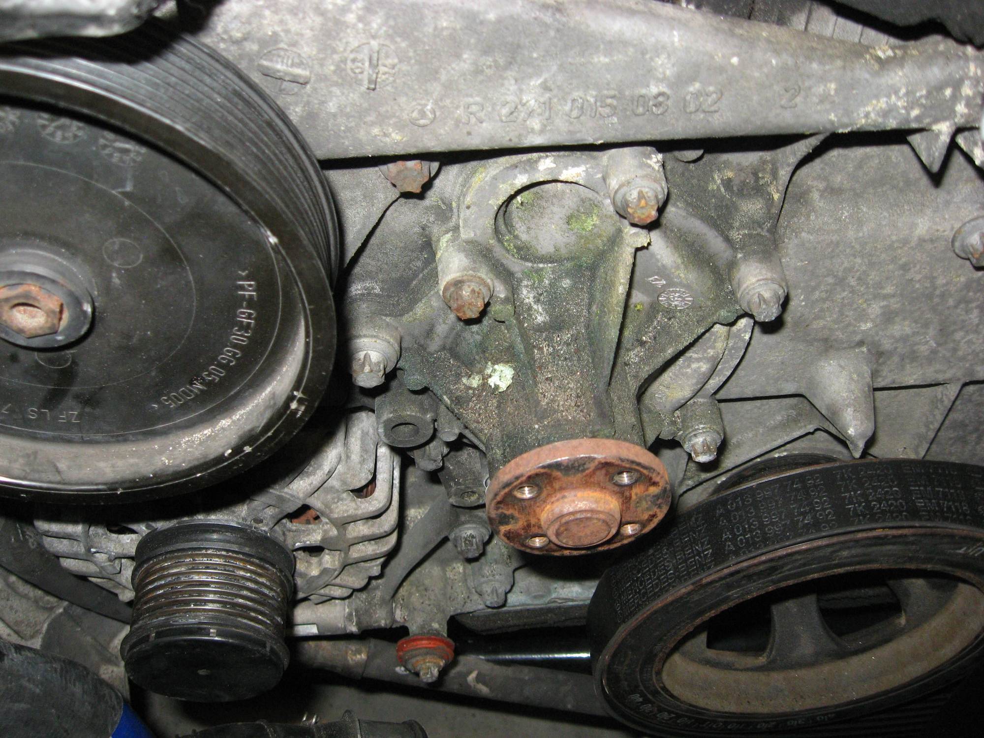

I pulled the front splash shield off to work on my alternator and found that some coolant had collected on the shield. I took these photos of the water pump and I suspect that is the source of the coolant:
The car has 155,000 miles on it and I think I have the original water pump. Since it looks like a new water pump is in my future, does anyone have a recommendation for a brand and supplier? I've found the following on line:

Yes, as I recall, that's the radiator drain plug.
Yea, it looks like the seal went on the water pump, and anti-freeze is weeping through the front seal. That's how water pumps start to fail. If left alone, the shaft will wear/rust, and eventually wobble, then break.
MB no longer makes a new water pump. I thought I got a new MB water pump when I did my semi-restore? Maybe it was a MB rebuilt?
Regardless, hopefully, MB has the re-builder use the same quality, or similar quality parts.
So, my advice is go with a MB rebuilt unit.
The original lasted ~150K miles. No reason a rebuilt shouldn't be similar.
As I mentioned, it's the seals that go. So, reusing the housing, shaft and impeller doesn't bother this Mech Engr one bit! :-)

Fwiw, during a rebuild, for the shaft, they check the looks, straightness, and the diameter.
Imho, the looks is the most important. Rust is, imho, the only thing to worry about with an OEM MB pump shaft. A bent/worn shaft is also very apparent visually.
The bearings of the water pump would be replaced. Again, the reason why most water pumps are replaced is because the seal has leaked. That means that the front bearing has been getting water/antifreeze on/in it. So, it's not to be trusted.
Since the car has an electric fan, there's no fan on the water pump. Unbalanced/bent fans are, imho, a non-trivial cause of water pump failure in other cars. The fan vibrates, the shaft vibrates/flexs, and that wears the seal, and so on.
