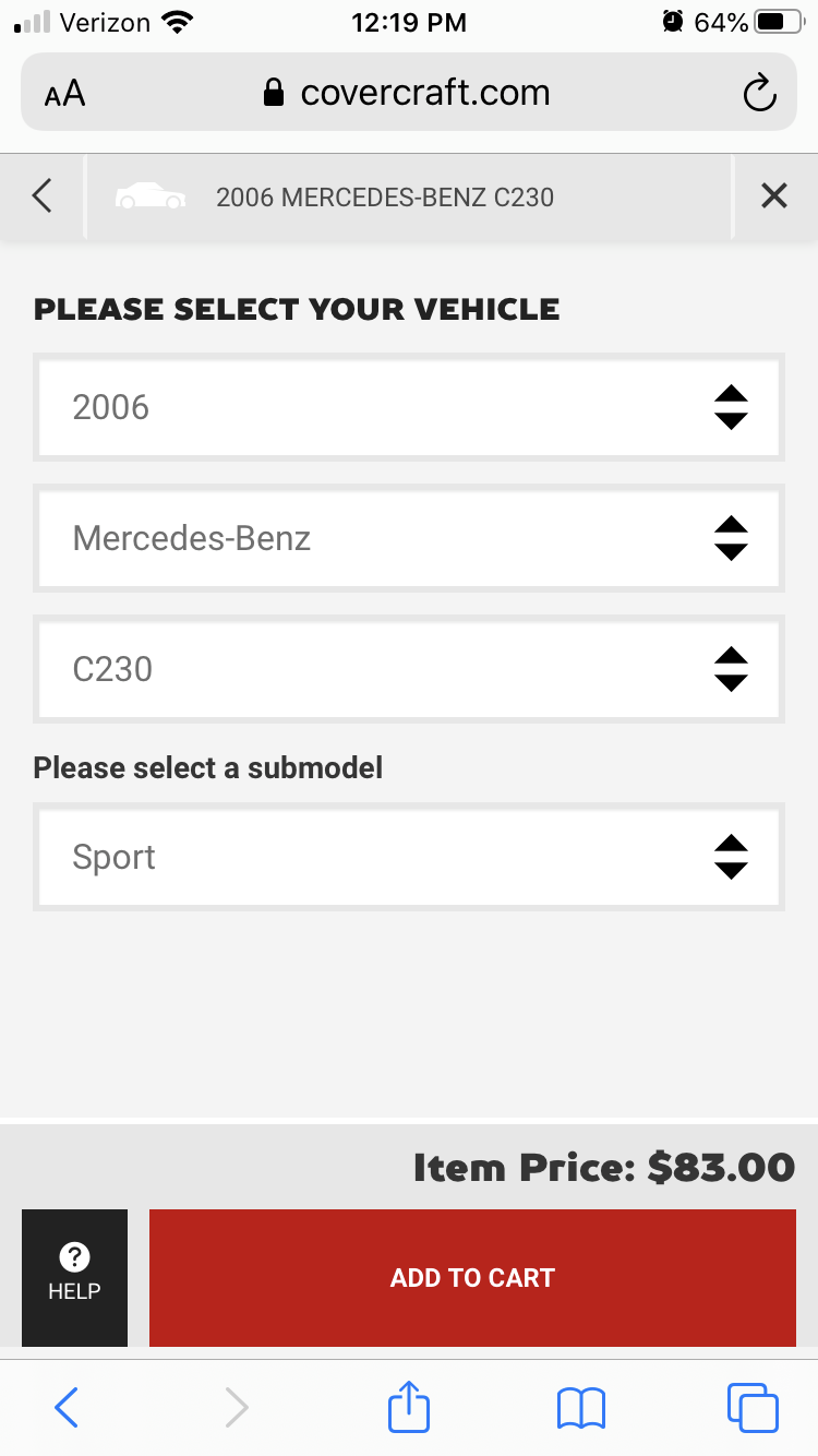

A factory fitted (OEM or not) sunshade and the OEM side blinds are a every summer add on.
Shoot, I use the front blind if out parked long in any sunny/uv weather...
https://mbworld.org/forums/c-class-w...ow-shades.html
Living in Northern CA, I ALWAYS put sunshades in the windshield when parking, rain or shine. I also slightly tint all of my cars to keep the UV Rays from getting to the interior.
Most people think that the sunshades are only to be used in the summer in order to keep the heat out. It is however not only the heat that tears up any interior, it is also the UV Rays that deteriorate plastics and leather. AND, ...... UV Rays exist any day, even if the sun does not exactly "shine".
