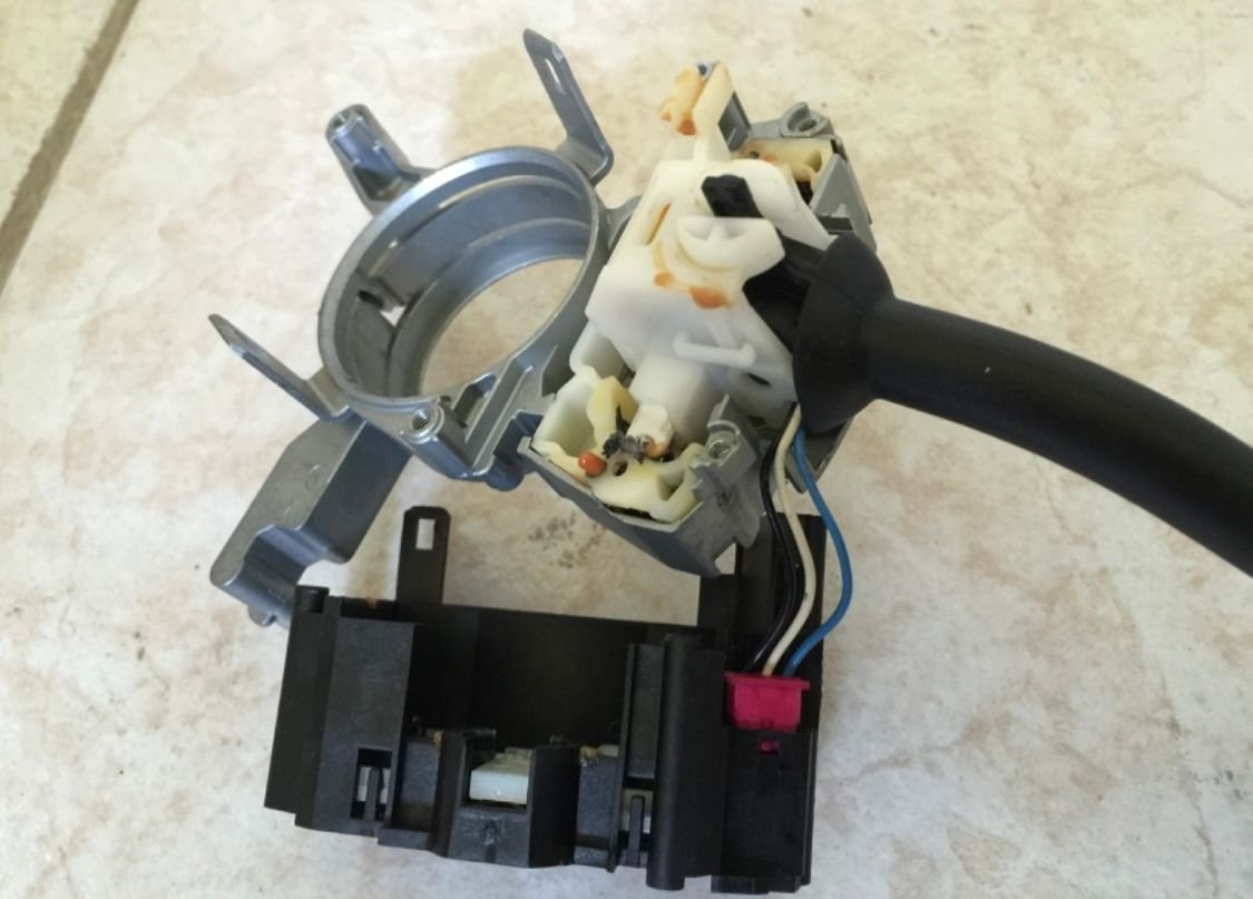

first off, sorry I didn’t take tons of pics. I borrowed the first two pictures from the web. I wasn’t planning on documenting the process.
Naturally you take the steering wheel and column off, unscrew the SAS from the column and separate the turn signal from the back of the SAS. two small screws, possibly T8’s need to come off and there are two small plastic clips that need to be detached to pull the black section from the metal housing.
It will look like this when separated.

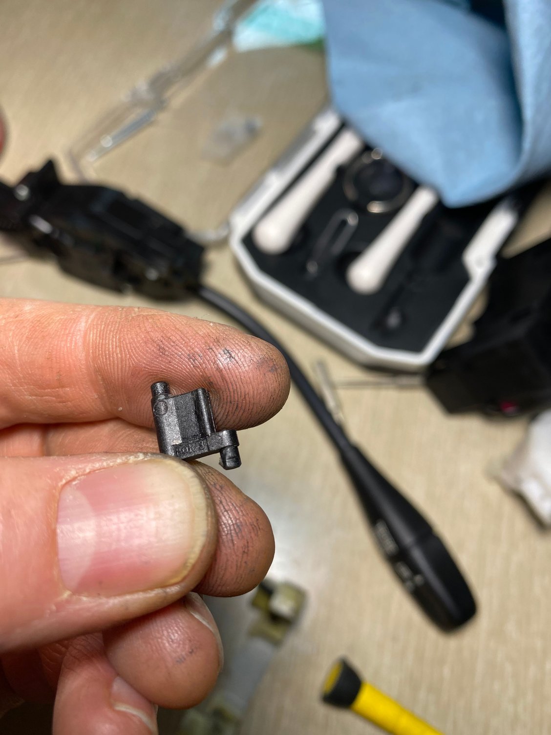

The little black pieces are installed into the larger piece with two small tabs. One of the tabs is snap fit where the other is loose fit. You may break the snap fit ones if not careful. I used a small screw drive to push the tabs together to pull the black pieces out.

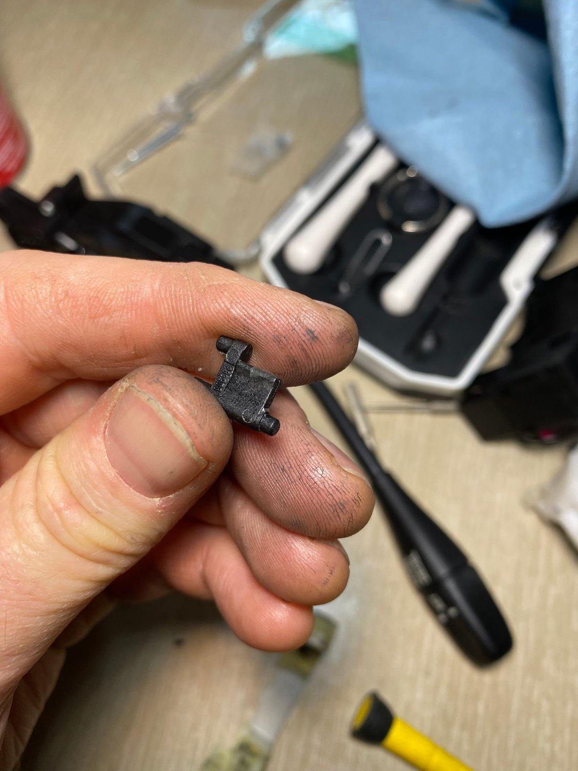

I realized the pieces are interchangeable with each other. One side of the black piece was worn from years of use against the rollers.

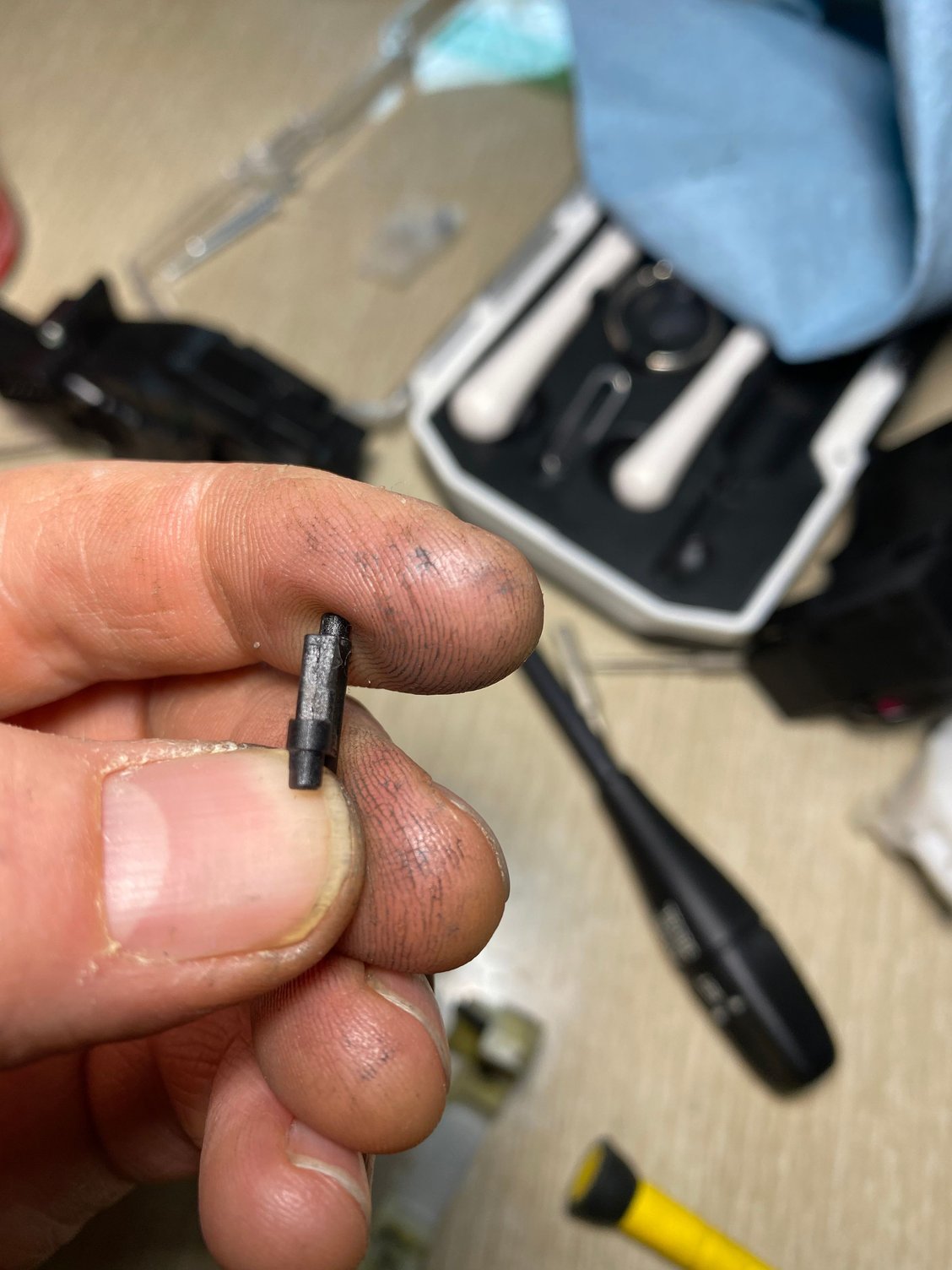

The other side of the piece has the same ridge, though unused, like this.
Put it all back together, it will probably take a few attempts to get it right, and it should fix the issue. Granted, I’m only on day one of the fox, but the stalk snaps tight into place when I make a right turn.

The only problem is that the black pieces then wear out on the other side. While the pieces can be flipped, it only buys a bit of time. The white pieces (the ones that the black pieces rub against) with the notch also wear out. Unfortunately the plastic bits cannot be purchased separately.
