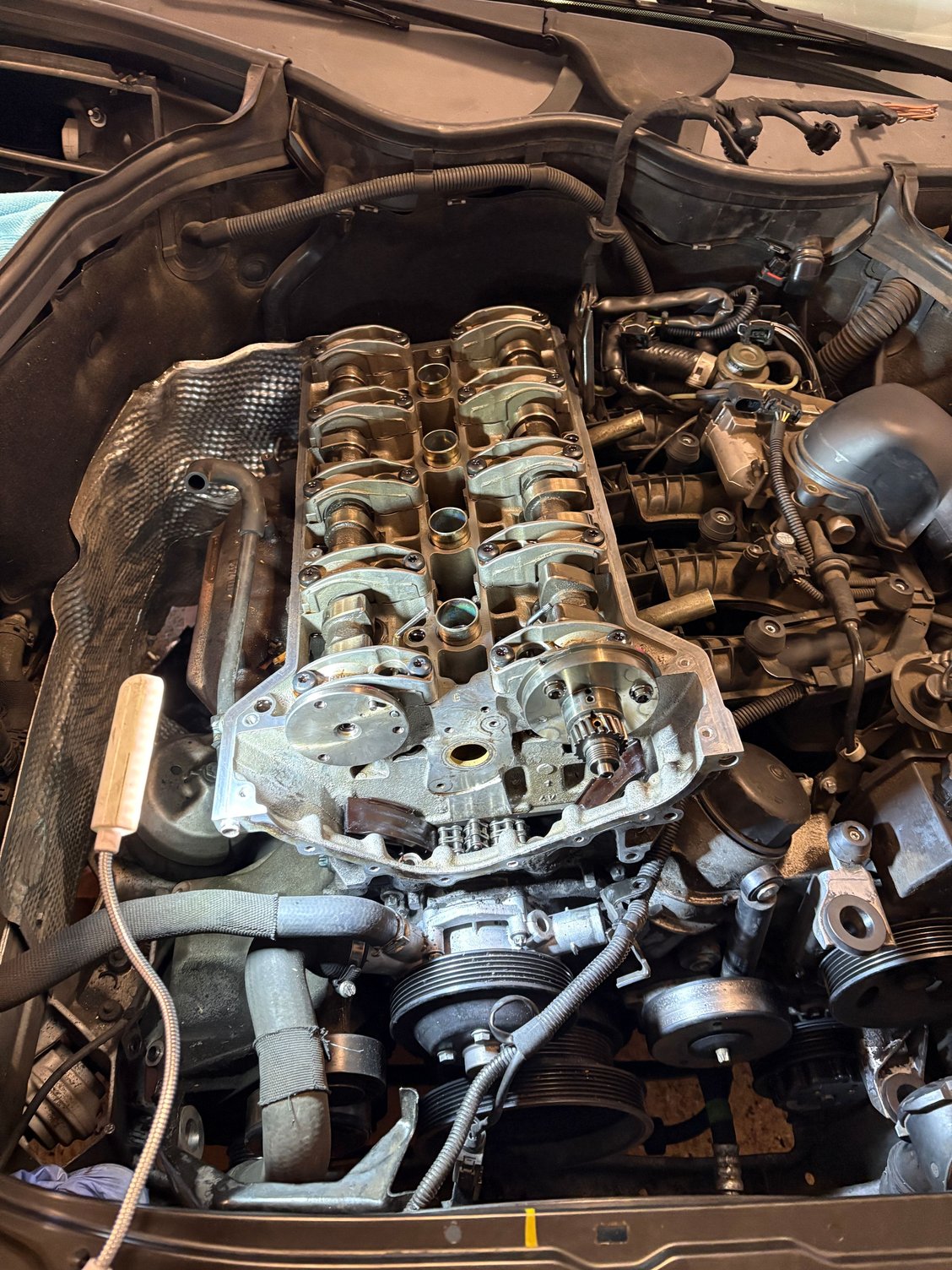

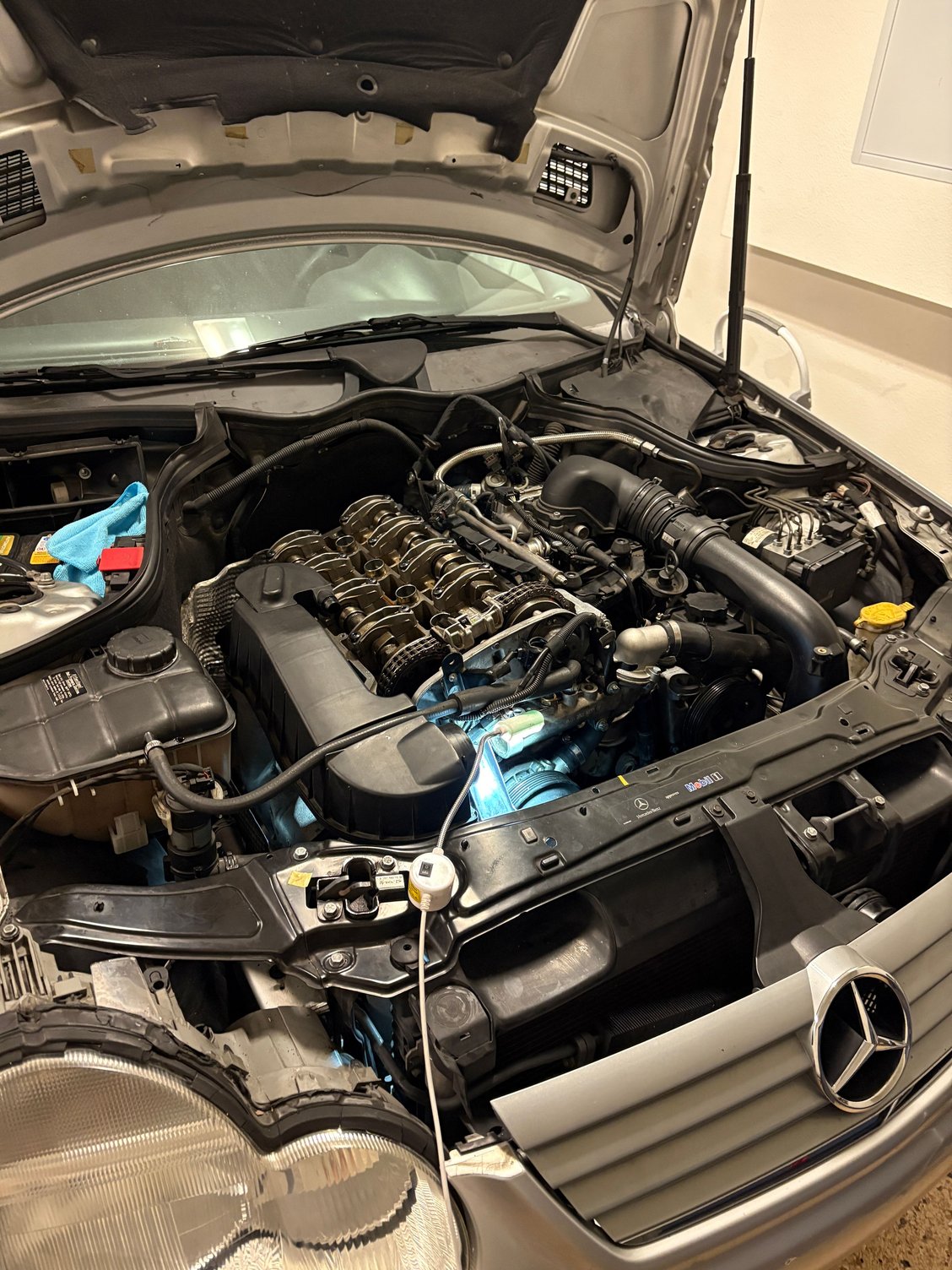

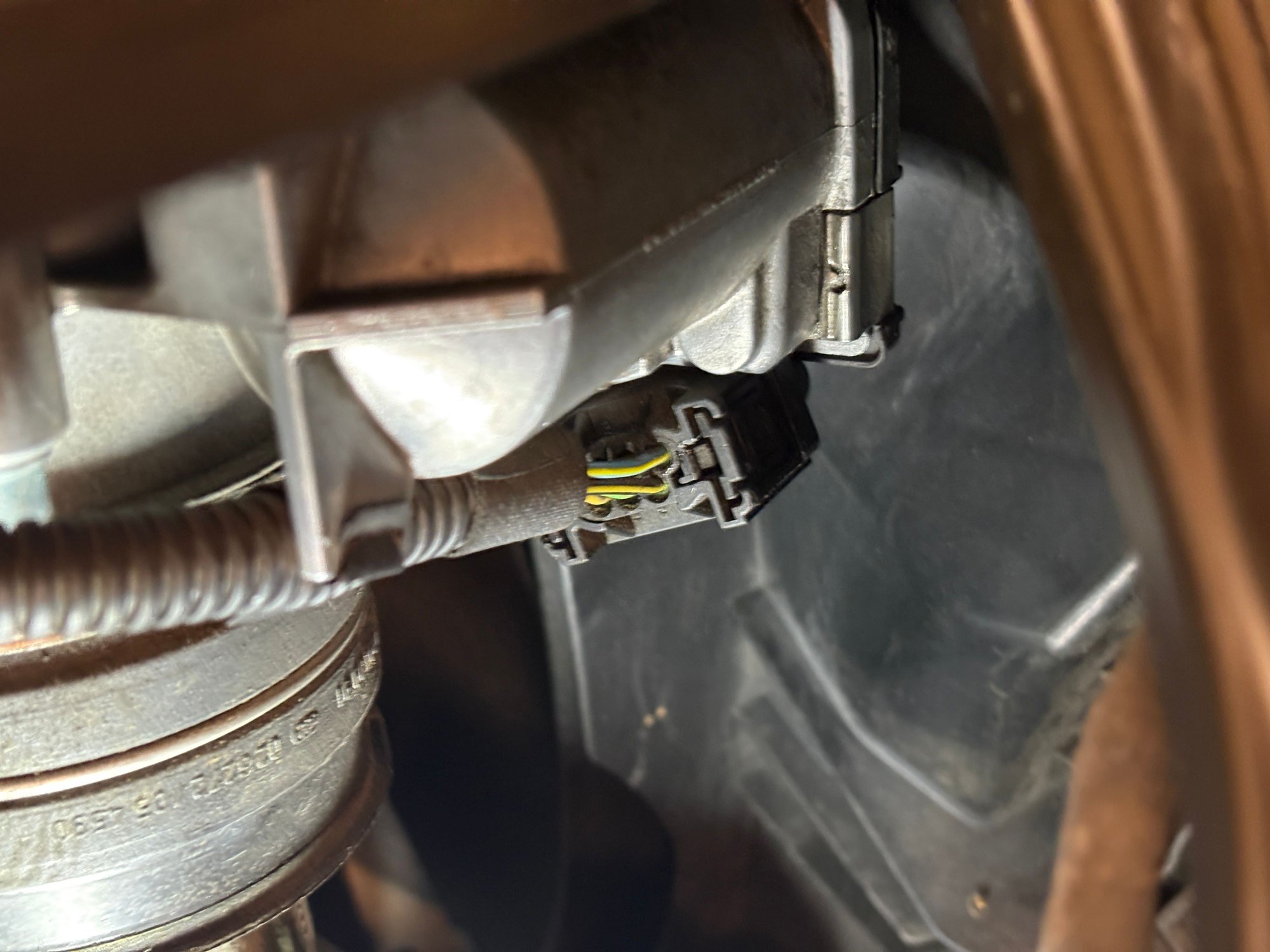

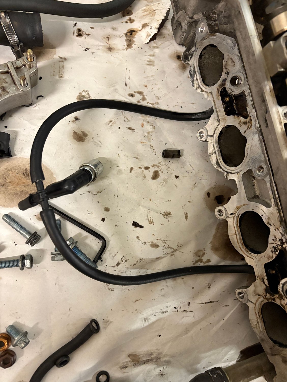

Well, the process of disassembling the head has started, but barely anything has happened.
I started by draining oil, removing spark plugs, removing coil packs, and almost the whole intake.

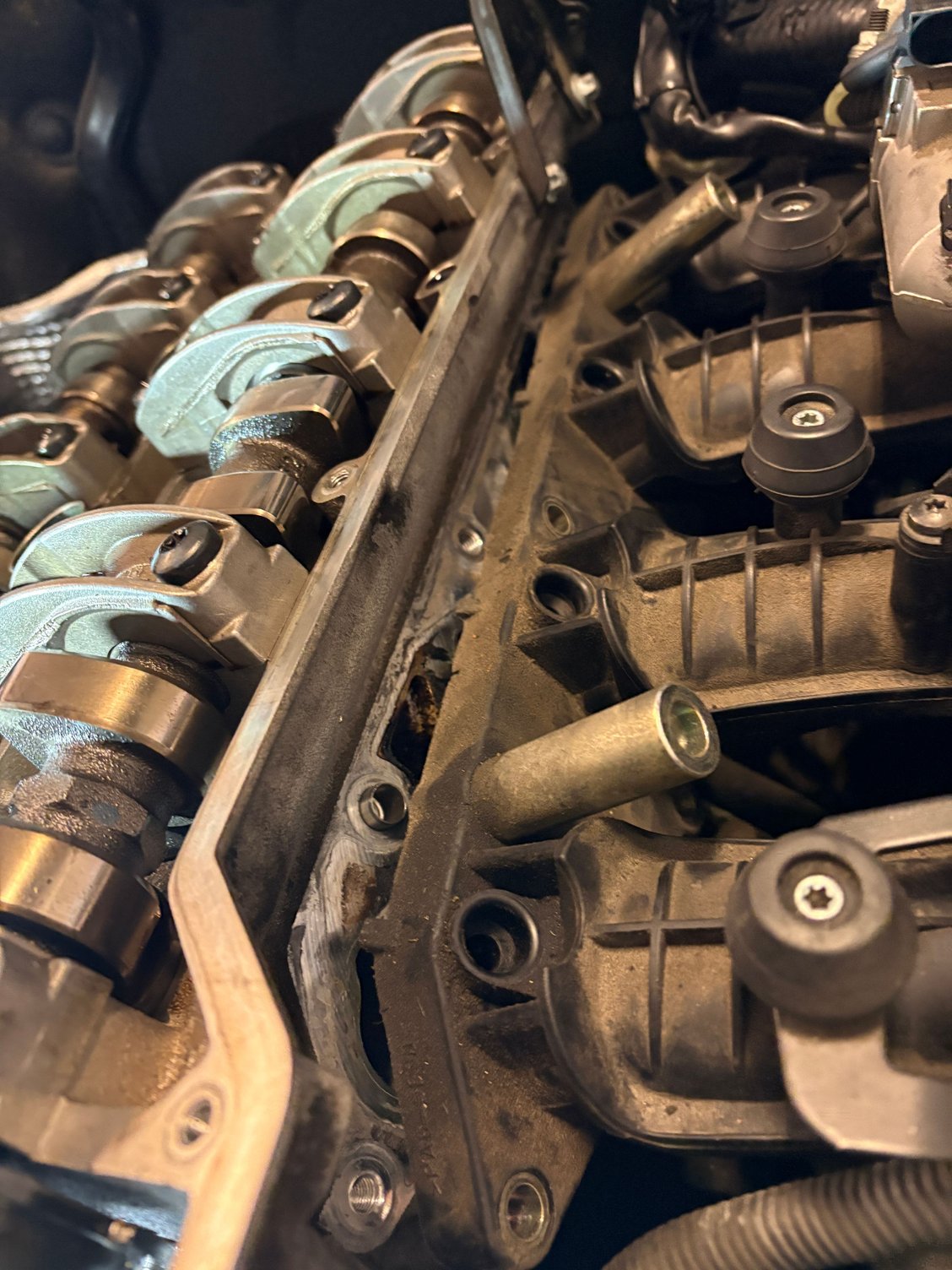

I’m stuck on the connector for the recirculation valve.
Only one casualty, that being one of the breather hoses.
I’ll keep you all posted on how it goes.

The stuck connector
The stuck connector

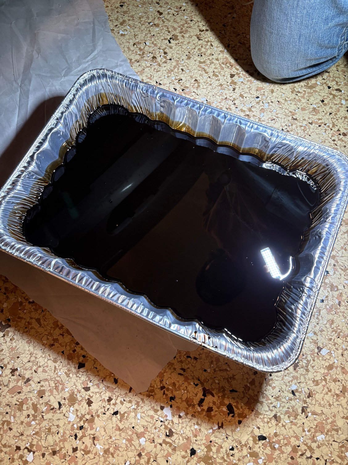

Black oil after 4k miles, yikes

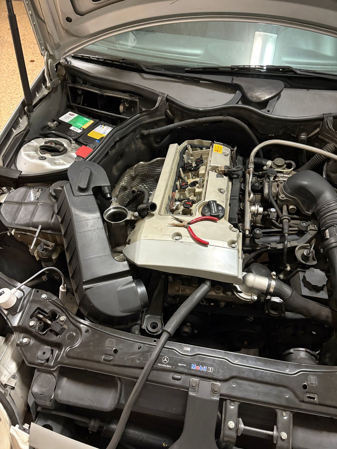

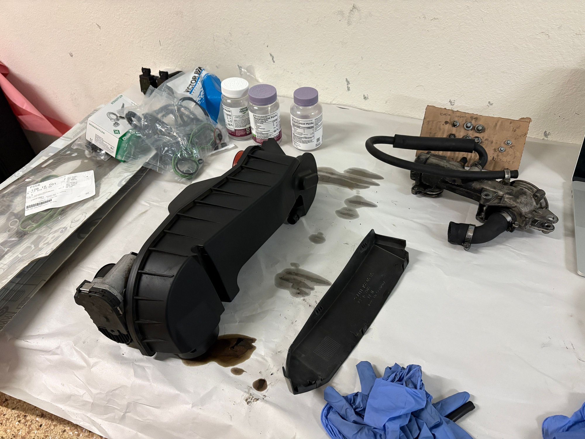

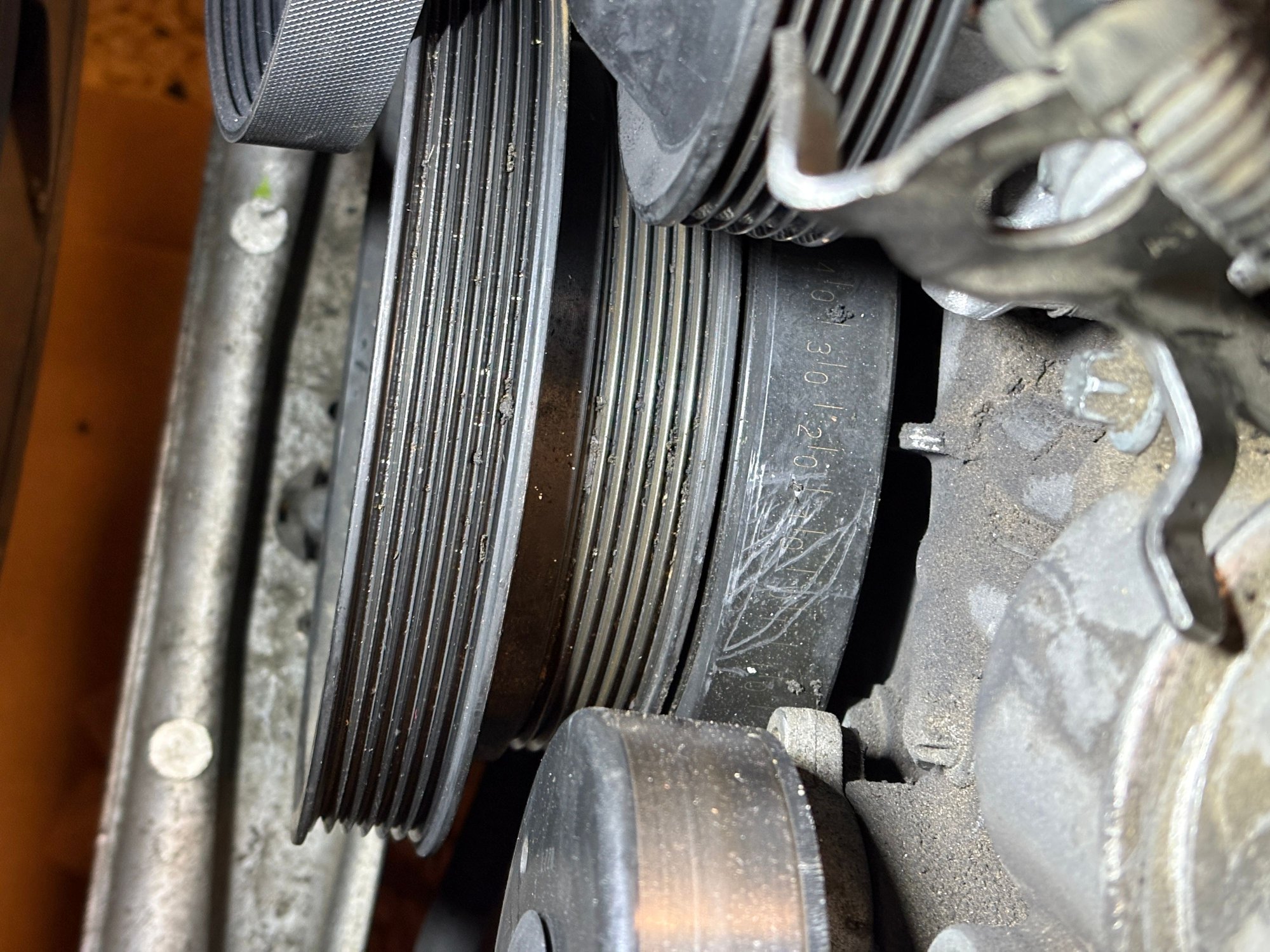

Today I wasn't able to do much, working on a car by yourself is truly a testament to one's strength.
I was able to finally remove the stuck connector on the recirc valve and fully remove the intake.
I also removed the coolant thermostat housing from the block, moving the wiring over the engine (for now) along with the thermostat out the front.
I drained the coolant which looked fresh because it is, and then removed the drive belts.
When do I put the motor at TDC?
I've seen many videos online and am confident about doing the timing for now.

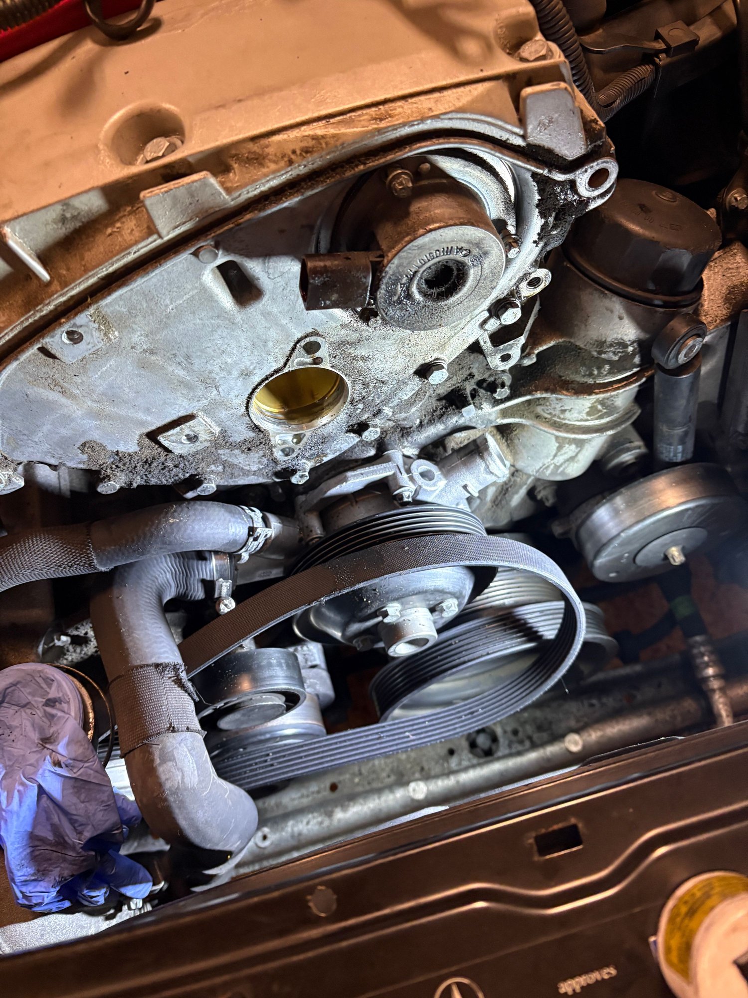

Overview
Overview
Front of the engine, looks really bare now
Belt removed
Belt removed
The parts table grows...

Today I removed the fuel rail along with all the injectors and then I pryed off the valve cover.
I then put the engine at TDC and then I encountered something weird, my exhaust cam seems to be upside down from where it should be.
So now I don't know what to do.
TLDR: My timing seems very off and I need help with it before I continue.

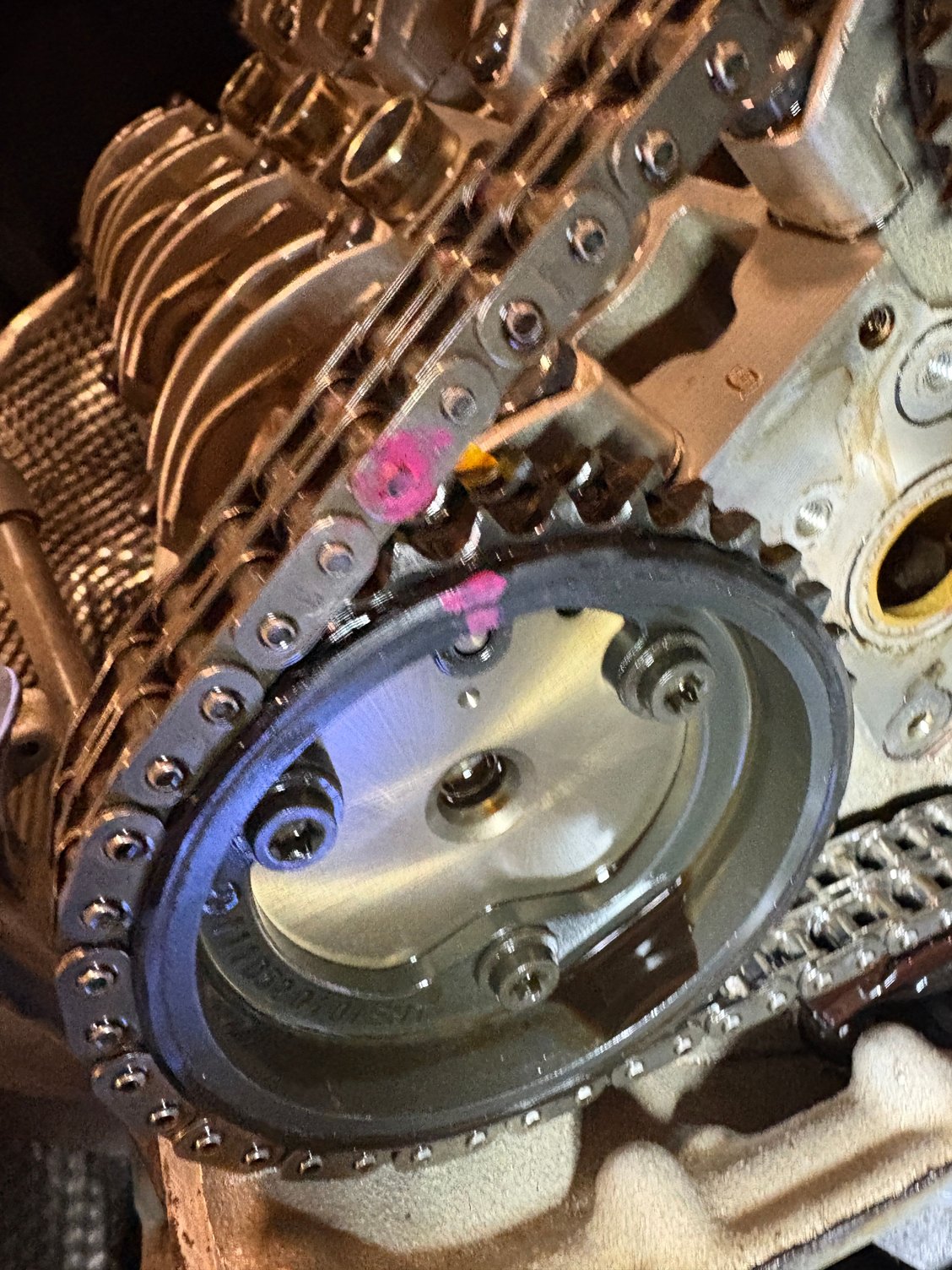

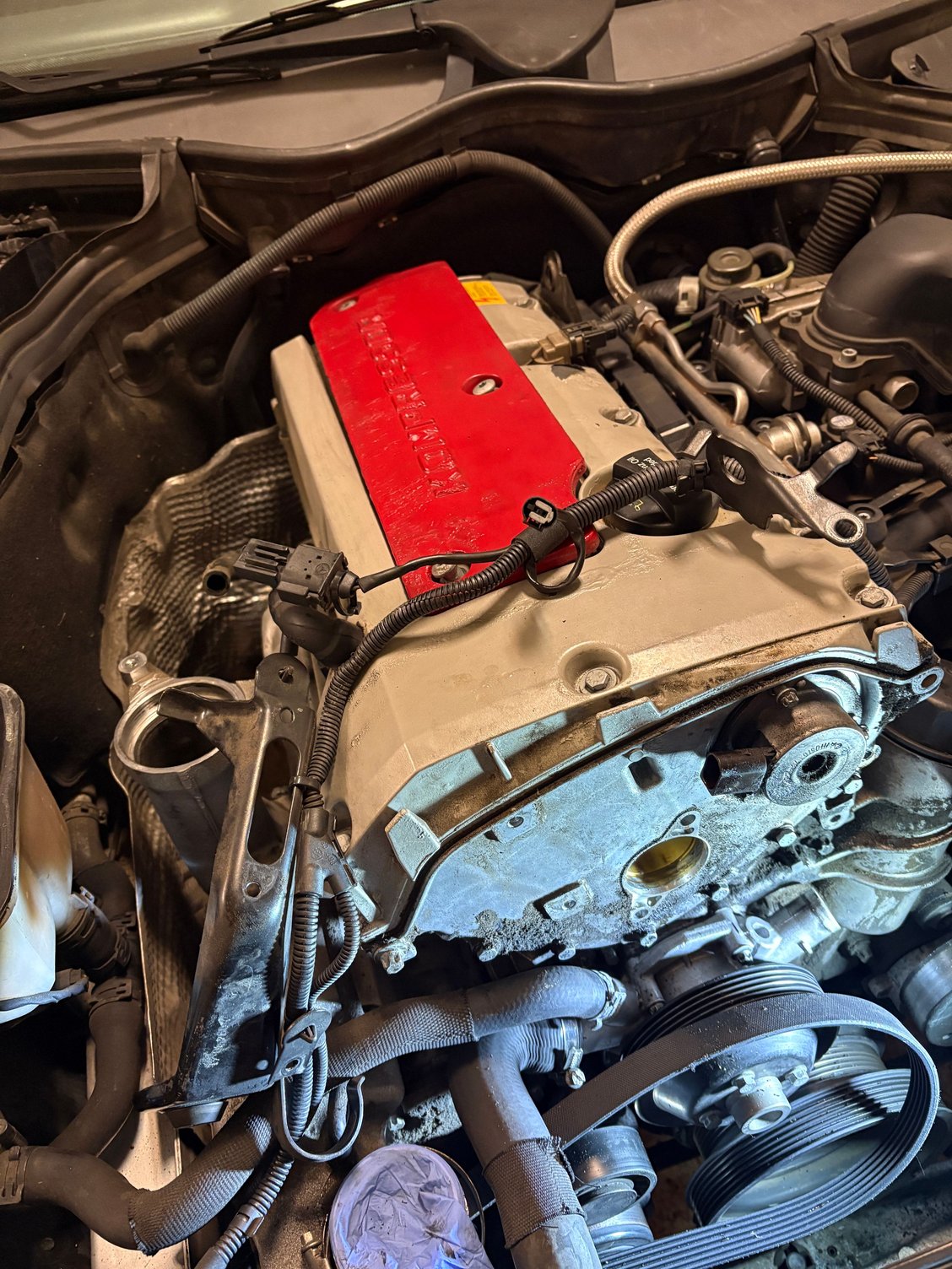

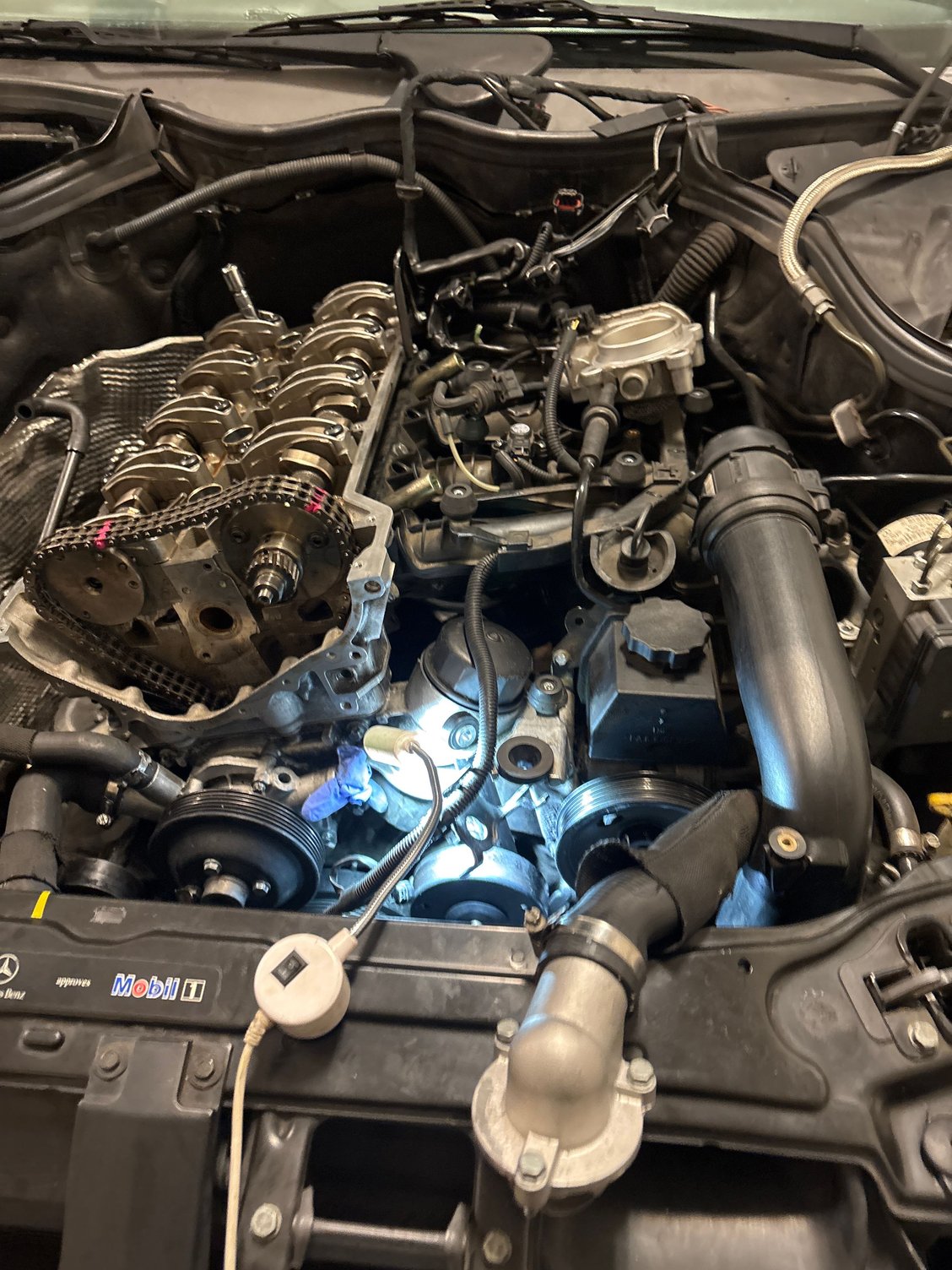

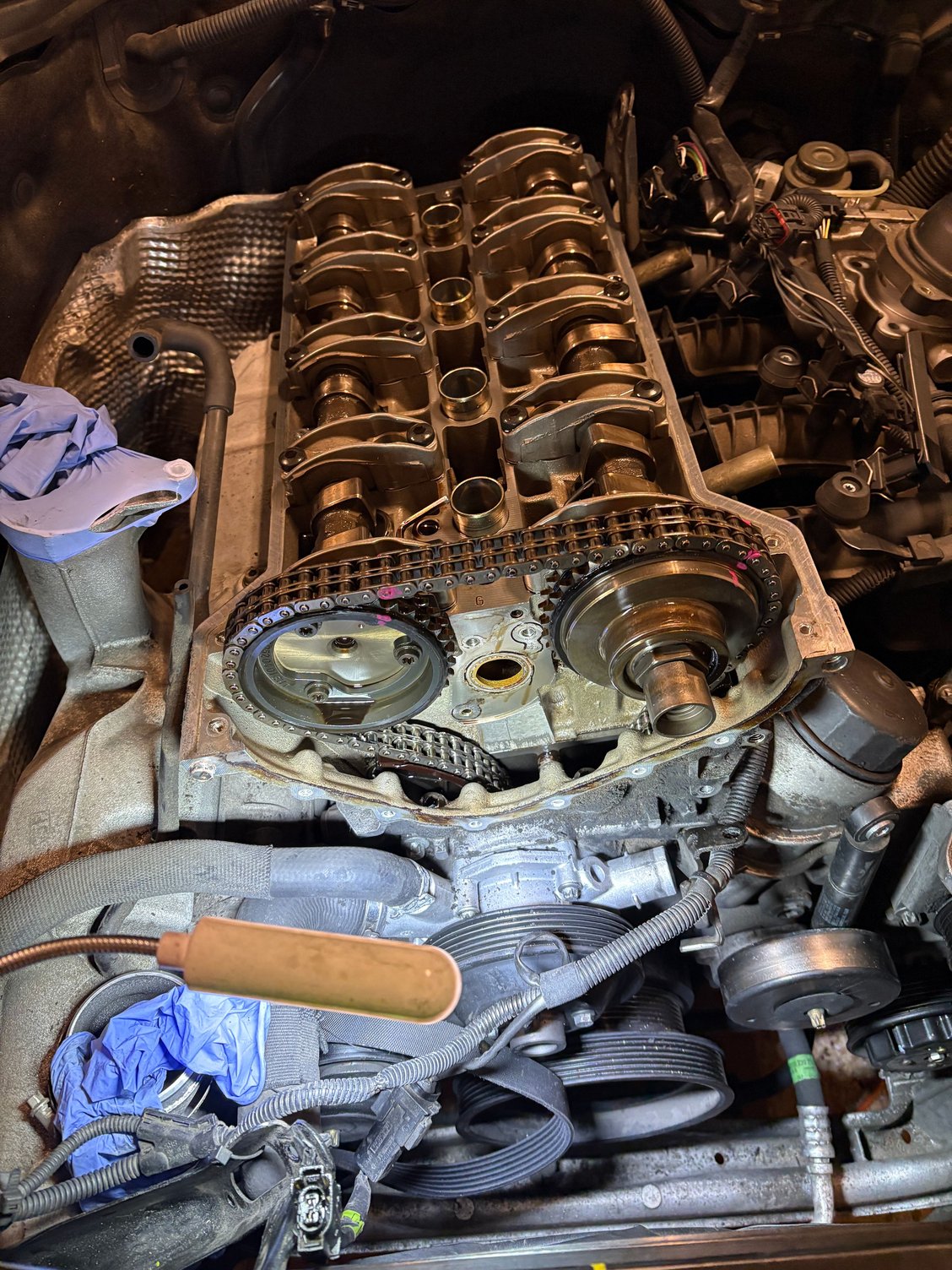

Yesterday I was able to set timing and discovered my chain had a stretch of about 2 - 3 degrees.
For 140k miles it seems to be a normal amount of stretch.
No matter, locked the cams in place and marked the chain and cams with some nail polish (stolen from my sister haha).
I removed the timing cover at the front and the top timing chain guide.
I started to take off the metal piece that goes on top of the supercharger and realized I needed an angle joint to remove a couple of bolts.
So only minimal progress made, hopefully, I can do more today.
How the M111 looks now
2-3 degress of stretch
Marked up cam
Marked up cam

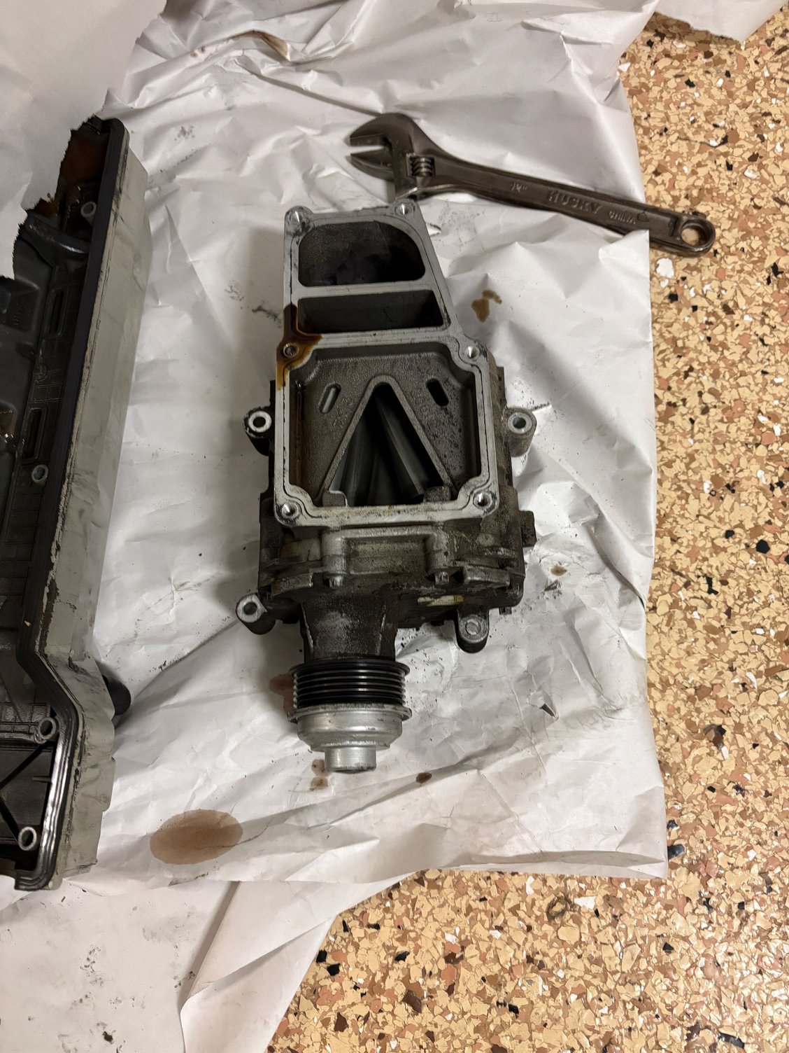

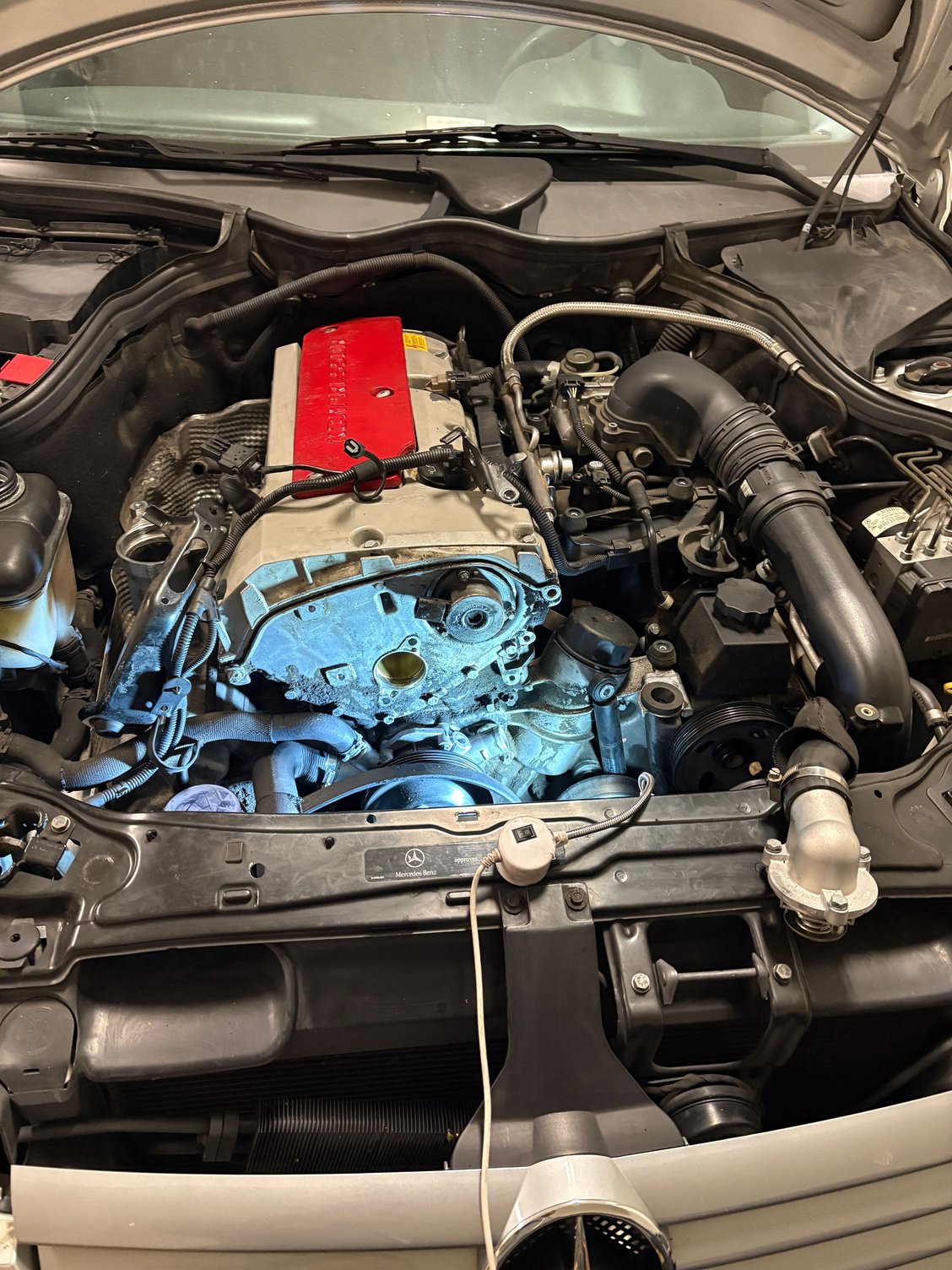

So today was a decently good day.
I was able to take off the supercharger and the big metal thing that's on it.

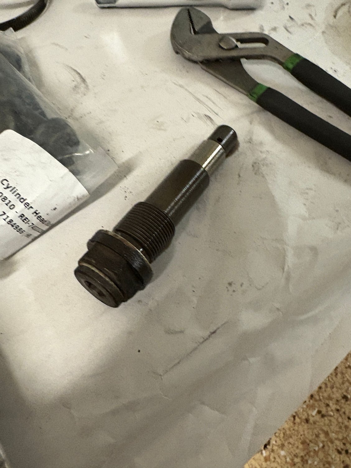

Took a good while to get the hose that attaches to the supercharger baffling (I think that's what its called?) loose.
Removed the chain tensioner, and the 3 bolts on top of the exhaust heat shield, and loosened the cam sprocket bolts.
I need to get the weird 12-point key that the head bolts use.
And the exhaust bolts are all probably super rusted so I might be screwed.
Once I remove the intake and exhaust, I should be able to yank off the head and go from there.
And as a bonus, I removed the supercharger muffler, now to get some bolts that will fill in the holes and enjoy my new noises.
Current progress
Current progress
Supercharger
Supercharger
looking empty there
looking empty there

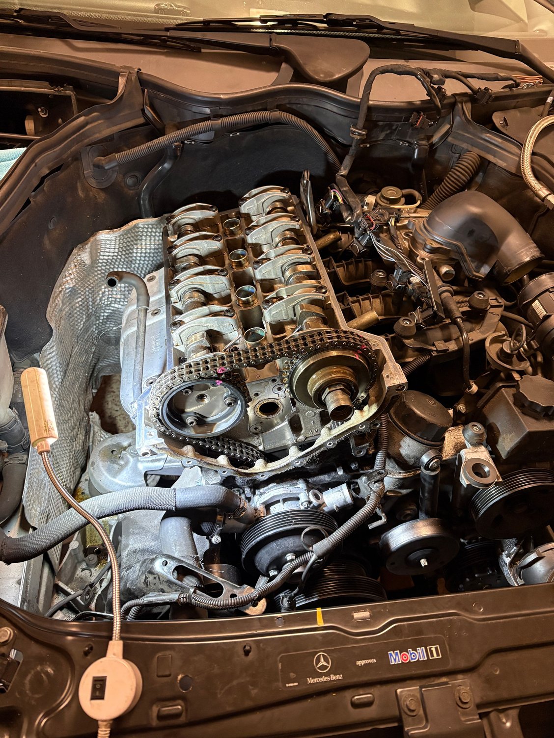

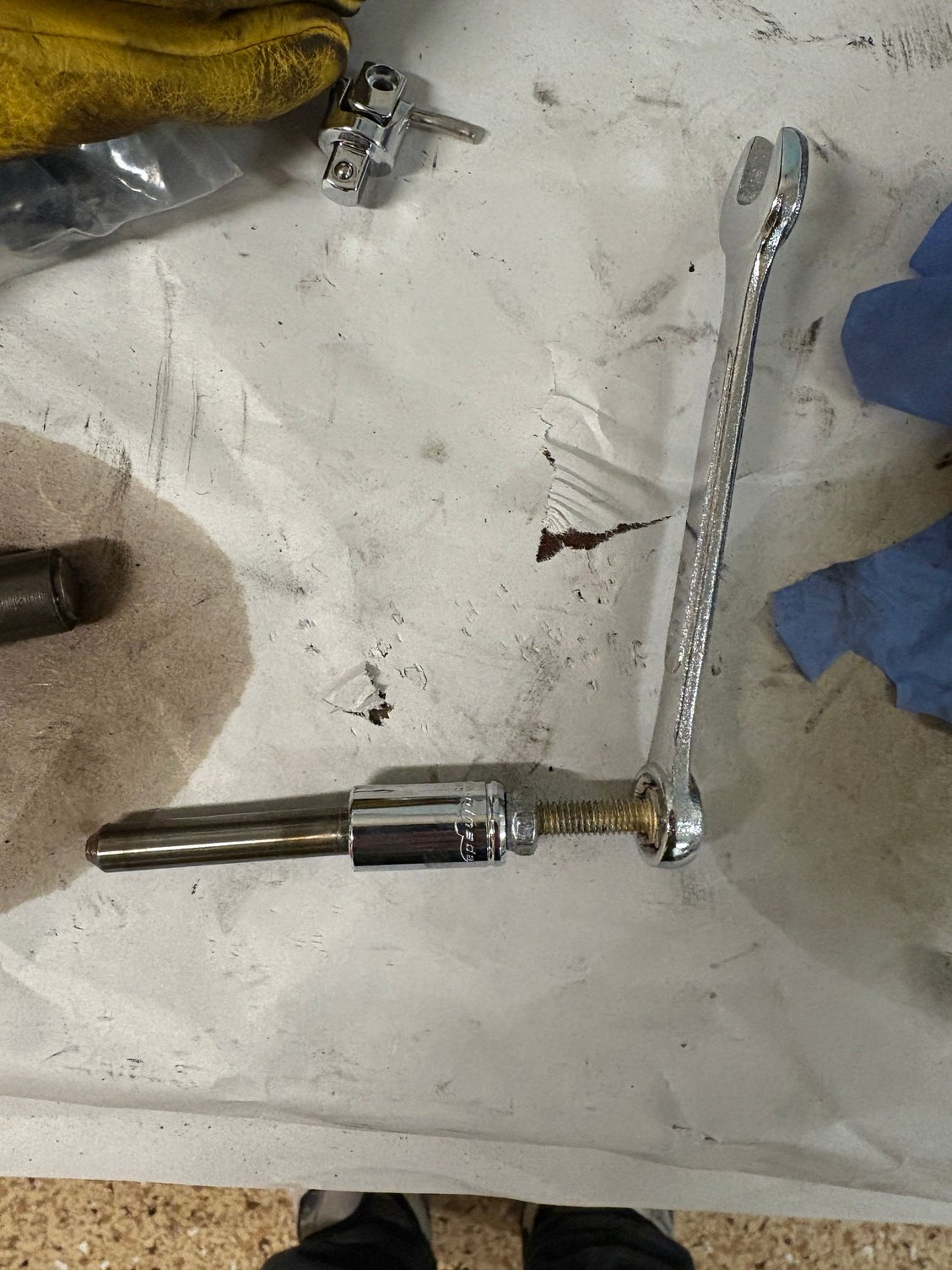

Well 5 days later, progress is still really slow.
And it worries me, as I will have to go back to university on Sunday.
Currently, I have everything off, yet the head seems attached.

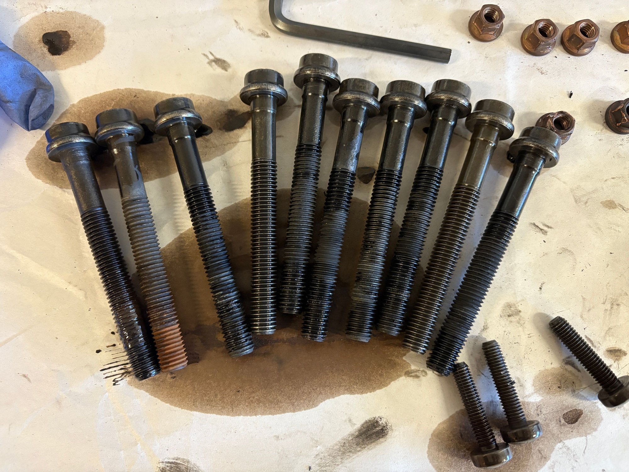

All 10 head bolts, and 4 bolts around the timing chain, the intake, and the exhaust were removed.
No matter what me and my friends tried, the head seemed to be stuck on really bad, as if there were some secret bolts somewhere.
Any help would be greatly appreciated.
The side rail dowel pin removal tool.
How the engine is currently.

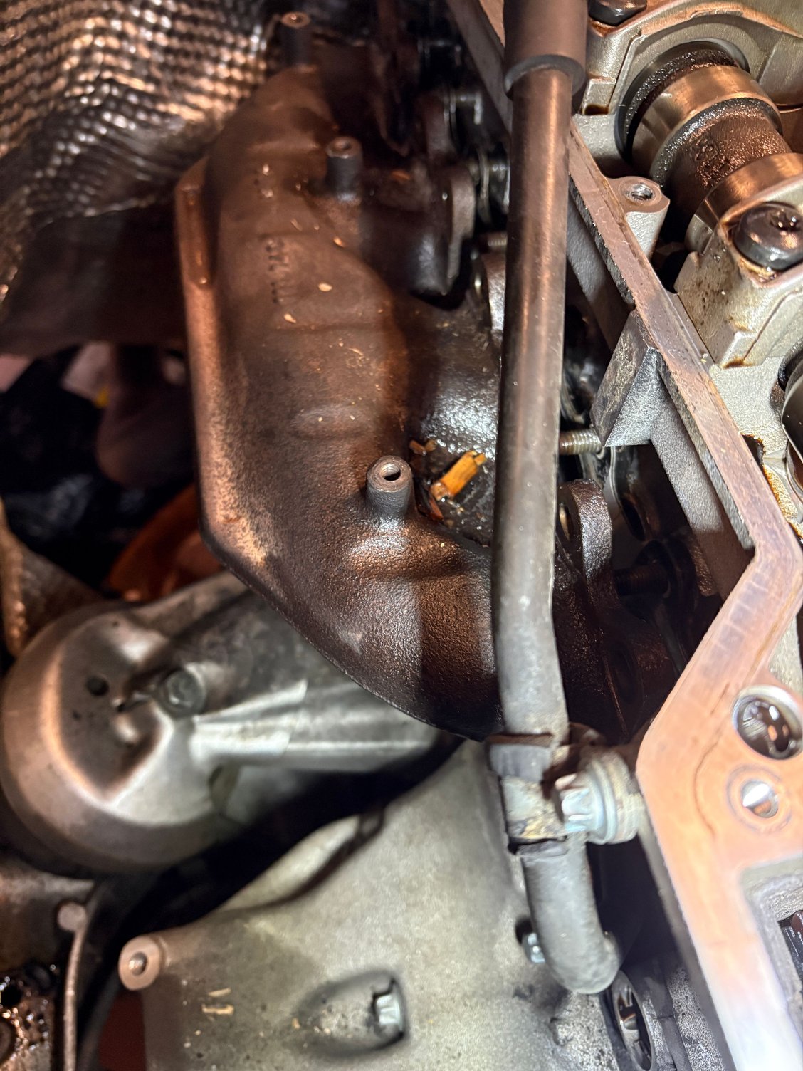

Which one of these head bolts was near the coolant leak?

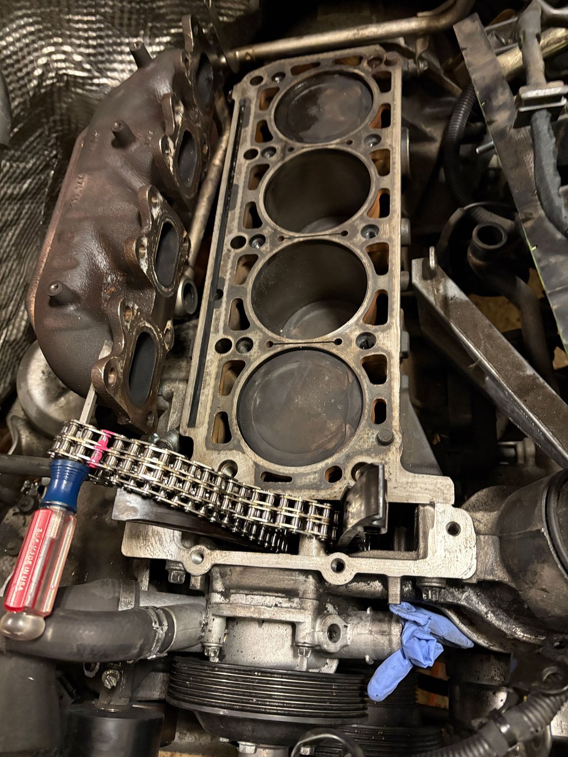

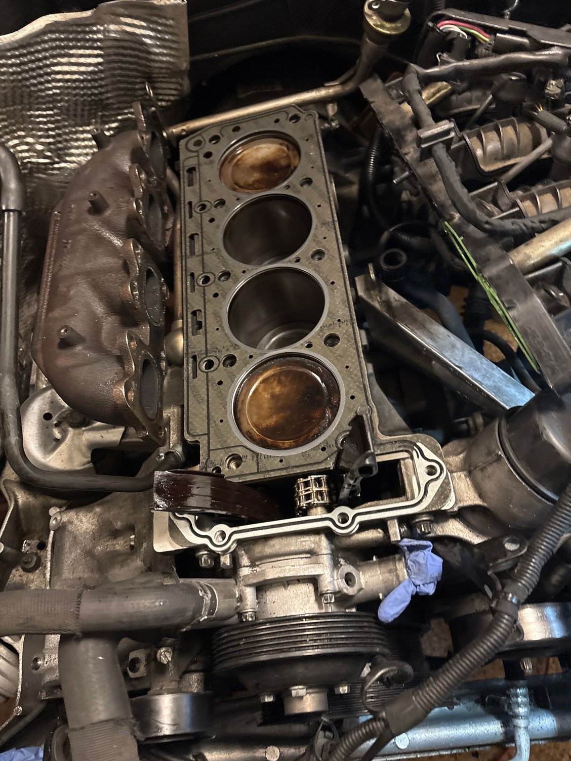

Alright!
We hit the 50% mark on work.

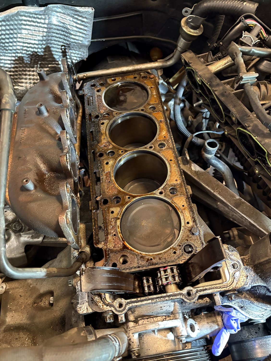

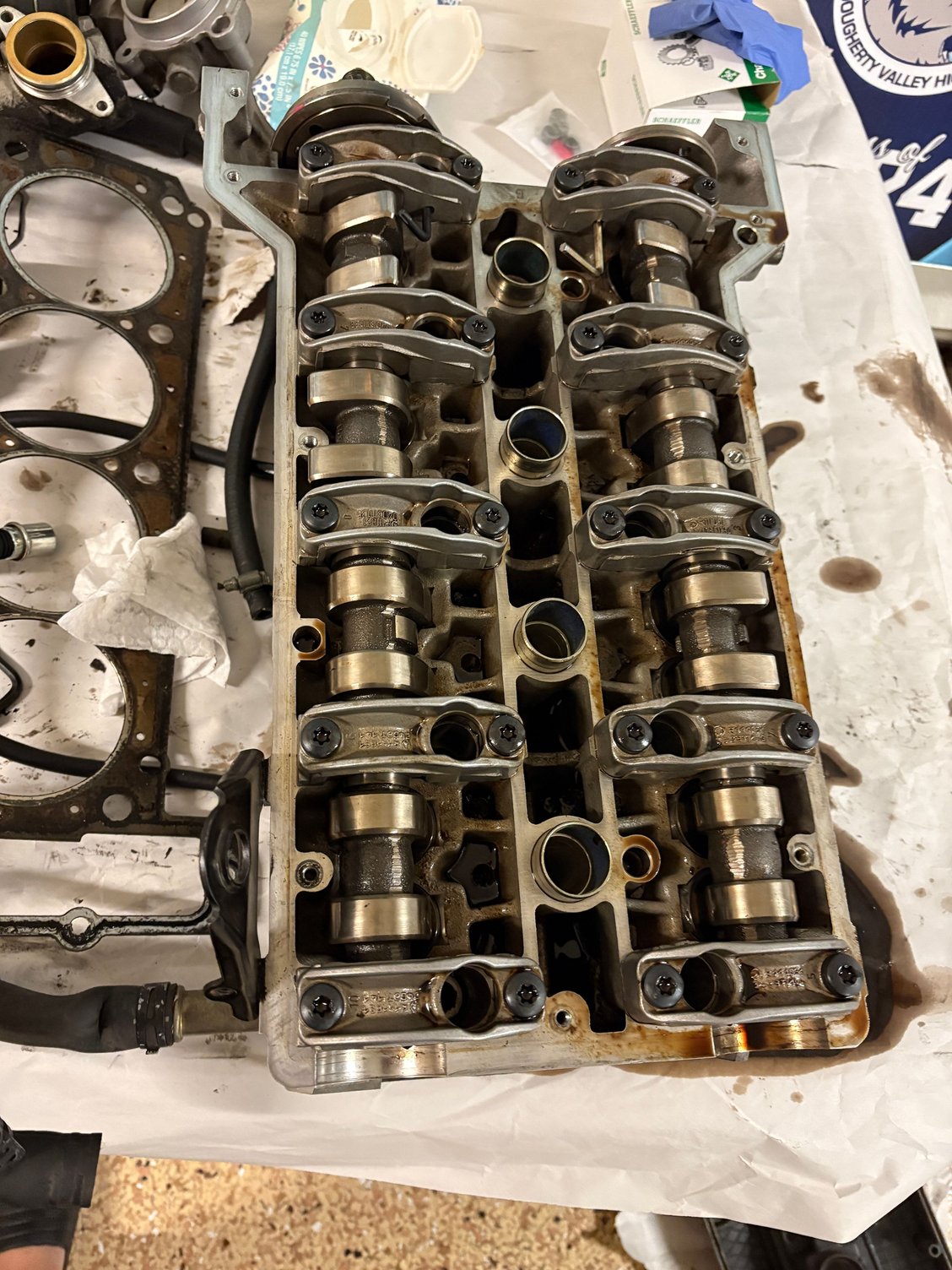

There was a bolt on the rear left of the engine and a coolant hose on the rear right holding the head down.
After we got those off, a couple of love taps with a rubber mallet and away we went.
The head gasket was a nasty mess, rusty everywhere.
With some brake clean and some scrubbing with a toothbrush, the head looks a lot better, but we still have a good way to go.
We had a casualty, when setting down the head on the table the PCV exploded.
So me and my friends set off to O'Reillys and got the parts and made one ourselves.
We may be engineering students, but this was above our pay grade lol.
Now all that is left is to finish cleaning up, replacing gaskets, and reassembly.
Easier said than done.
I can't wait to drive the coupe again!
Nasty gasket, yuck
Nasty gasket, yuck
How the head is
How the head is
Makeshift PCV
Makeshift PCV
Slightly cleaned up the head, still got a lot to do
Bonus ping pong ball

Nasty gasket, yuck
Nasty gasket, yuck
How the head is
How the head is
Makeshift PCV
Makeshift PCV

Well, I've finished as much as I could.
I stayed up with my friends till 2 am to put everything back together.
Sadly, at the last moment, I realized that the spark plug seals in the valve cover gasket set I ordered did not fit.
And since I had a flight in the afternoon, I decided to call it quits.
Everything but the front airbox, valve cover, coil packs, spark plugs, a little bit of wiring, oil, and coolant were put in the car.
The head gasket was a decently easy job, just a pain to get the head off, back in, and put the chain tensioner back in.
Everything else is just bolting stuff on and off.
I turned the engine over 2 times, did not bind.
It did make me sad to leave the coupe a little apart.
Sadly this means my next update will be in the second week of March.

So you left the cams in place?
How did it feel when you popped the head bolts?
You didn't take the head to a machine shop?
I was beginning to think your gasket must have been fine, your engine is sooo clean inside.
Mine is a bit gunked from 100K miles of driving it with the blow gasket. Some moisture has been getting in the engine.
But then I saw that bolt you mentioned. Definate water damage.
As as helping in person, might be a little hard, as I'm in Brookings OR these days.
But virtually I suppose.
Old Jan 22, 2025 | 02:23 PM
  #46
TheRotaryFox's Avatar
Joined: May 2023
Posts: 120
Likes: 10
From: Arizona State University
2002 C230K SportCoupe
Originally Posted by C230 Sport Coup
Oh man, it's like waiting for season 2 to find out if it starts.
Season 2 is accurate, and the estimated release date is March.
Yeah, I left the cams on the head.
Maybe if you have the time you could rebuild the valves, might make the engine last till 520k :P
No machine shop, no time and didn't want to spend more money than I should.
Car didn't overheat at all, and all my pushing it never got it higher than 100C.
I didn't pop the head bolts myself, they were on there super tight, so I had two of my buddies help to get them loose.
They didn't feel stuck, and came right out after you crack them loose.
I think the worst part is putting the chain tensioner back on.
As one youtube video put it, "It's a soul robbing pain in the rear."
It took us 4 hours to get it in, and that was after we had dinner and took a break.
What worked for us was to put the body of the tensioner inside the block, then put the spring, plastic piece, and the cap in after.
The way my friend put it back in was he pressed his palm against the back of it and FORCED the cap into the tensioner.
Once he pushed it in all the way (which takes so much effort, it was harder than cracking the head bolts) he used his palm to rotate the threads of the tensioner in just enough so that he could let go and we could tighten it up.
We achieved this at about midnight, and that had hyped us up enough to throw the entire motor back together until we couldn't figure out how to out the spark plug seals in.
About the head being clean, I think you said you couldn't see the images of the actual damage.
Here ya go:
Dirty Old Gasket
Dirty Old Gasket
