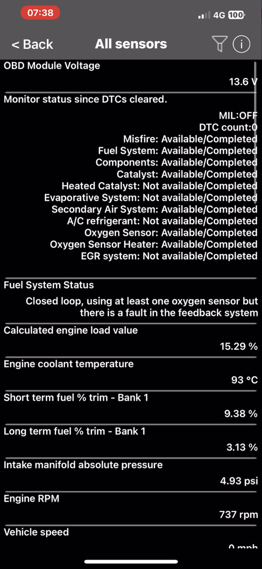

Some screenshots of live data. Negative short term fuel trim pretty much all the time. Closed loop with feedback fault??
