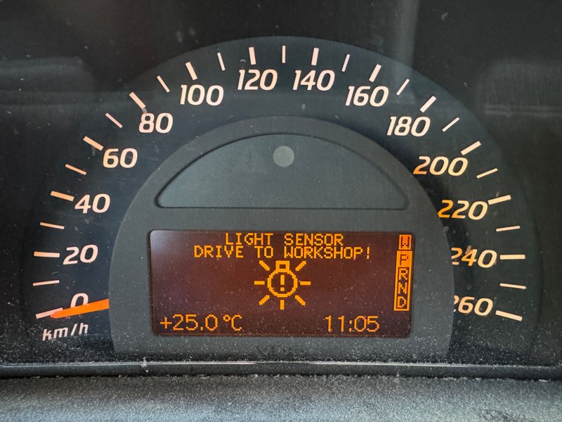

So after sending my EIS to a professional shop, apparently my stock one is kaput. Mechanical issue with the barrel mechanism. Electronics are fine. They just cloned the data into a new EIS and sent back both units.
Car starts. Both keys are recognized. Doors remote lock and unlock.
Everything works except my car now throws some light sensor error. I know this error can be caused by a bad battery or voltage regulator, but a) the battery voltage looks fine, and b) this problem wasn't there before I removed the EIS.
Light sensor - drive to workshop!
I talked to the guys who did the reprogramming and they said it's most likely an incorrectly coded/configured option, and that it should be a very easy fix for someone who knows what they're doing. Probably something as simple as unchecking a flag. Unfortunately they're not local, so I can't just get them to look at it.
Can anyone with access to Star/DAS tell me the menu path for getting to the light sensor menus, or at least point me in the right direction? Guessing that the car is expecting an input from a (non existent) 2nd light sensor. Thanks in advance.

Light sensor DRIVE TO WORKSHOP?
Like it's soooo serious. You must drive to the werkstat now!
Yeah, so they can milk you for a grand.
Does the car operate ok?
It's an anoyance to have to see that everytime, but maybe no more so than NO PHONE!
I did see some menu's in my new Lauch Elite 2.0 Merc scanner for calibrating the light sensor?
I wonder if it could be as simple as that?
BTW- what was the shop? Sounds like a good resource.

Talked to the shop and they sent a 2nd replacement under warranty. The technician double checked the programming this time, and everything works. Had to do the "hot swap" (between 1st and 2nd replacements) while in USA which was a bit of a risk in terms of getting stranded, but the 2nd replacement worked right out of the box. They also included a shipping label so I could mail the 1st replacement back.
All is well. Back on the road.
