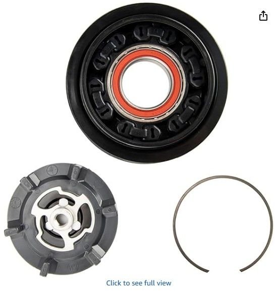

Removed the belt and noise is not there. The compressor pulley wheel is toast. I found the cover plate fallen off, on the cross member. I just ordered a replacement pulley clutch kit
here here
. I need to figure out how to replace it when it comes in. If anyone has a video link on how to do this please share it.
Also is this bolted to the compressor because I don't see a bolt on my car, tho' pulley is there only the cover plate was off, and I don't see any bolt that comes in this kit. What bolt size holds this kit?
