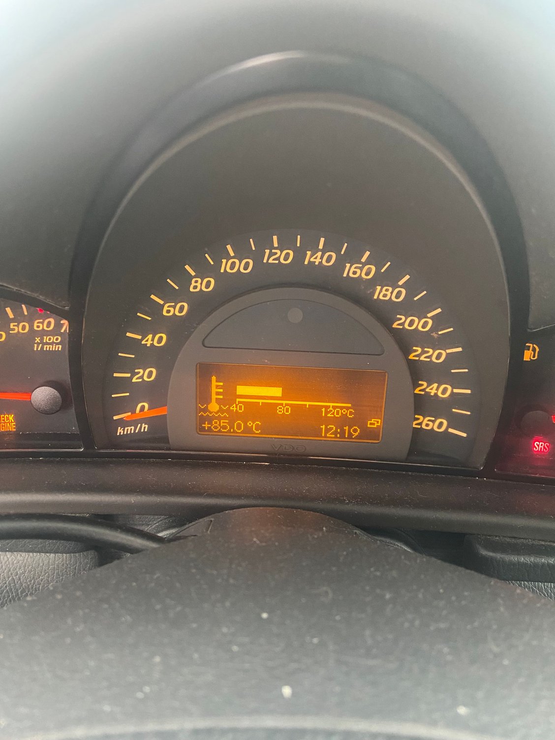

I suspected it to be the car engine temperature sensor, but the sensor is funcional, although, i find it weird that the instruments displays a constant “+85C” but when i navigate with the arrows, and put the temps, the readings are correct. (Refer to pictures provided).

Have you measured the current? It must be 20 mA after around 30 minutes of not touching the car.
+85 °C is the ambient sensor located in the front bumper on the right side, obviously wrong.
Thanks, now i know where that temperature reading comes from.
