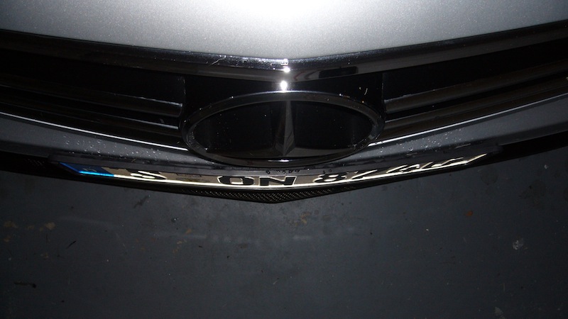

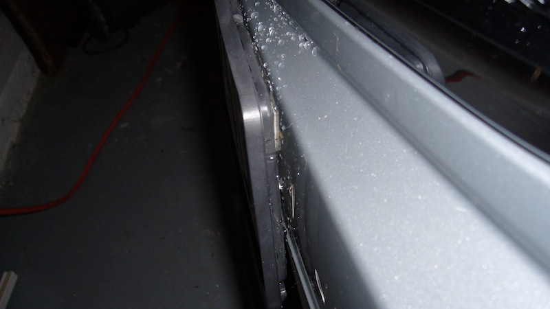

I mounted mine using the 3m gray trim tape (same as used on spoilers and lips).

can u take a close up of the way u mounted it how did u manage to curve it did u use a plate holder

I bent the plate buy placing it in the bracket. I measured to center and marked it with tape. The I heated the back of the bracket with a heat gun or hair drier and gently pressed down on the corner of my work bench. I had my previous plate on for almost 2 years. This one has been on for about 3 months.
Attached Thumbnails European License Plate Holder-p1020084.jpg   European License Plate Holder-p1020085.jpg   European License Plate Holder-p1020086.jpg

looks great

Maybe it's me, but 3M trim tape seems to start crapping out after half a year. My roof and trunk spoiler are both held by 3M tape and the corners have been peeling like crazy.
