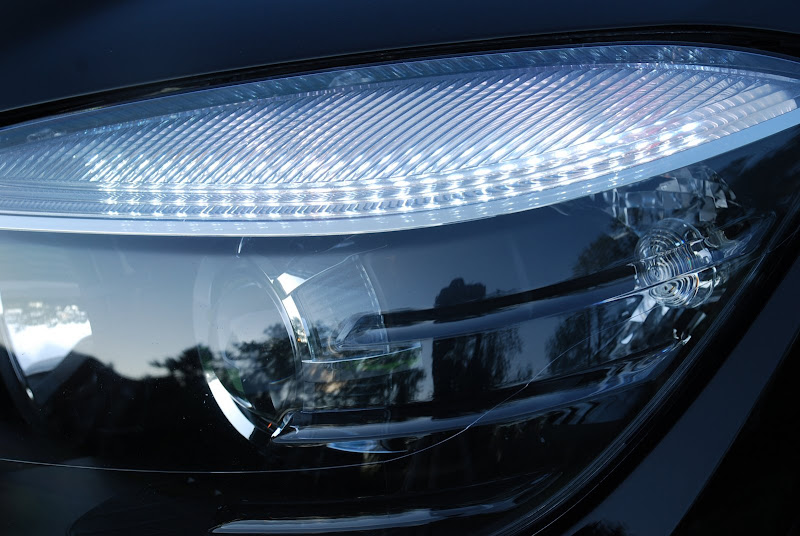

I see some people with them and some without...
is this car modded with the european/ no amber headlamps?
https://mbworld.org/forums/c-class-w...-nice-day.html
can you order them with your car? (the european ones)
Old Jun 23, 2009 | 06:04 PM
Ron Jr's Avatar
Joined: May 2008
Posts: 2,824
From: Long Island, New York
2013 C300 Sport Black Darth V3.0
He just replaced the amber bulb with stealth ones. Most modders here have done it to get rid of the scrambled egg look.
