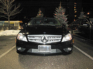

How do I know if mine is a sport or luxury? It's a C300 4Matic. I'm attaching a pic if it will help.
Thanks.

You have a sport, so you're gonna need H7. You're close by? is that a YRT bus in the background? To be safe, check your steering wheel. Is the steering wheel a "T" or does it have 4 spoke?.. the T would mean you have a sport model.. but looking at the picture you have a sport model.

Its a sport. H7 bulbs..

and you have a P2 package...

I have a T steering wheel, so I guess I have Sport. Yup, that's a YRT bus. This pic was taken at the dealership when I picked up my car.
