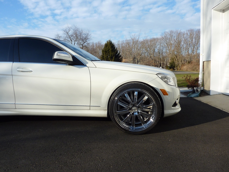

I have a set of 19" TSW Estoril from my old car.
Lug pattern is 5/112
tires are 225/35/19
I'm pretty sure the wheels are 19x8.5 with a 45mm offset. Will they work, won't they work?? Does it matter if all four are the same width?
All anwers welcome. Thanks
I pulled a wheel out of the garage and put it next to the car, (pic below) i dont' want to lower the car and it looks like the wheel sits a bit higher, but not by much.

from the numbers it seems ok. and should be ok for same width.

you should be fine..

Wheels should be fine. Tires must be front 235/35/19 and rear 255/30/19.

they will fit but are you SURE you want them on there?

hahaha. Most likely no, but just wanted to know i had the option come summer. Actually i really dont' want to ruin the integrity of the ride so i'll probably sell them.

Well, since your curious to see if they will fit, try putting on one. Just jack up your car, and mount it. You will then know if your have fitment issues or not. The size seems right, but it's a offset issue. If the wheels stick out of the fenders or not. But try it out and see.

The centerbores are different. MB is 66.5 and VW is around 55 (I think). If the wheels are not hubcentric and will accomodate the larger MB centerbore, you should be fine with rings.
