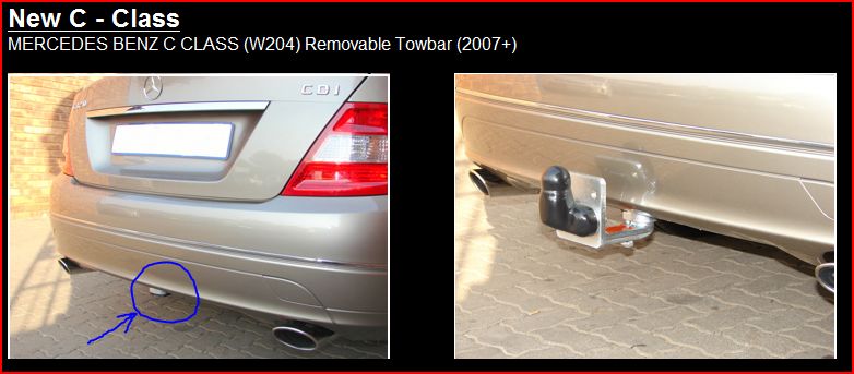

This is an aftermarket tow bar from Star Trek Tow Bars in South Africa ( http://www.startrektowbars.co.za/Bef..._Mercedes.html )
But the tow bar bracket is visible below the rear bumper. How would this compare to the OEM "Removable" tow bar?

startrek also does fitment for the merc dealers as well so looks as good buy but expensive R6000 incl fitment (dealers probably charge R10K for same thing)!

That is a very neatly fitted towbar compared with the Australian MB on offer.I would go for it.
I have attached a photo of the German Swinging Arm model .
The Australian model has a plastic cover fitted over the mounting when not in use which is not nearly as neat as yours.
I had a leak in my boot caused by the fitting of the towbar. The water ran along the bar under the rear bumper & into the channelled subframe making its way to the boot. A simple plastic cover over the entry point solved the problem. Have the installer wash the car then inspect the boot before accepting it back

Yea, I noticed the tow bar from the "Lemon" thread while searching. Quite a large contraption...lol. Then I do agree with you, even the StarTrek option is neat! Never thought of water problem in the boot after fitting a tow bar. Sure to inspect mine afterwards, thanks.
