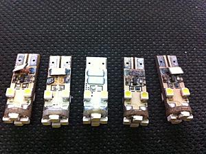

A little review of the LEDs after 1 YEAR of USAGE
1. Out of the 4, 2 turned blue, 1 went dead, one survived in battered condition
2. The LEDs' temperature is probably too high and it cooked the skin of the wires into crispy condition, upon fiddling with them while changing I cracked ALL wires open and left the copper inside exposed, now I am finger crossed that no water can get inside the area so I dont extend the damage.
I have ordered a new set and Mike is nice enough to warranty me a new LED
Below are the pics of comparison from new to a 1 year old LED
I would definitely recommend to change them more often as they seem to not able to last very that long, but of course if the LEDs themselves can improve on the head resistance it will definitely be better.
Another recommendation is maybe if we can reduce the SMDs into like 4 to reduce the heat and prolong the life of the circuit board and the wirings.
I don't think I have installed the LEDs wrongly as I was among the first to discover that the resistor touching the connector causing the superheat problem so I took precaution while installing the LEDs

cant find the one that burned, i think i threw it away
those are the rest, doesnt look like they gonna hold much longer haha
regardless, i love those and even it doesnt hold much its worth it

Some normal burn off marks. Big thing to look for is component shifting which suggest compromised solder from excessive heat. That one on the far right looks ok, but the other two looks like the resistor shifted a little. Also I see some signs of corrosion which means condensation is getting in.
PM me your full name and address and the color and I'll shoot you warranty pieces then
