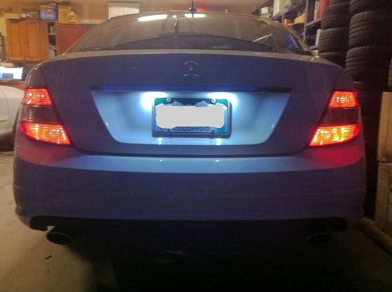

Installed my plate lights . Love it thanks Michael!

How did you get the LEDs to fit? They are too long for my 2011 c300.
I had no problem getting the LEDs to fit there. Just plug and play. I have an '09 and I'm pretty sure there isn't a difference from the '11.
Did you plug the LED in far enough?
