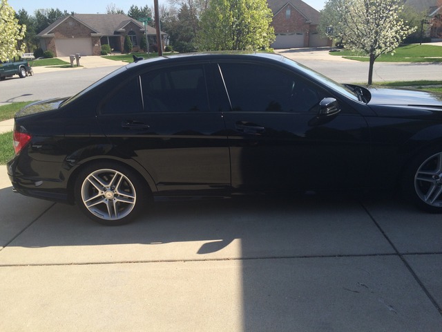

it will look like this and it wont rub with 4 passengers and lowering.
Reply 0
May 3, 2015 | 12:19 PM
  #1429
Quote: it will look like this and it wont rub with 4 passengers and lowering.
That car is the exact look I want. I think I found the post of the specs and I have been going off that. I don't plan on lowering or changing the coils which seams like most people do. Is the ride going to be that much different with 19's?

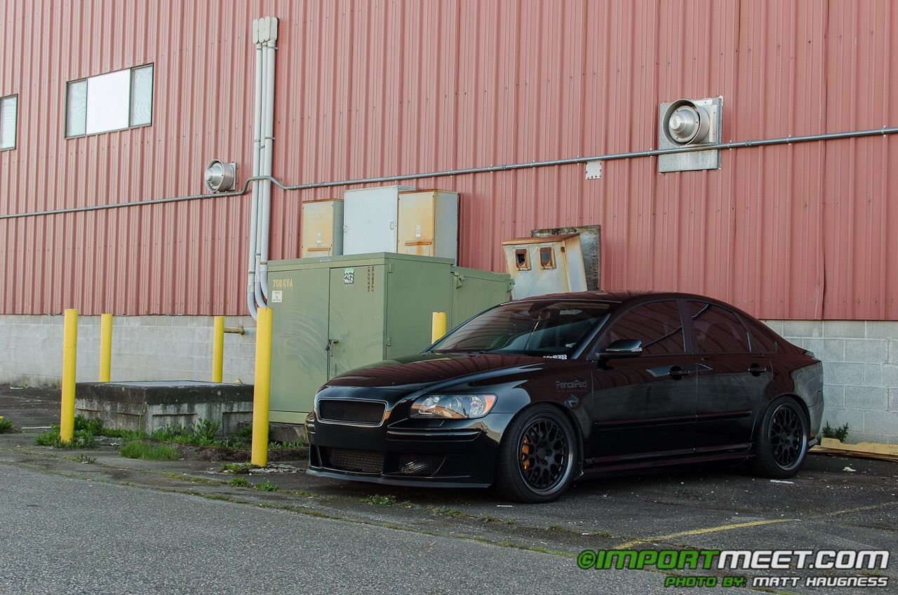

May 5, 2015 | 06:38 PM
  #1438
H&R aren't really meant to go low. The struts are revalved bilsteins essentially which also aren't known for going low. Something without an adjustable shock body in general will be limited. Being at the bottom of the adjustment isn't ideal either. I ran my H&R's on our Volvo with no rear spring perch lol, they blew after 5 years :P

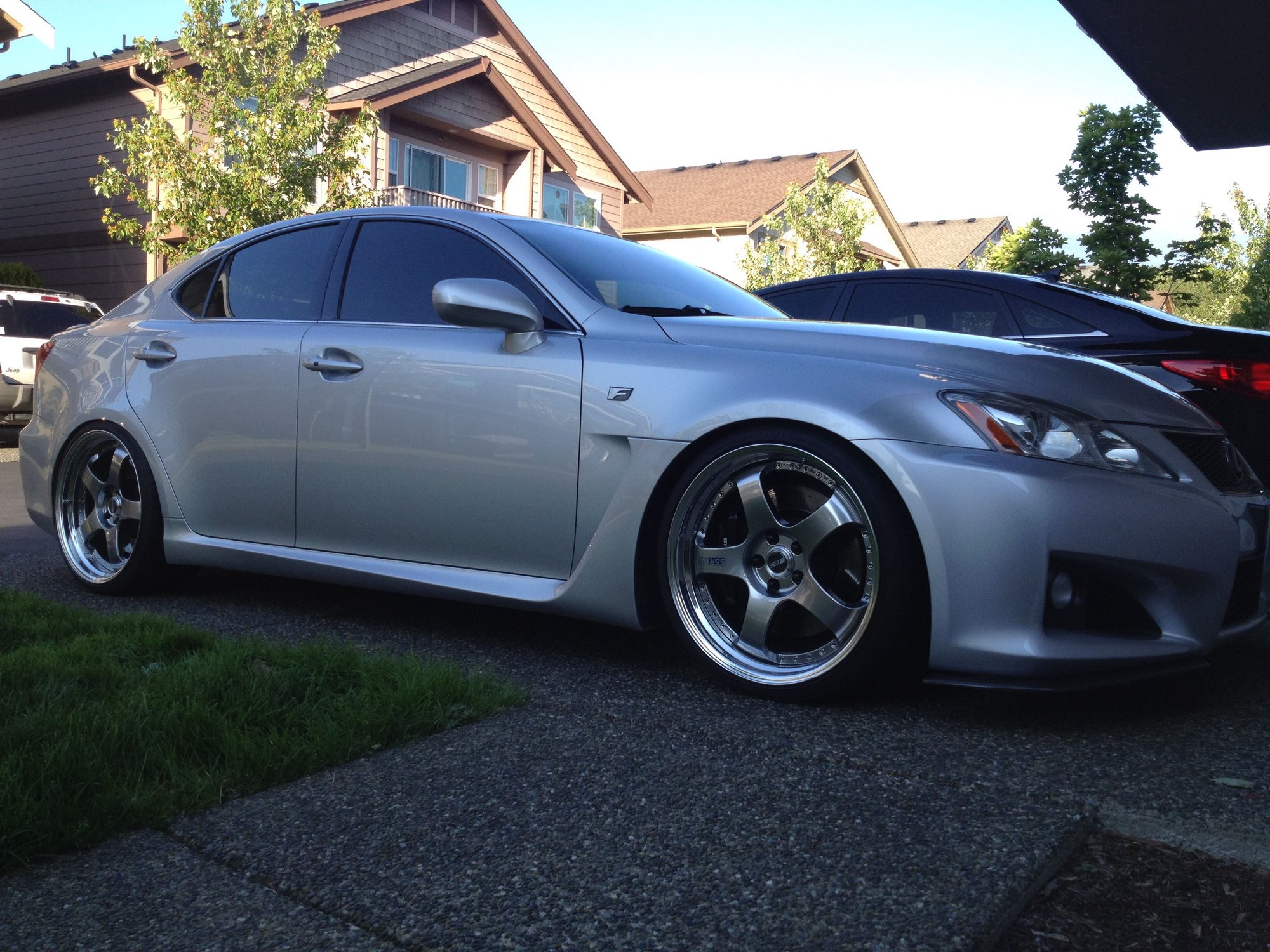

  #1440
Yeah KW definitely aren't known for going low either. But they ride so nice. This is lowered on KW V3 and was pretty much slammed so I assume it's based on application.
Reply 0
May 5, 2015 | 08:46 PM
  #1441
Yeah that looks like a good lower ride height. Mines close to where I want it to be.
