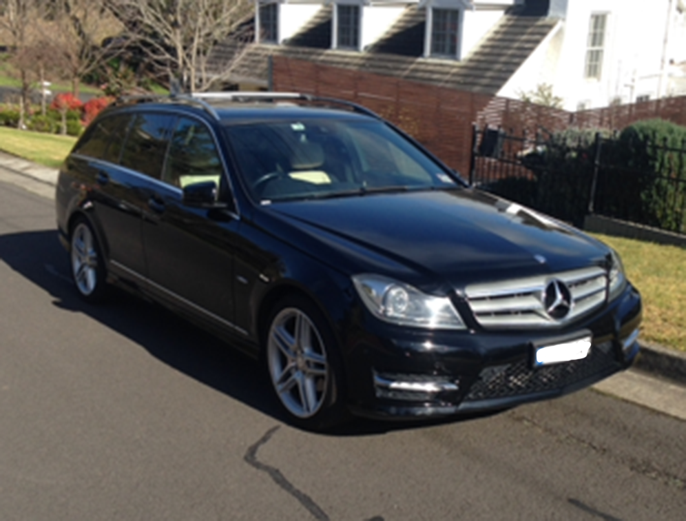

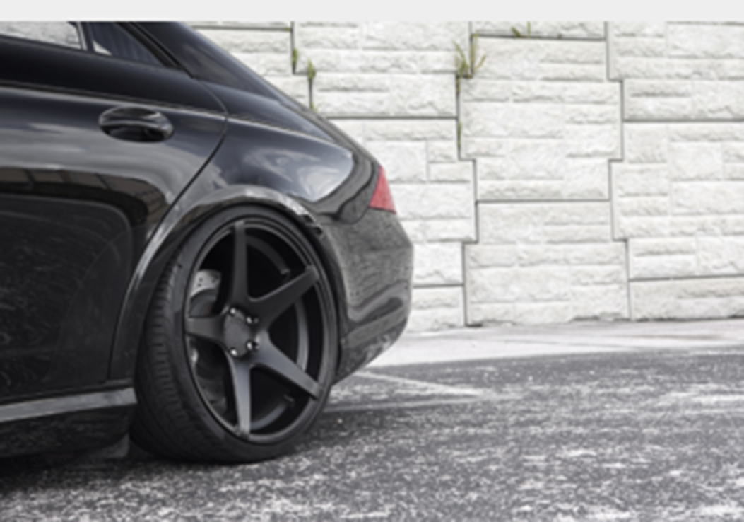

Old Aug 4, 2015 | 11:42 PM
  #1484
andreb's Avatar
Joined: Jul 2015
Posts: 23
my11 c250 cdi avantgarde
just picked up this bad boy, looking at putting rims..
current has the stock sports suspension and 18" amg wheels setup. 255 rears and 225 fronts, i would like to keep the staggered fit.
im interested in setting it up on 20s or 19s, trying to figure out the best option as i want it looking tough, and 20s are tough. especially concave or dished. or the 19s options is the mesh style amgs from c63 my15'
i do need to drive it daily, so im happy to bump out the inside of the gards or negative camber a little so its still suitable. in this case it sounds like 19s as bigger tread means more kms.
i am looking at dropping it a little bit on some kind of concave wheel, see attached image below:
any recommendations on setups with offset info would be greatly appreciated as i still want my rims to fit in nicely and not stick out.
thanks in advance..new mb owner.
