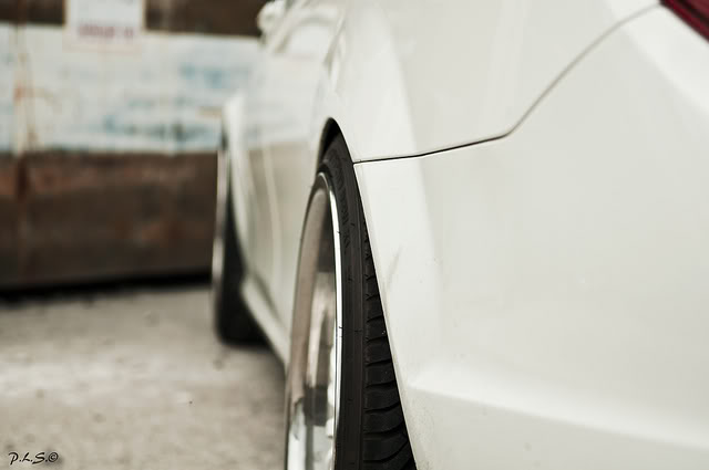

What do you guys think about a 19x9.5 rear wheel with a +35 ET? Think it would look good or not?
Old Jul 12, 2011 | 07:45 PM
  #196
itsLoonie's Avatar
Joined: Nov 2008
Posts: 730
From: CALIFORNIA
2012 E350 RWD
9.5 +35 ET 235/35/19 in the rear. I think it looks good
