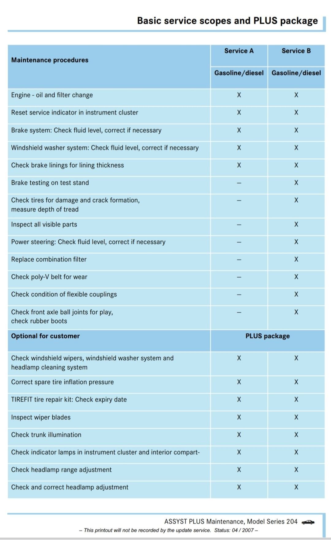

Since I can find no decent explanation about A/B service (i.e. not in my Owner's Manual), I go by what service MB says is required based on mileage in the guide.

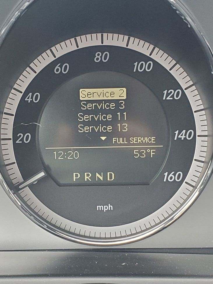

I just look in the Maintenance manual that came together with the Operators Manual in the glove box. Go down the list and make sure everything is up to date according to year and mileage.

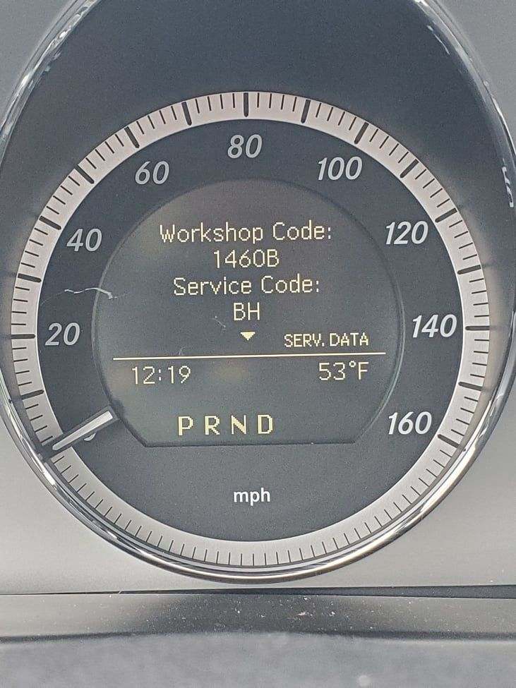

Then I also look at what the car is saying it needs done. This is done by looking at the Assyst Plus Workshop Menu on the dash.
My last service said BH as an example below. It consisted of service 2, 3, 11 and 13. That meant service B, oil change (obviously), fuel filter and coolant. These services were in line with what my maintenance manual was showing since the car had recently hit 150,000 miles.
