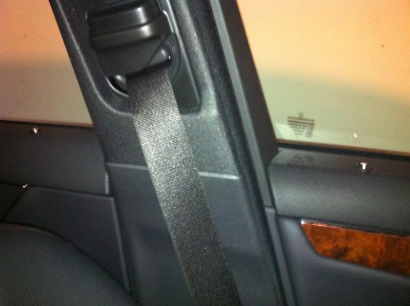

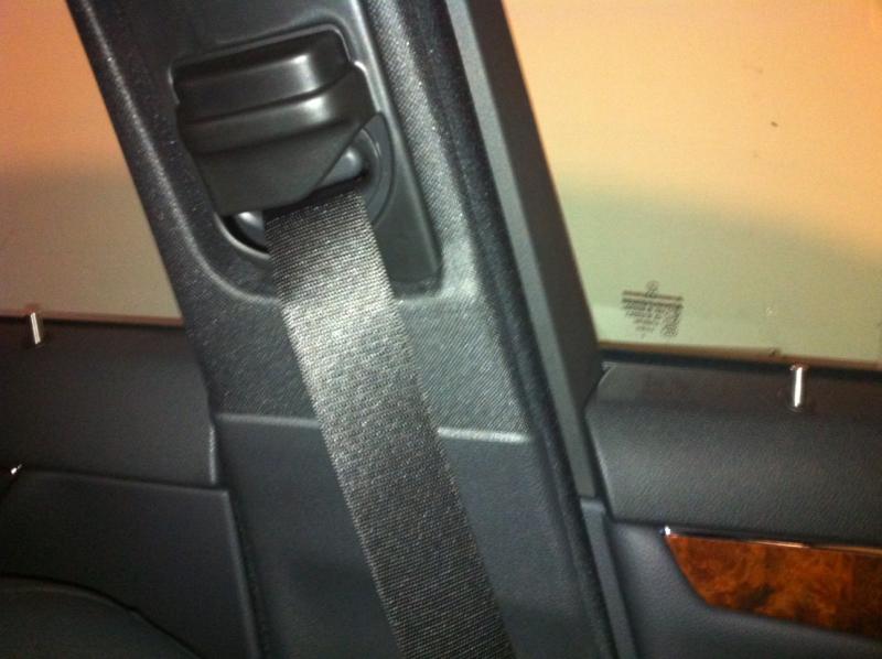

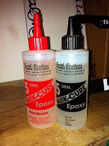

When I installed my OEM AMG pins the rears would not stay put. I used some 5-minute epoxy in the pin shaft receptacle to glue them on.

One nice thing about the glue method I used is you can get all the pins to be perfectly even... Mine front and back are in the same position locked/unlocked.

Here are pics! Crappy but better than nothin'! That's the driver side and the passenger side looks identical.

Nah that's jenky man! Get all 4 - my car is 2 weeks old, so you can imagine my apprehension in breaking anything. Using posts I found the rears are very, very simple:
1. Grab with Pliers and yank STRAIGHT UP ... not too fast. They will pop right off.
2. Take your rear-door pin and line the shaft with some epoxy, just enough to fully cover the inside of the shaft receptacle (no drips, just enough). Now drop the pin on the shaft, turn the logo how you like it and wait an hour.
3. Enjoy the look! I have no intention of EVER going back to stock pins.
Seems daunting, but really a piece of cake. Also some have reported that they slip on and stay on, so you may be a lucky one! Mine - not so much.

Your welcome. I epoxied my rears (they wouldn't stay)... My first mod... stay classy!
Result is attached below (and above actually too).
