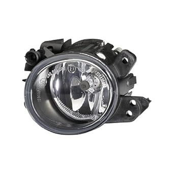

Just to give you an update. The plastic cheap ones ~$30 do not work on the sport models. You need the glass round ones that have a meta surround plate and are about ~$60.
I first ordered the top one and there was no way they would fit on my car. So I returned them and got the second one and they fit perfect. Driver's side is a ***** to do though. There's 0 room to work because of the washer fluid tank being right up there.
Here's a pic:
This does NOT work on sport bumpers even though amazon says it does:
This one DOES fit, even though it might say it does not:
Here's a pic:
The top is the lux one. The bottom is the sport one.
That's what I've gathered.
Correct (from someone who changed their Luxury bumper to a Sport bumper).
