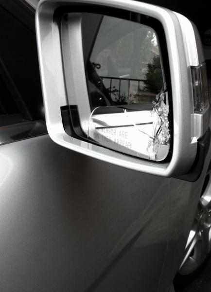

Hey gang, whacked my mirror into the garage the other day and the housing luckily stayed in tact, the reflective mirror part however had a different fate lol! Anyone know where to buy the reflective mirror part and If it can be installed yourself without having to go to the dealer?

I don't have the specific links in front of me, but I had been browsing the British Ebay site, and saw several for sale, including heated and with the small angled part of the mirror toward the outside edge...didn't see any details on tinting or self-dimming. May be worth a look at

I broke mine once too. Bought it from parts.com
Take a flat head screwdriver and pop the mirror out. There's 1 or 2 wires attached to the mirror used for heating. You'll see how the whole mirror is attached when you see the new piece. It took me less than 5 minutes to swap it.

You are lucky it's the right side which is heated but not self dimming. You don't reveal what year your car is and your info says SL500.
If it is the newer mirror size, the glass is the same as the GLK.
The glass pops out of the base but you need to know how to do it. BTDT.

is this what you bought?
Collision Catalog - 2010 - Mercedes-Benz - C Class
Front door, Outside mirrors, Mirror glass, W/o auto dim, , W/o auto dim Right
http://www.parts.com/oemcatalog/inde...odel=C%20Class

Yes, it is
