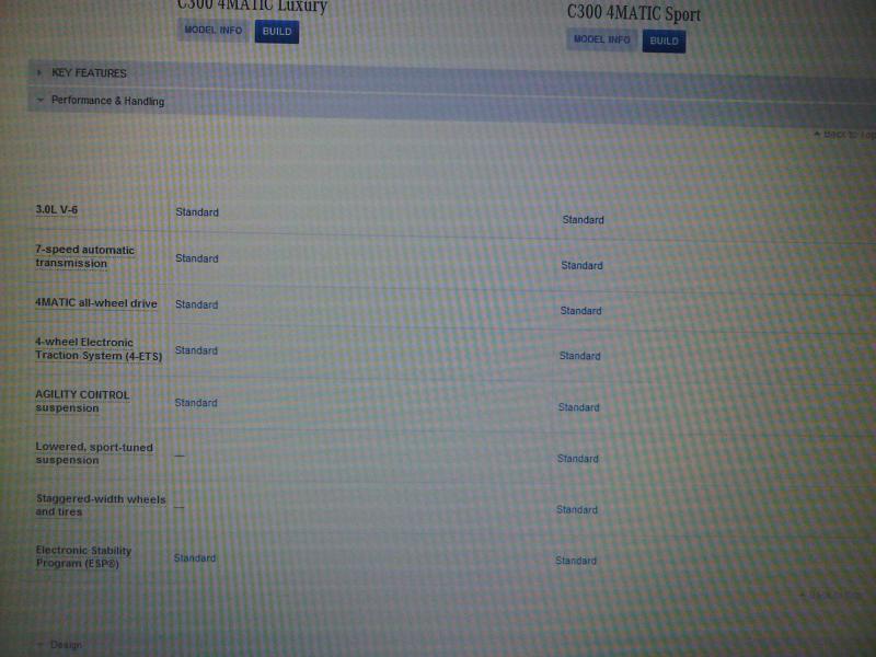

It's on the web site for the 2012 models as well as in my 2009 owner's manual, so I am making an assumption that it has been continuous in '10 and '11 as well. Get to the screen where they compare the Sport and Luxury models and it shows up in two places, although you have to hover your mouse over one descriptor to see wheel detail. Here is a very literal "screen shot" with my cell phone looking at the screen of the mbusa.com 2012 C Class site. Note the wheels and tires are described as staggered and standard equipment on the C300 4MATIC Sport.

Wouldn't just reading the O.E. tire size on the sidewall should answer the question?
