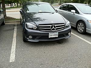

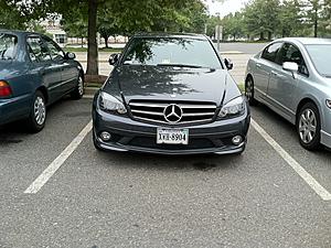

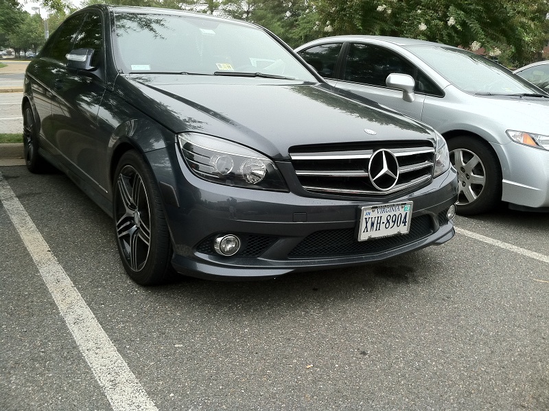

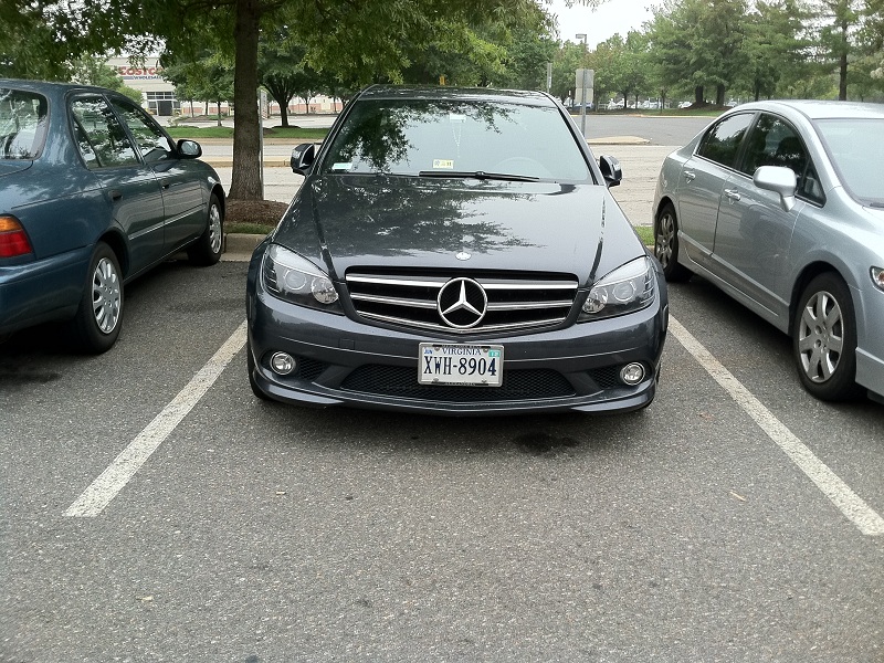

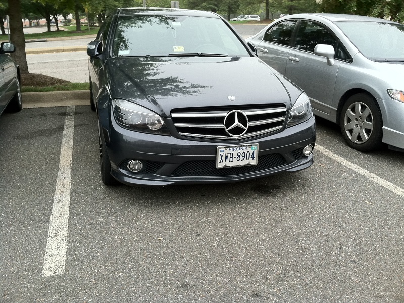

picss
i also used the blue 3m tape when i was working on my second headlamp, and it too took off some of the chrome, i think sticking it on the flat surface and then peeling it just to make it weak is a good plan and when you do put it on and remove when finished dont yank it off, try pulling it upwards so it doesnt put the chrome with it when you pull it sideways or what not..
and here are some pics of the lights, sorry if the cam quality taken from the Iphone.

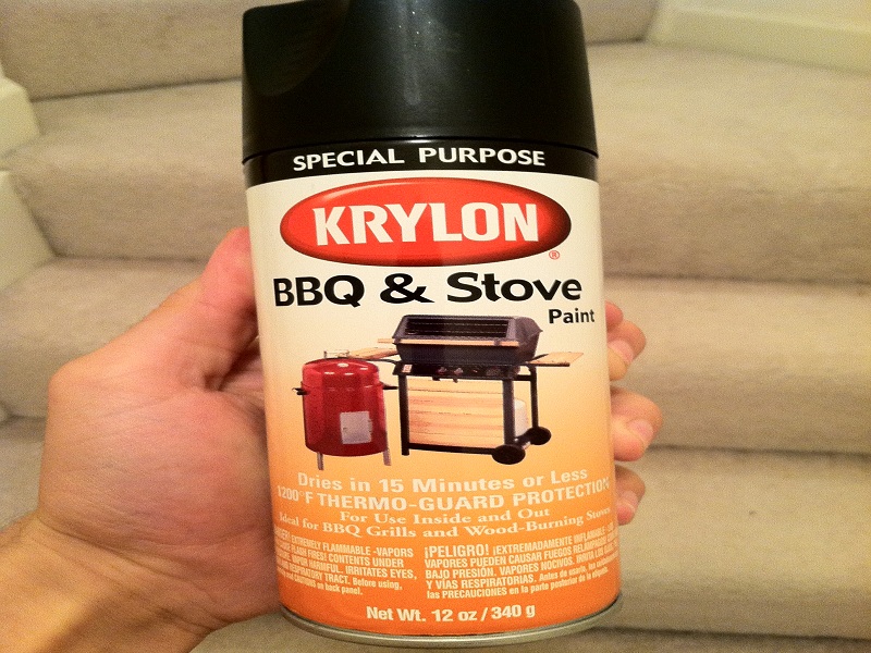

the paint that i used
i know its for bbq grills and stoves, but i used this paint because it can withstand heat. and i got the paint from walmart
