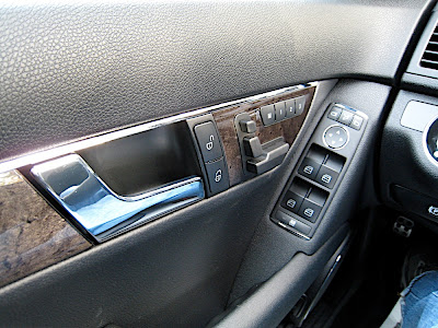

would you be able to take a pic of the controls on your wifes car. I'm curious what I am possible going to be working with.

Her car does not have the memory seats, but what I remember from seeing in other W204s, they are on the door panel as opposed to the side of the seat in the cars with the non-memory seats.

thanks for the pic...that doesn't look easy to add (or fun)
