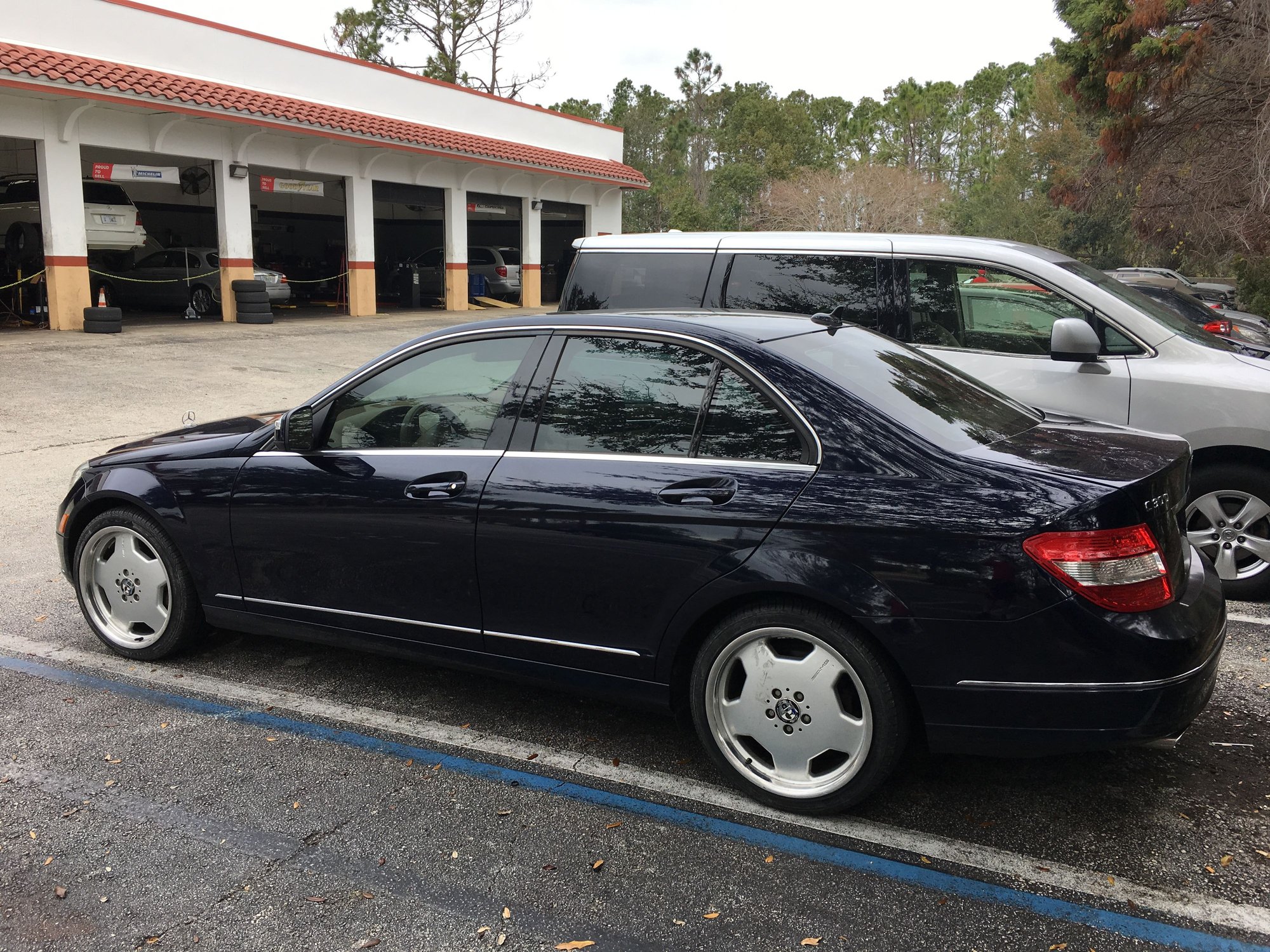

Does anyone know if the old 17"\18" AMG monoblock rims will fit a W204? I had the AMG 17" CLK wheels that looked like this on my W203 and loved the look.
Just not sure how they would look on a W204, or if they will even fit. Any thoughts? Maybe there are already some W204 out there with em?
These are 18" x 8.5" front and 18" x 9.5" rear.

Apr 5, 2012 | 08:49 PM
this is the closest i found
https://mbworld.org/forums/c-class-w...-pictures.html
Reply 0
Apr 5, 2012 | 09:40 PM
Ah, Now I see, that style of wheel does go well with the W204. Not crazy about bright color wheels but that still looks good. I would be keeping mine stock silver but the photo says a lot.
I've always liked the chunky Euro look of that era of AMG wheel. Even though they came on Mercedes from 3 gens ago they still look very modern.
Thanks for the pic!

Jan 28, 2018 | 04:11 PM
I got 18s 8.5 et47 225/40 tires on 08 4matic ...no problems at all
