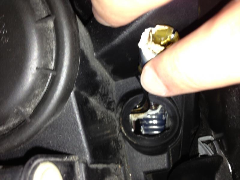

I have a similar problem. I do have the socket holder, but it is melted to the actual holder and now it became one piece that comes out entirely. *I hope this makes sense.
Did you ever get a solution? I think the name is just "front parking light bulb socket."
Here are two pictures of my left eyelids. The outer one is good, but the inner it's the one with the problem as you can see.
If anyone else know what are my options please advise
Thanks.

This is the good one.
Thanks.
Hello all,
I have a MB W204 and yesturday I replaced all (4) position bulbs(5W5 Philips Blue Vision) and...all four holder eyelids bulb was melt.
Did you found solution for this and what is a reason, and what I should do now...I wouldn't like replace front lamps.
Thanks for your help.

What exactly was melted, and were you replacing original bulbs?

The all (four) sockets for W5W bulb were melted. (yellow part was melted with a little part reflector)
Pls, see attached pics.
In the pictures are comments
(sorry for my english)
Attached Thumbnails '09 C300 eyelid light bulb holder problem-ok.jpg   '09 C300 eyelid light bulb holder problem-image.jpg

I have same issue pretty sure only way to fix it is to replace a headlight because that socket holder is park of the headlight assembly, it does not come out
