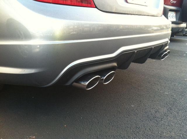

2012 C300 4Matic Sport Palladium Silver
I did mine not long ago. You really don't need the brackets; a couple of hex bolts work just as well and will save you $100. Search this forum for posts by "slo2171". Excellent fairly inexpensive mod. The 2012 diffuser is different than the previous C300/350. Also, I think the AMG diffuser only works on the C300 Sport, not Luxury.
Attached Thumbnails New Member - Questions RE: Quad Tips-left-rear.jpg

SO you need
-Hex bolts
-AMG tips.. see many sourced from Ebay
-OEM C63 diffuser or 1 like the OP posted from ebay that fits a c63/c350/c300 etc. (but make sure its made for 08-11 or 12+ cars to fit your needs).

I recommend getting the quad tips that are already welded with the Y-pipe. It took me a while to find a shop that would do the custom welding.
