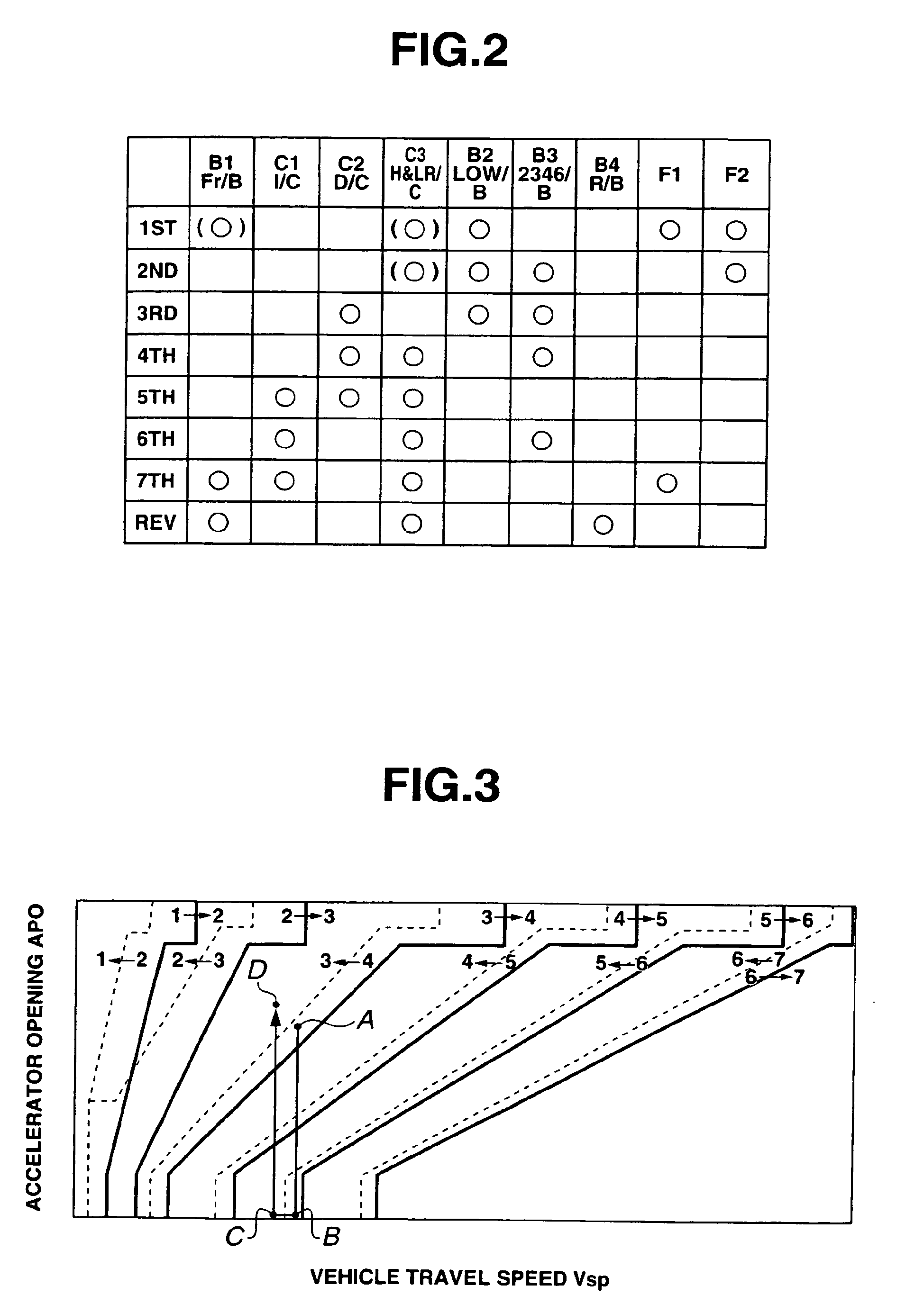

Old Apr 2, 2013 | 07:50 PM
kevink2's Avatar
Joined: Sep 2008
Posts: 1,331
From: Delaware
2004 Mazda6, 1993 RX7
Figure 3 is a general "shift map" for a modern, 7speed automatic transmission.
The solid lines are for upshifts, and the dotted line to it's left are the downshifts for the gear. What is not shown is zones where the TC is enabled, but that is about all the time with the W204.
