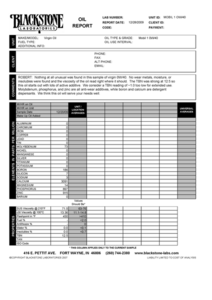

These are my last two UOAs on the wife's C300. The sample from 10/16/11 (first column) was on M1 0w-40 API SM, and after 8,800 miles it sheared more than the current sample (second column) on M1 0w-40 API SN after 11,000 miles. Not sure what ExxonMobil did, but it seems to be working...

The new formulation is somewhat obvious from change in additive element concentrations ~ some to preserve Cats. Samples look good. Shear stability certainly looks better. Pleased to see they are still using our additive company's Moly high temperature anti oxidant.
Typically with the M271 4 Cylinder engine with it's smaller sump & thus greater stress on the oil charge we would see slight oxidative thickening at 13K miles. With M112 & M272 6 cylinder engines it would typically shear & sometimes out of grade.
Here is a virgin sample of the previous M1 0W-40 Euro Formulation for comparison.

The old formulation had a starting 100C viscosity of 14.3 cSt, so this one being 13.36 is a bit on the thin side straight out of the gate, alas, these $20 oil analyses aren't always very accurate, and then there is probably batch-to-batch variation.
