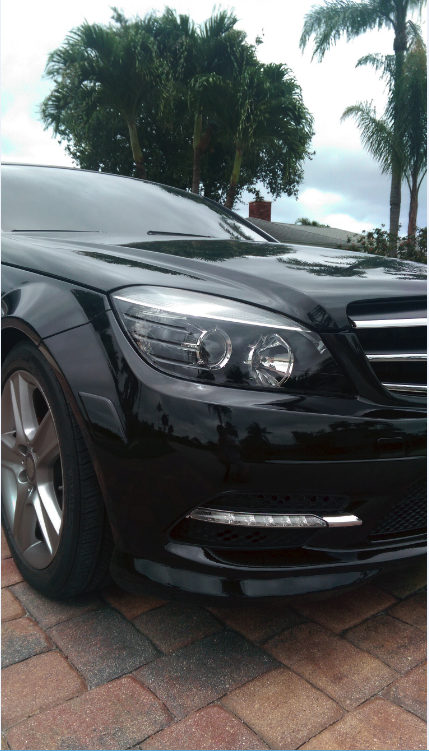

Here is a picture of mine:

@w204_generic: wow! yours look really nice. especially with the black headlight housings. im thinking about doing the black housings when i get my new wheels!
Looks good Did you black out your headlights too?
