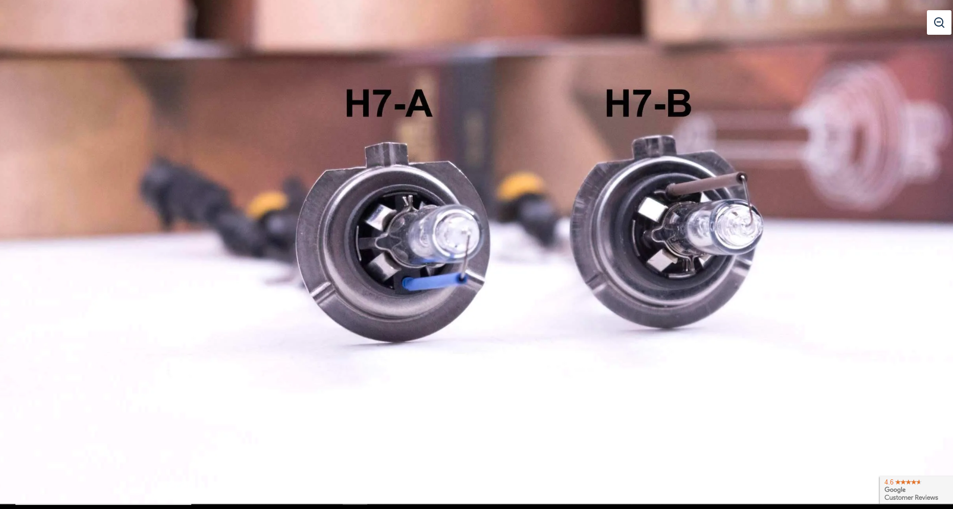

When I got my W204 I was looking at getting a Morimoto hid kit but they were alot of money and I wasnt even sure what would work in the car. I had hid kits in previous vehicles and they all needed additional replays hooked to the battery so wasnt sure what would work. Found an Innovited kit claiming it works with can-bus for not alot of money so I tried it. Must be 4yrs now and they are still working which is surprising as the ballasts are clearly getting wet. Only issue I had was after installing it there were odd shadows being cast down the road. I read this could be caused by the electrode wire on the bulb so I bought a set of Morimoto H7-B bulbs that has the electrode on the opposite side and the shadows went away. The stock halogen lights are horrible. If anything happens with the kit I would most likely buy the same.
