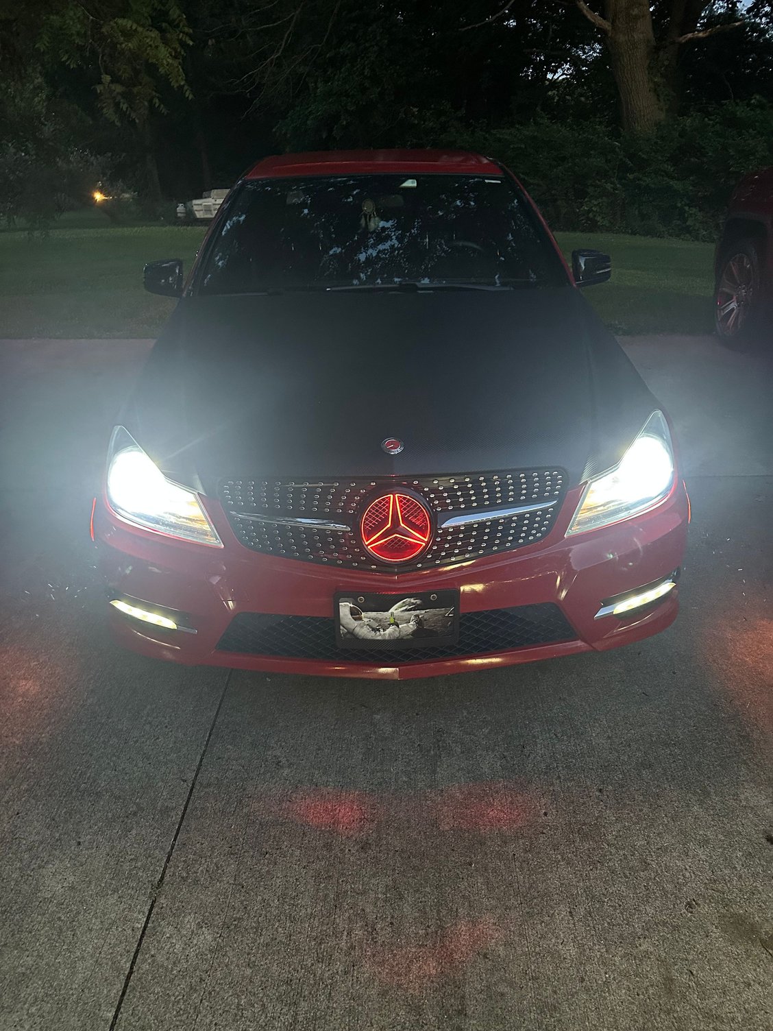

Nov 24, 2024 | 03:02 PM
Got my lighted star in red from eBay I think. I ran the power wire to the fuse box under the hood with a fuse adapter to a fuse that is hot with the car running. Works great and been going for a long time now.
