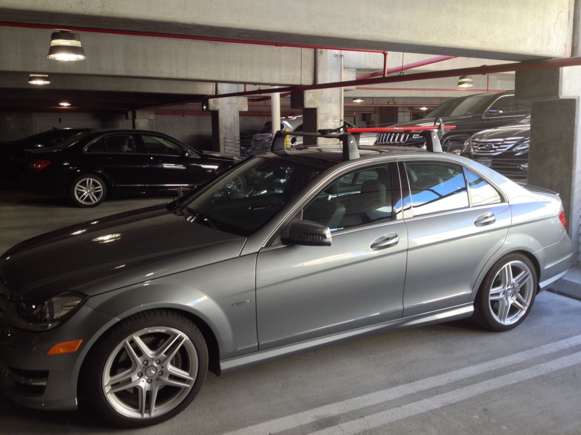

It's not the best photo, but here is the stock MB rack with one of my RockyMounts Euro PitchForks:

The solution was to order a shorter rear bar. I think that would have worked, but I did not actually go that route. I decided to return the Whispbar and get the stock MB-branded Thule system instead. I'm glad I did. The quick connect system of the MB system is magnificent. It doesn't make contact with the roof and can be connected or disconnected without tools in minutes. It does sit higher than the Whispbar, but I think it still looks great. And the benefits far outweigh the extra height compared to the Whispbar.
Thanks Daniel! Wow, it looks like the crossbars sit almost twice as high off the roof as the Whispbar.
Also it looks like the feet sit flush with the roof, but you're saying they don't touch?

It is definitely taller. If I kept the rack on my car at all times the height would bother me, but it's so easy to take on and off that I don't leave it on.
The cross bars obviously bolt into the roof mounts under the hinged covers. But the feet assembly sits about 1/16" above the body. The feet wrap around the mount covers and hover above the roof to keep everything protected from damage. It's a great system.
